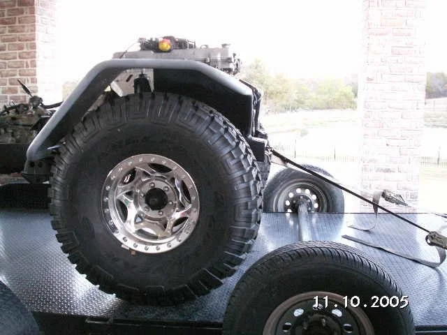

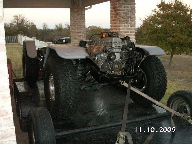

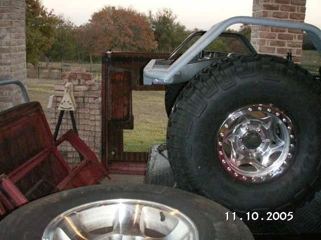

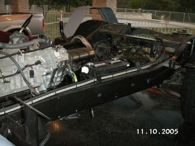

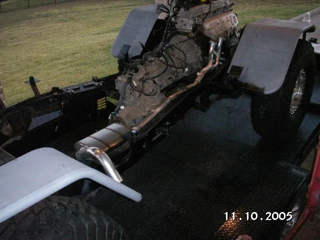

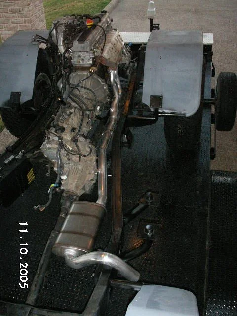

Got the bed pulled back off today. Finished the exhaust, and water tubes for the rear cooling system. Cooling tubes are being powdercoated so they don't appear in the pics. The exhaust will come back off and be Jet Hot coated when I get back from Christos this weekend. Also made all new fuel system lines including tank vent lines for emissions. Did some more welding on the cab. Man I hate welding/grinding, probably because I am not that great at it. I am really happy with the approach and departure angles though, especially when I've been wheeling nothing but SOA 60s. It will be nice not to be banging around coming and going.
