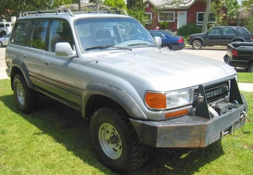

The only thing different about this build thread is the base vehicle, a 91 FJ80 with a 1HD-T conversion registered in California. I had given up on putting a diesel in my 94 FZJ-80 when I came across this built cruiser. The PO did all the hard work especially the registration.
Current mods
  • Gianormous front bumper w/Warn 8274

The 94 donor as I bought it a couple of years ago. It's now being robbed of parts for the 91 starting with the e-locker axles.
