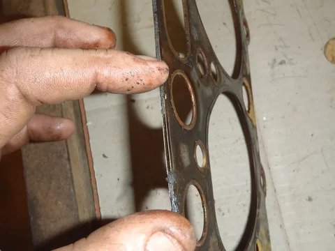

just giving this thread a little update. got the head off stablemate last night. want to sort this and tidy a few things up before i get much deeper into the 61 shorty. anyway no nasty surprises in there. not a drop of moisture in the pots anywhere; seems like simply a bit of gasket fatigue between a water gallery and the outside off the block. gasket has separated between layers in a small area. sump off is next for a panelbeat and clean then plot my next move. may or may not undo a bigend for a looksee; most likely a quick valve grind and slap it all back together

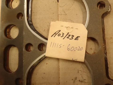

a couple pics. head off, gasket damage from waterjacket to outside between my fingers, nos head gasket among my fathers junk
