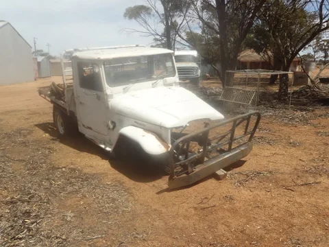

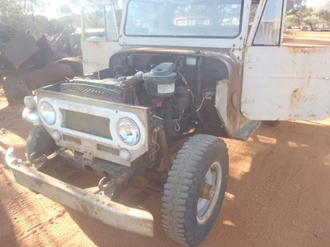

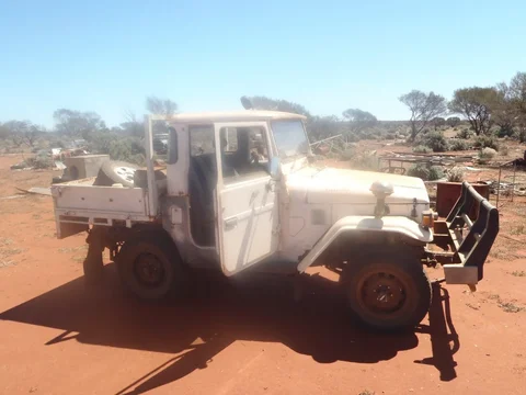

its a 63. comes with a 67 build f motor with all the fruit; carby' aircleaner, genny, regulator, hand primer pump. one tin cap master cyl. the gearbox and column lingage are the later generation; so much for all my spruiking and surmising that australia never got the 2nd generation of the 3 speed in column shift formation. apologies for the misinformation! has the offset rear diff but retains the skinny fj25 type driveshafts.

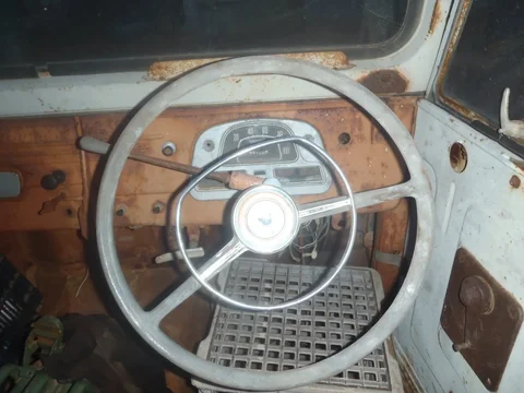

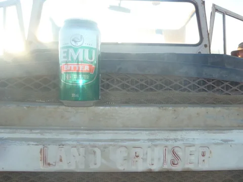

cab is a mishmatch of everything. it has been painted silver with a housebrush (hence the name) and a lovely orange? on the inside (more on this later). its a bit rusty about the floor but salvageable enough. has an ashtray but no provision for rear locks yet.
roof is ribbed and not too bad at all far as they go. no tools at all! most of the 23mm nuts are there though.

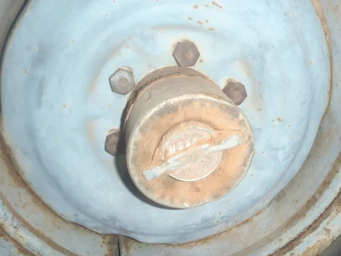

came with these period lock hubs (work) and a funky steering wheel!
