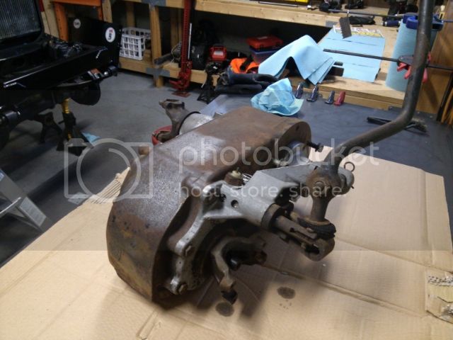

Tonight I started on the transfer case...

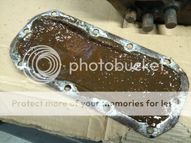

$60 Dana 300

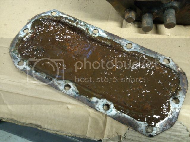

At some point water infiltrated the case as the bottom pan and interior walls look(ed) like this...

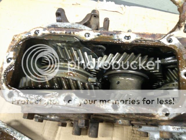

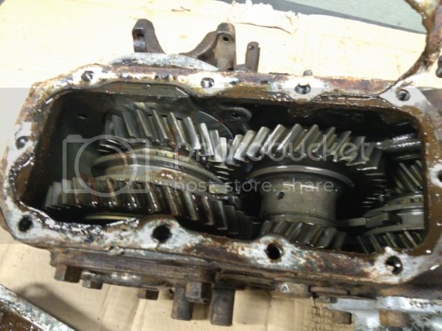

The gears and shafts stayed lubed with oil so no rust was able to develop and I will hopefully be able to recoup a few dollars on the original parts.
As far as I got tonight was removing the input shaft and retainer. Should be able to get the rest pretty close to torn apart tomorrow or Tuesday. Feels good to working again.

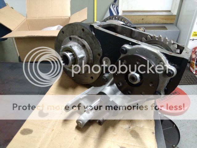

The transfer case is done! I only had a few :homer: moments, and only one of them had my questioning why I did this and didn't pony up for an Atlas. That was due to my not double checking the numbers on the bearing against those in the directions. Apparently 0.015" makes enough of a difference that even a press can't overcome. Also destroyed a roller bearing when I realized I had the front output shift collar on backwards. Thankfully Autozone had a replacement in stock.
The 4:1 gears are big. The notch I made previously for the idler gear wasn't large enough, and using a hand file is a small pain in the ass when the input/output assembly is an inch away. Eventually everything fit and the vaseline did its job keeping the needle bearings neatly packed in the inner bore of the idler gear. When I get the twin stick put together, the only drive I won't have is FWD high. For some reason I'm looking forward to having FWD low.

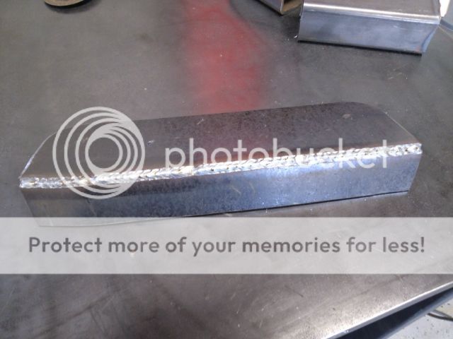

New frame plate, welded up and ready to go. Bending the plate did claim a HF c-clamp, so maybe I'll finally invest in some non-Chinese s*** clamps.

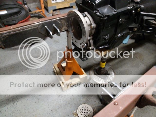

Some more progress has been made over the past few days. With some flat plate and link tabs from Ruff Stuff, I put together the frame mounts for the transmission crossmember.
And glued on...
The brackets are positioned to where I will hopefully end up with the drivetrain at 3-4 degrees (when the rubber trans mount is compressed), which I guess is preferred.

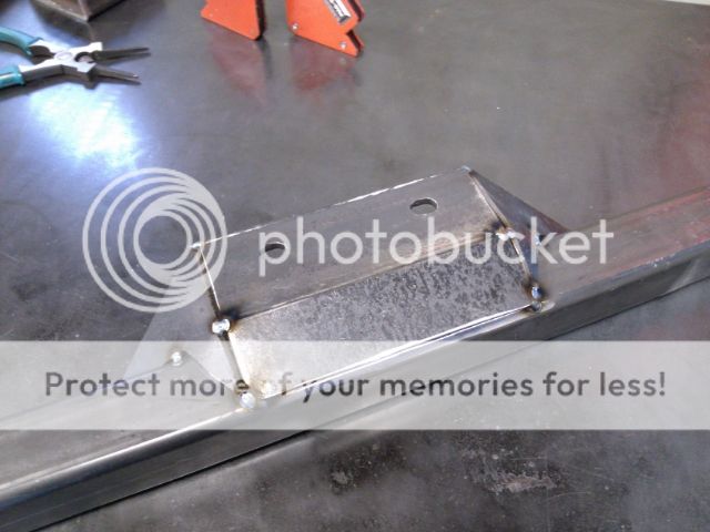

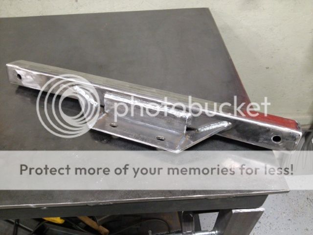

Probably 3 weeks ago now I built the main structure of the crossmember... 2x2" sq., .188" wall tube, with 2.5x2.5", .25" wall angle for the mount support. Up until the frame brackets were burned in, I was going on hopes and dreams that the crossmember would work/fit. With all good, I did some reinforcement for the mount support, and checked one more item off the to-do list.
Mock up...
And done...
I now just need to wire wheel the frame, prime and paint up to where the factory horse collar used to live, then install the crossmember for good. Making small steps, but at least they're in the right direction.

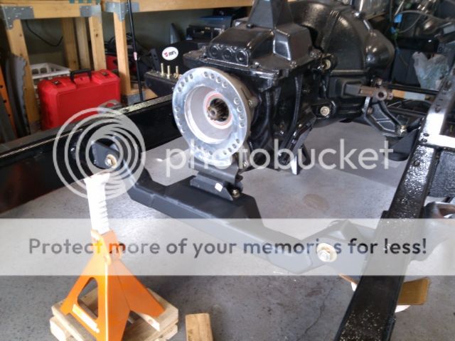

Had to redo the transmission crossmember after realizing I never took into account that clocking the t-case flat was not possible. That debacle somehow ate up a week's worth of shop time, but the drivetrain will still sit entirely above the frame rails. Can't complain about that.

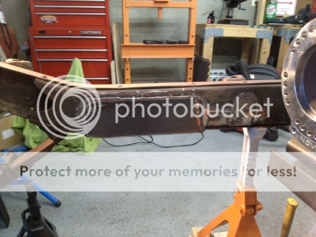

Free time has been hard to come by lately, but the frame is cleaned up for plating and rust repair for the rear frame crossmember is completed... cut the fawker off. Just need to pick up some more 2"x4" to eventually fill it back in.
I should be on track to finally get started on the 4 link this coming weekend, and hopefully have time to drop the Aussie into the rear 3rd this week sometime.
