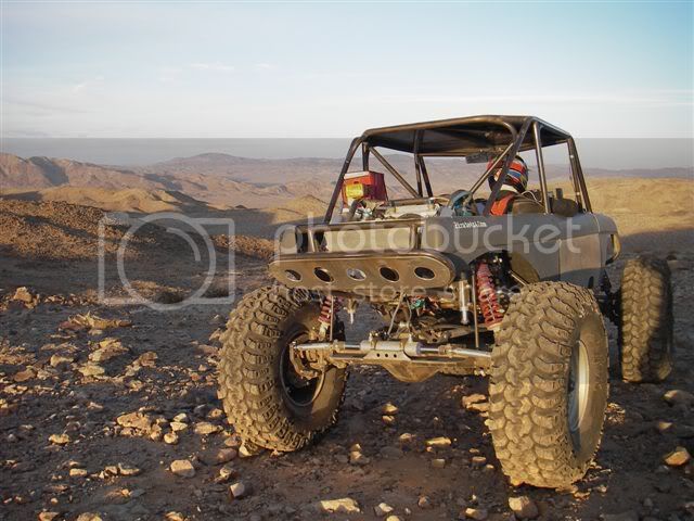

looks good, what are your plans for the rear tube work? I think it would look awesome is you just threw some bends in there and made the rear "bumper/gate" a halo with about a 75* angle. Like JR's Bronco...Ill go find some pics.
His has more angle than I thought, but you get the idea and it would be a nice way to wrap up the rear end with out having highly modify everything....or just tell me to shut up...on with the porn....
