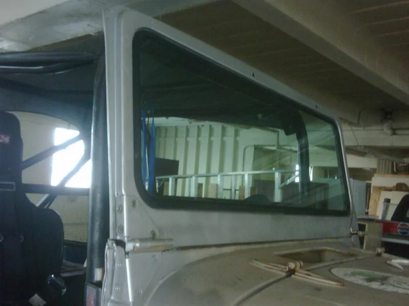

Found a winshield frame.
Got glass for said frame.

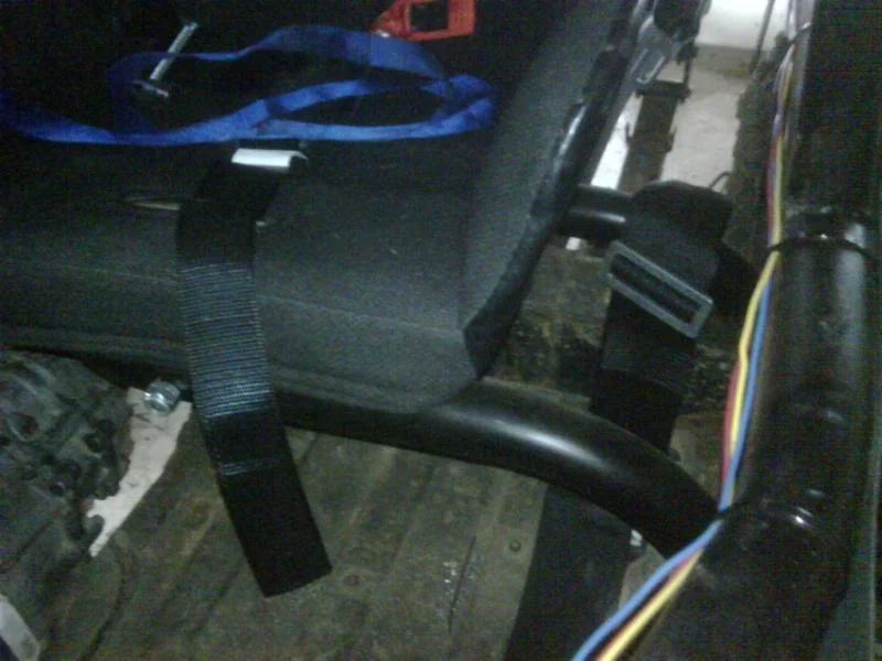

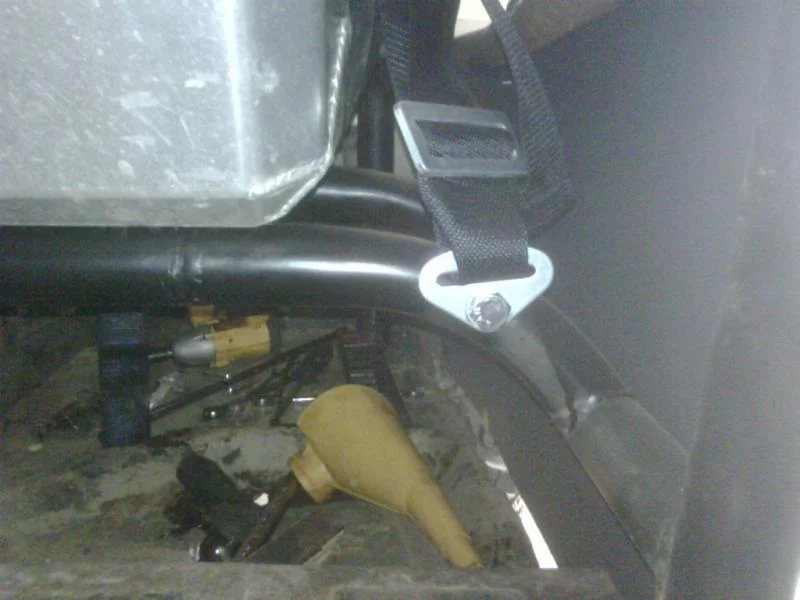

Installed 5 point harnesses

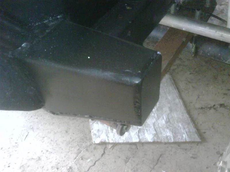

Finished the front bumper (capped off the square ends)

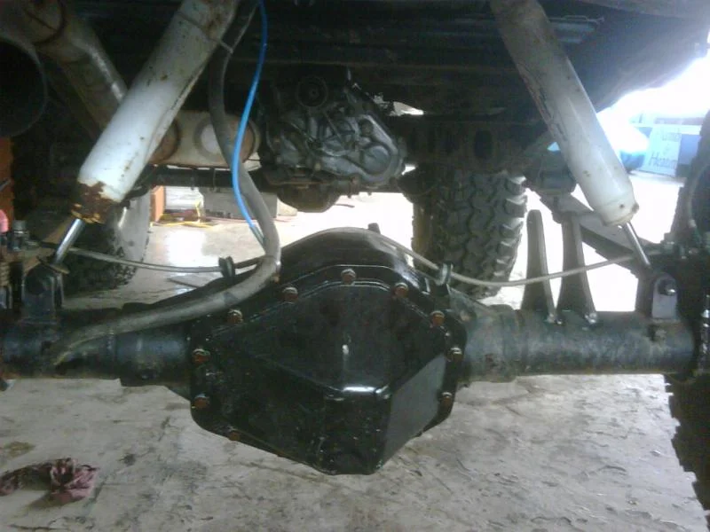

Pulled the rear welded differential carrier out and installed an ARB.
Welded brackets to the rear axle for an anti-wrap bar.

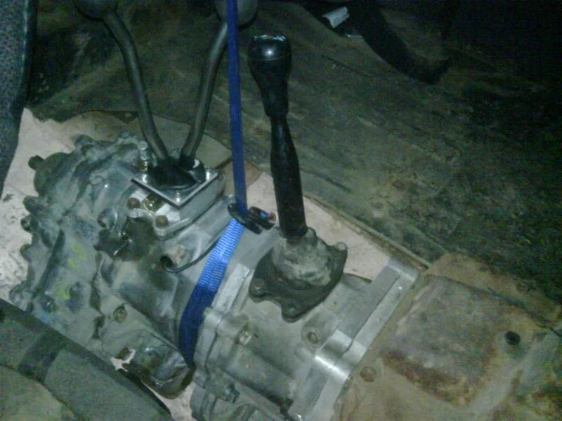

Pulled out the ToyBox and cruiser t-case.
Changed the output shaft in the ToyBox.
Changed the input gear in the 4Runner t-case that came with the buggy.
Assembled the ToyBox and mini t-case.
Installed it back in the truck.

Nice job Luke! You need to add new seats to your "to do" list. Those aluminum seats suck for more than an hour or two. They're even worse if you endo hard...

I actually like those seats- they seem to suit me very well. We'll see if they get old after more than an hour or two.
