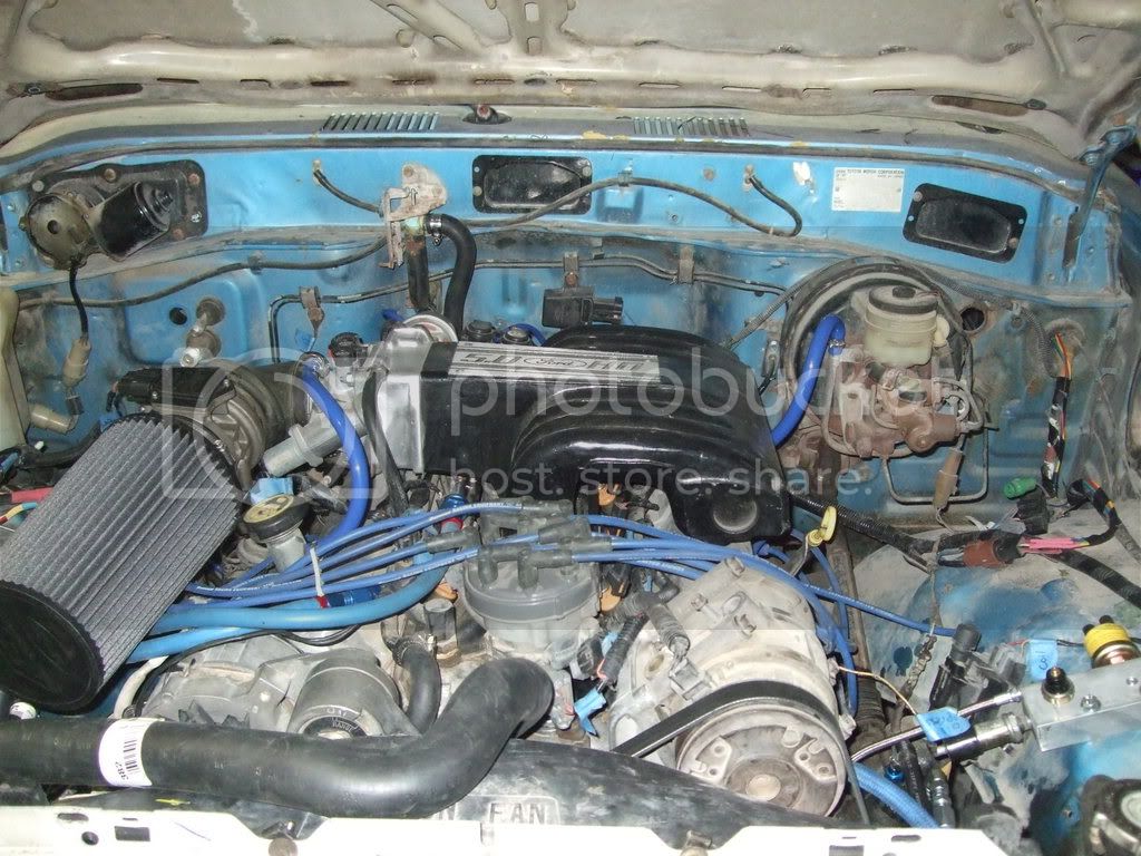

The motor is looking good now :D

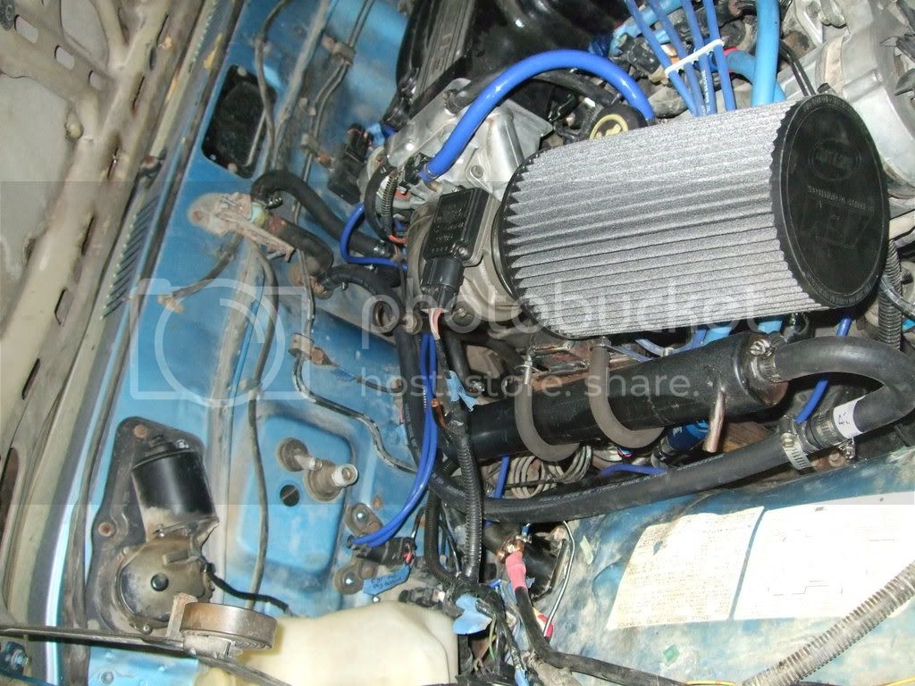

I had to make a support for the MAF sensor.. Made a great place for the heat exchanger (also to stabilize the fuel lines and smogpump valve).

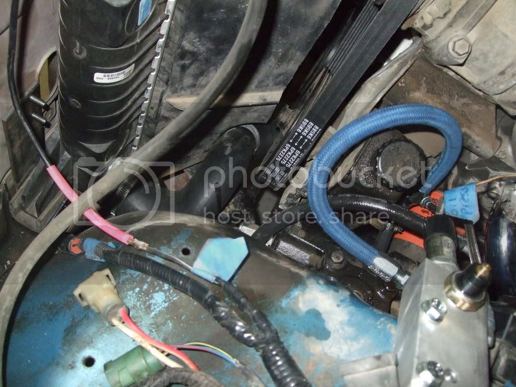

power steering routing.. Saginaw pump and the FJ60 box.. And yes, I screwed up the lines the first time. :rolleyes:
Had fun with this. I needed the stock ford oil press sender to make the motor work. I wanted the stock gauge to oil press gauge to work and I got an aftermarket gauge as well.. So I had to make a manifold for all of the senders... $2.00 worth of AL block a drill press and away we went. BTW, for the engineers, the 2F oil press sender is metric thread, everything else is npt ;)
