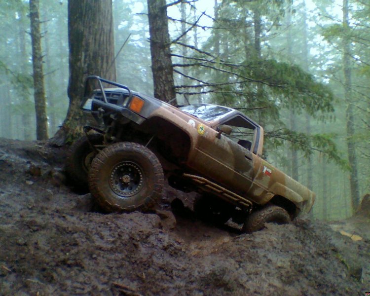

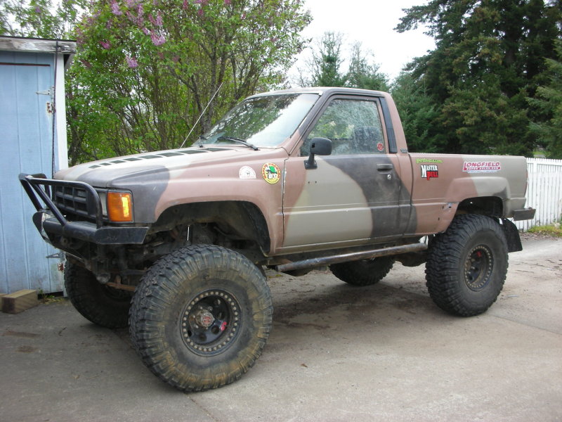

attachment.php
attachment.php
A shot from Tillamook state forest last weekend
how she sits in the driveway as of this afternoon
Welcome to Mud Tom!!! :flipoff2: Looks good! Any future plans?
Thanks!!!
Planning on some 4.70 gears for the rear T-case here pretty soon. Definatly need to bend up an inner cage for the cab, do up a link suspension in the rear, and possibly stretch the wheelbase some.
Sounds like a solid plan there. Are you local to Tillamook? I was up there for Cruisin' the Woods last year, and the place is crazy in the best way! :D
No, it was actually my first time up there. TSF is definatly the place to have a good time!
Man, you guys in the pac north west kill me!
That thing looks sweet enough... lol, it's just a street legal 4 wheeler
Exactly what i was shooting for, A very capable wheeler that is also my daily driver!
That's an awesome front bumper (amongst other things!) What's the OD of the tube?
Thanks!!
Tim at wild west used 3 5/8" for the main bars, the stinger is 1 3/4", and the hoops off the stinger and the little guys on the bottom are 1 1/2", All DOM. I like the looks of the big tube, almost looks like a retro 80's style bumper.
