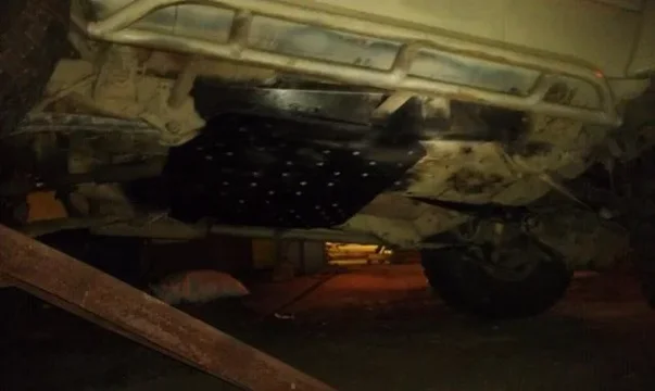

Here's a bad pic from last night after I rotated the rear axle 15 degrees...
From the drivers rear (drivers rear on ramp)
From the drivers side (driver front on ramp)
