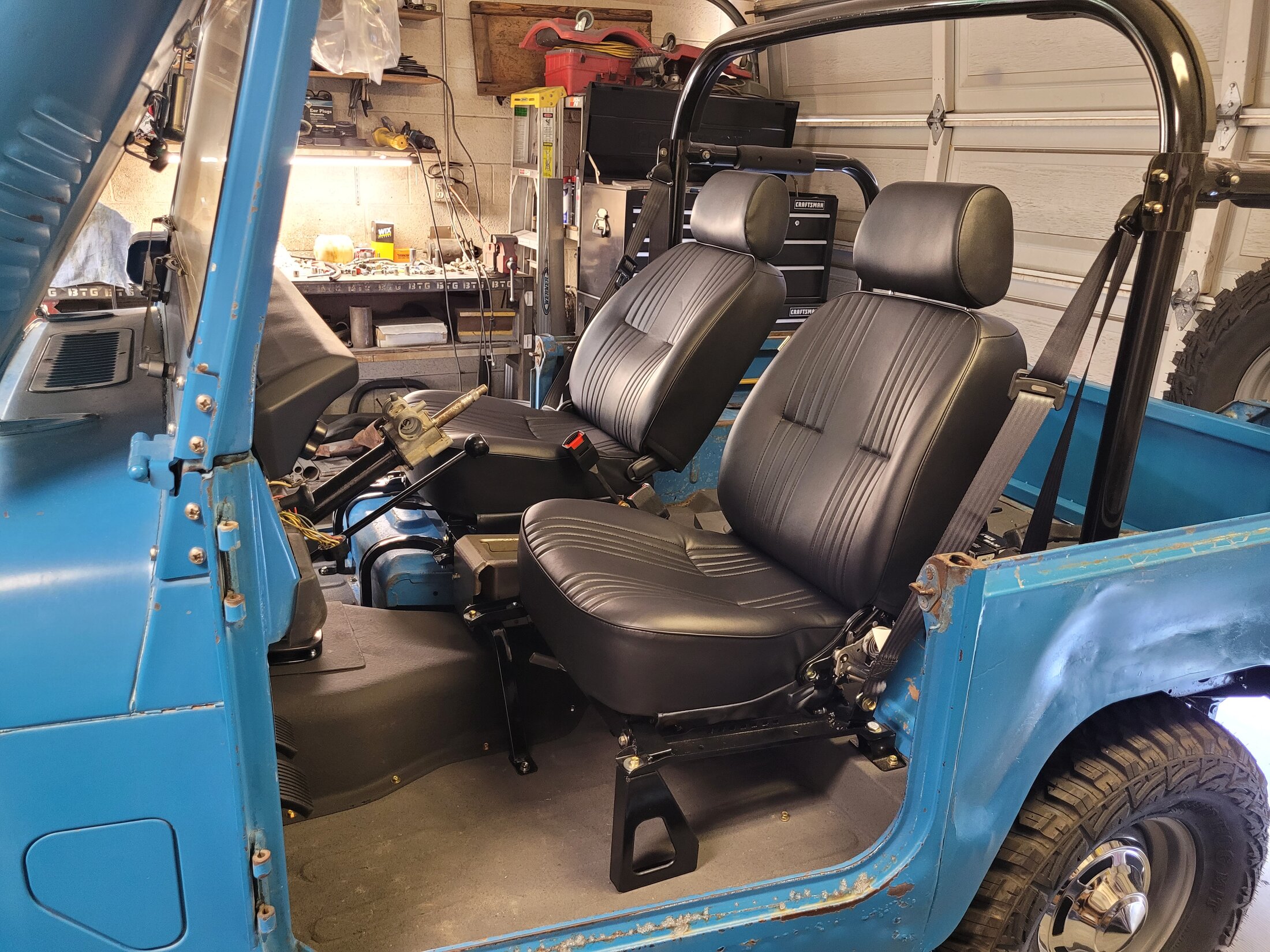

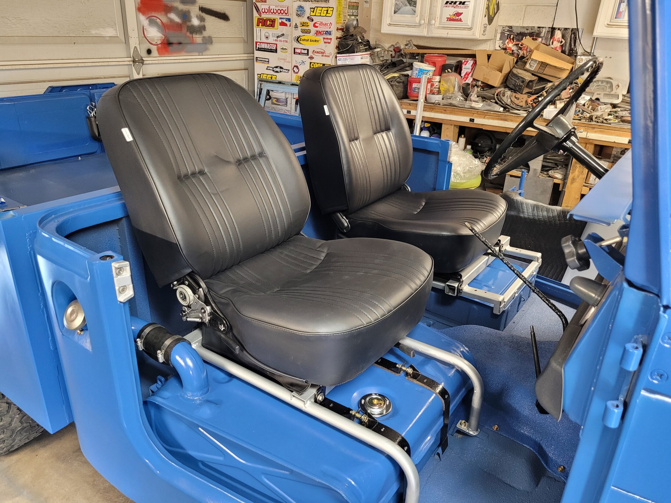

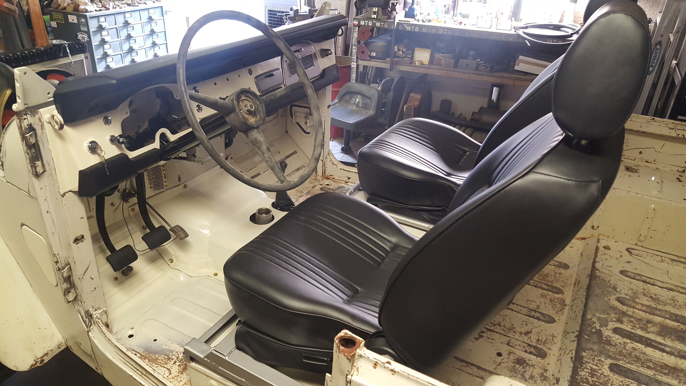

Like stated above, I have used Procar 90s in several of my builds. A few early trucks and a couple later models. The passenger seat ends up slightly higher than the drivers side due to the fuel tank. My pics don't really show the mounting brackets I made though.

where did you get the seat mount for the driver's side in the bottom pic (without the storage under the seat)?
the previous owner removed the storage and i need a mount.
In all of my seat mounts I reused the factory stuff and modified them to fit the Procars.
In the last pic, that's the oem mounting, modified of course, I used.
You should be able to find that stuff used.
