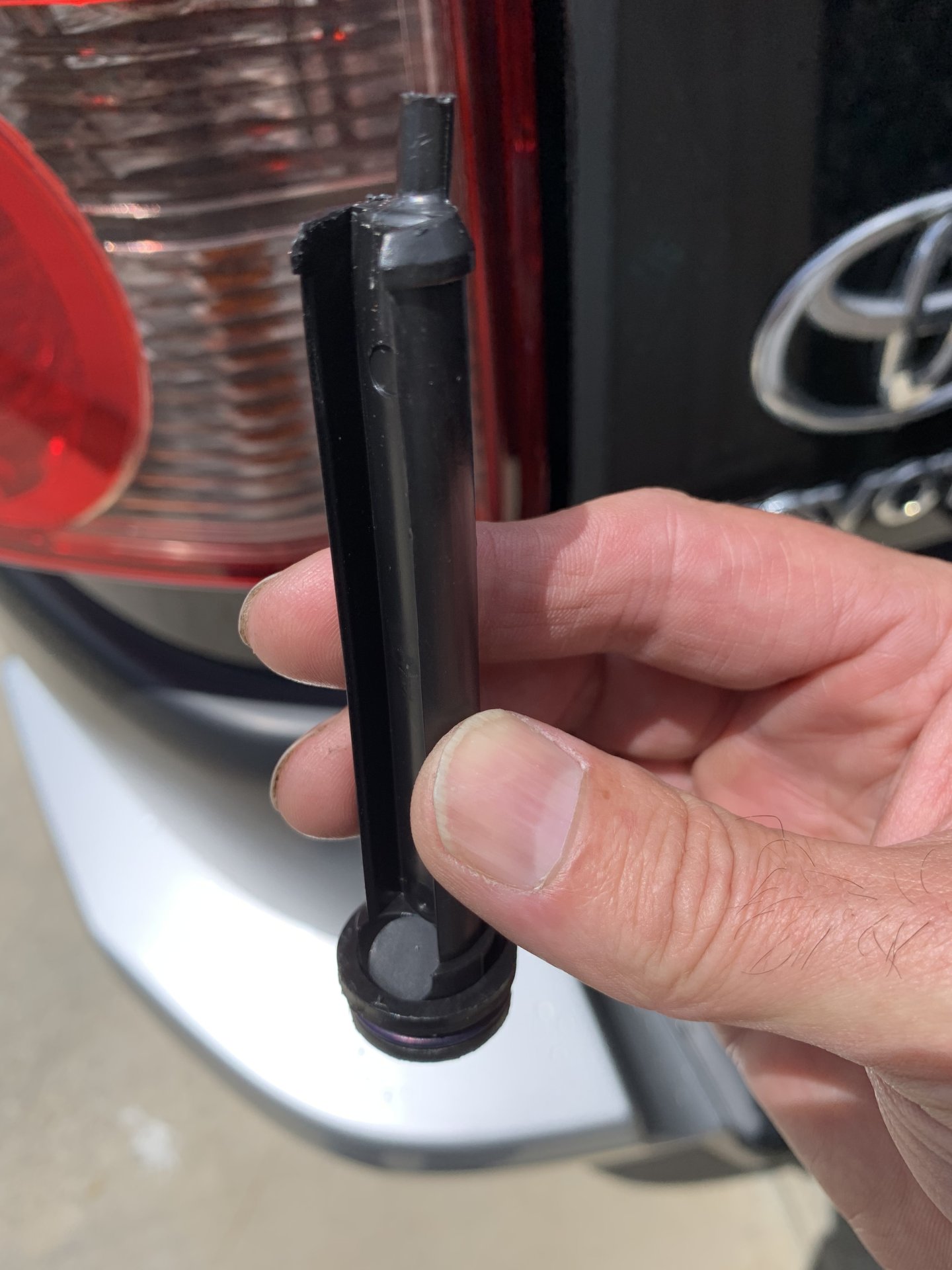

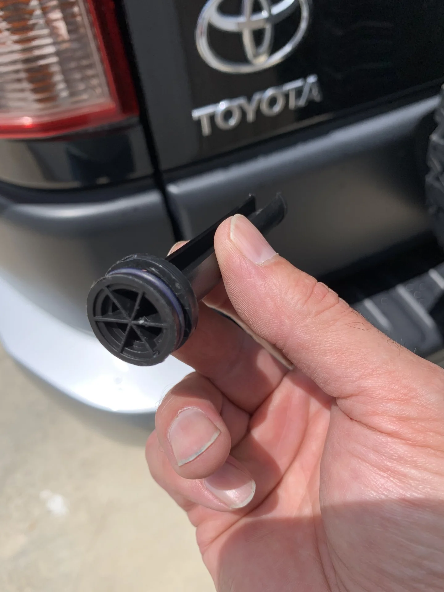

This is finally solved. The problem turned out to be a piece of plastic stuck in the filler neck past the bend. Someone must have used a gas can with a fancy CARB filler nozzle and a piece came off and fell inside the neck. Pain in the butt but got it out and it now fills like a champ. Sucks down $100 worth of gas with no problems 👍
For future reference if you have fueling issues, run a camera down the filler to make sure it’s clear. Next issue can be a stuck rollover check valve inside the gas tank or a plugged charcoal canister, preventing proper venting during fueling.

I have that same problem. What was the best way you cleared it out? What device did you use to extract the plastic?
I cut the pipe underneath right after the bend. Then I pushed it up with a wire. Then use a gas hose and 2 worm clamps to connect it back.
First try using a wire and put a small hook on the end and try to fish it out.

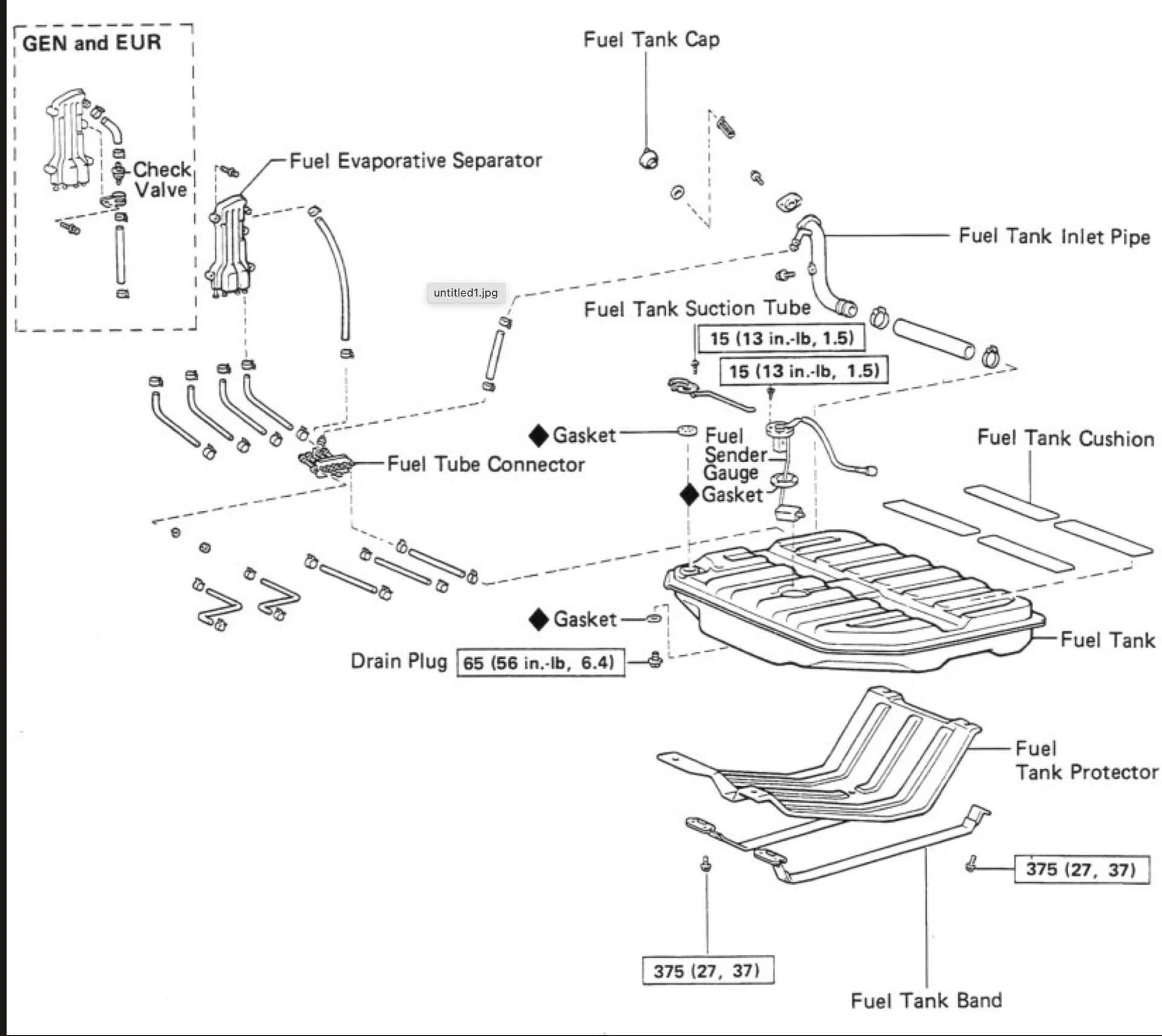

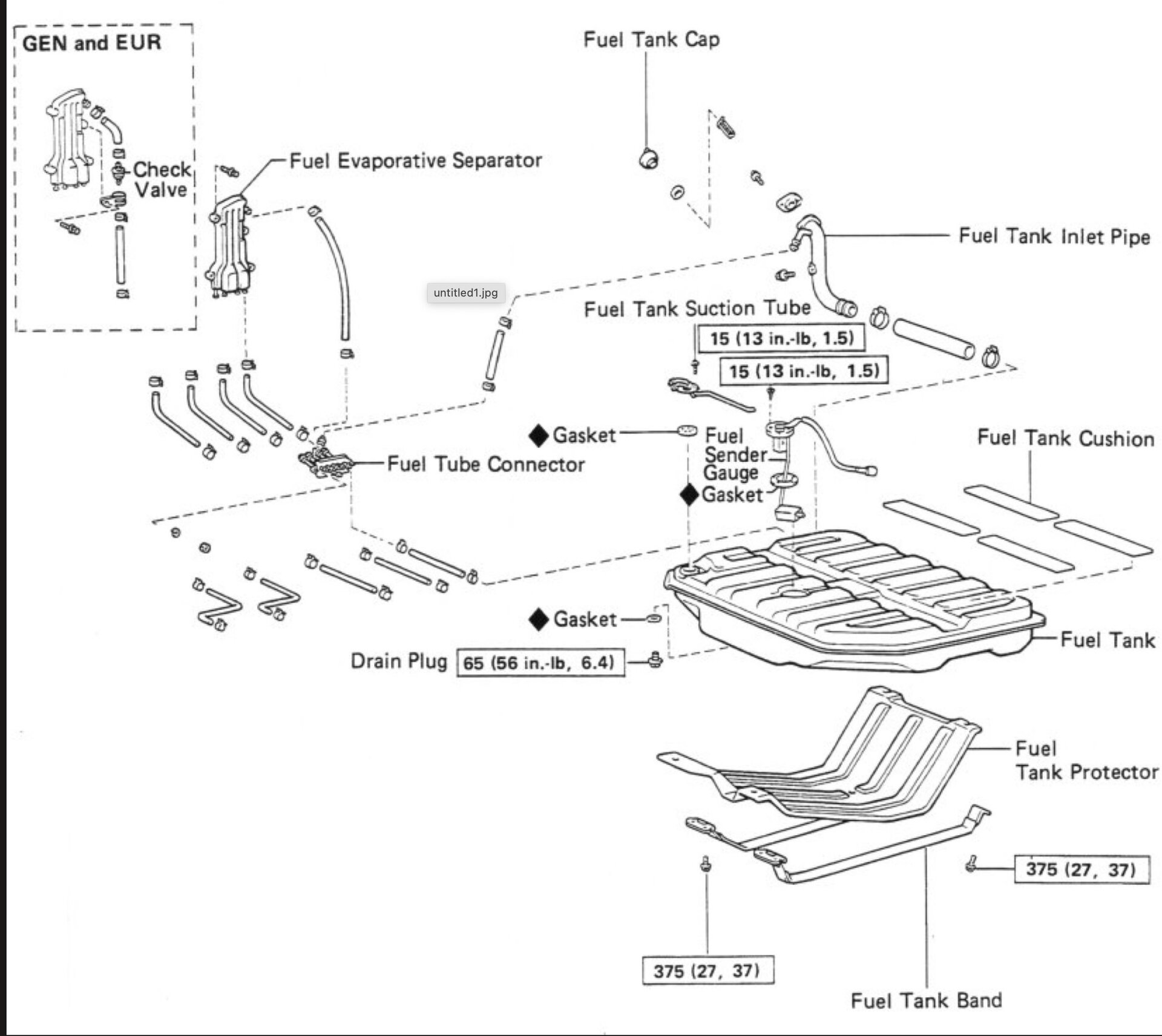

what can you do for a jacked-up vapor system? I have a feeling my fj60 that sat for a long time and was beat to s*** likely has some clogged lines or something. Replaced charcoal canister already and just did an engine rebuild (obviously for a different reason haha) and still having this issue. Curious if it might not be a filler pipe obstruction and the "vapor system could be jacked up" sounds intriguing.
Can one replace the venting separator or clean it to resolve this sort of thing?

So what supposedly happens is the charcoal canister gets fully saturated inside....eventually this saturation of fuel can damage sensors beyond it....at that point a code is typically thrown. I think the only way to 'fix' the separator (charcoal canister) is to replace it. Not sure how sensitive or not a 60 would be to the separator being 'unable to separate' vapors well due to it being saturated or whatever happens inside those things....caked up?...blocked? Maybe.

Already replaced the canister.
