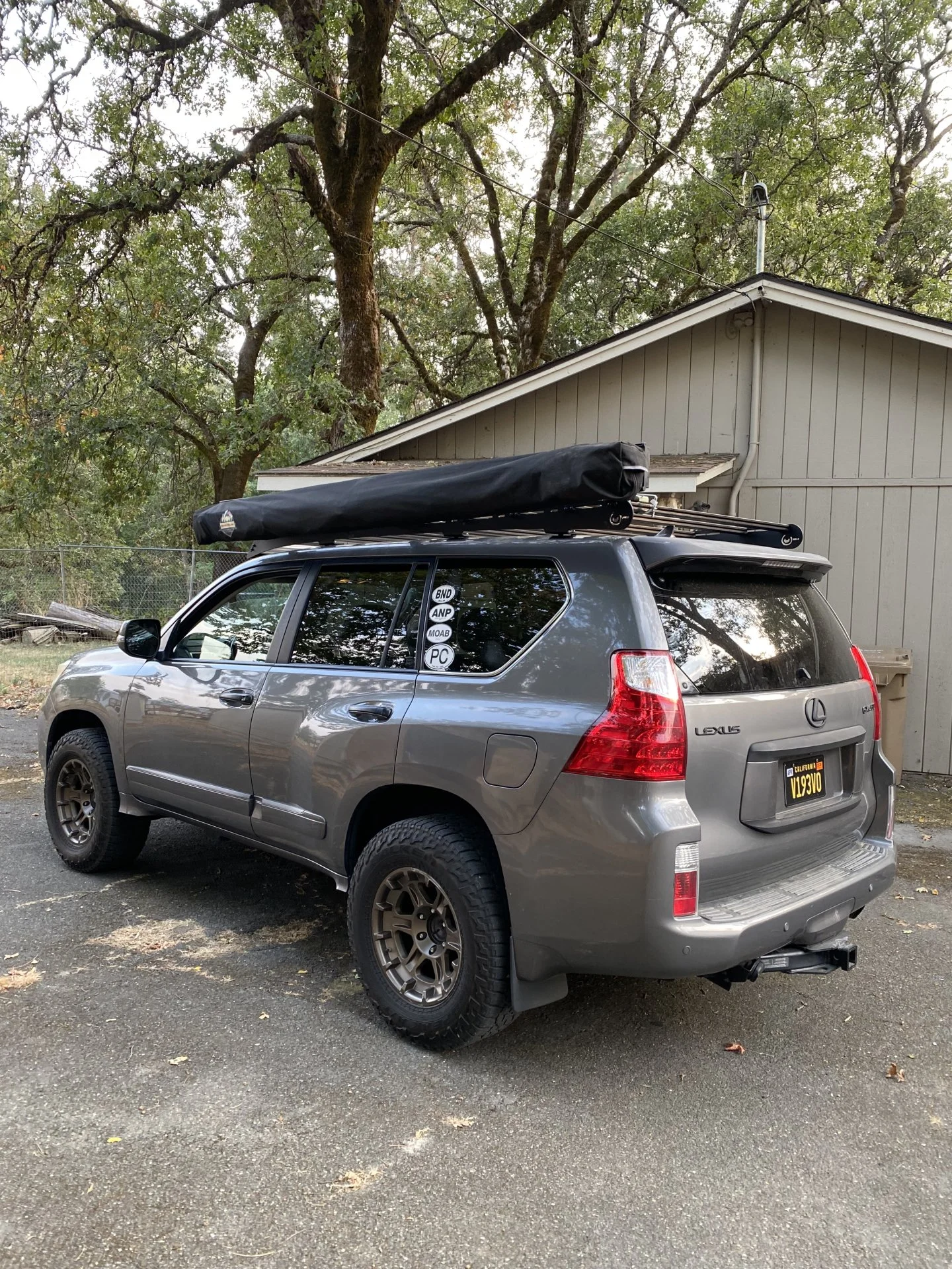

This is how I had my batwing (compact) mounted. It weights 40lbs, and never noticed any sort of deflection.

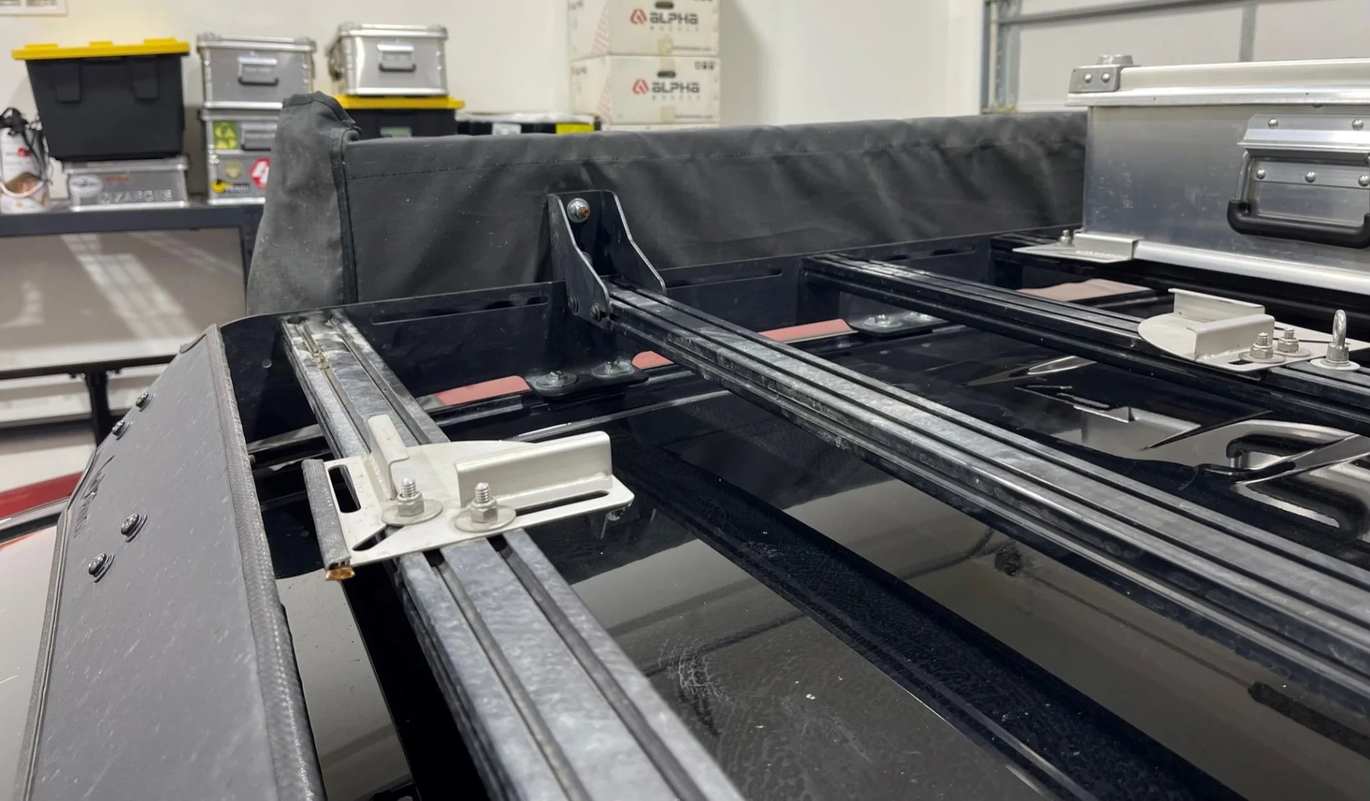

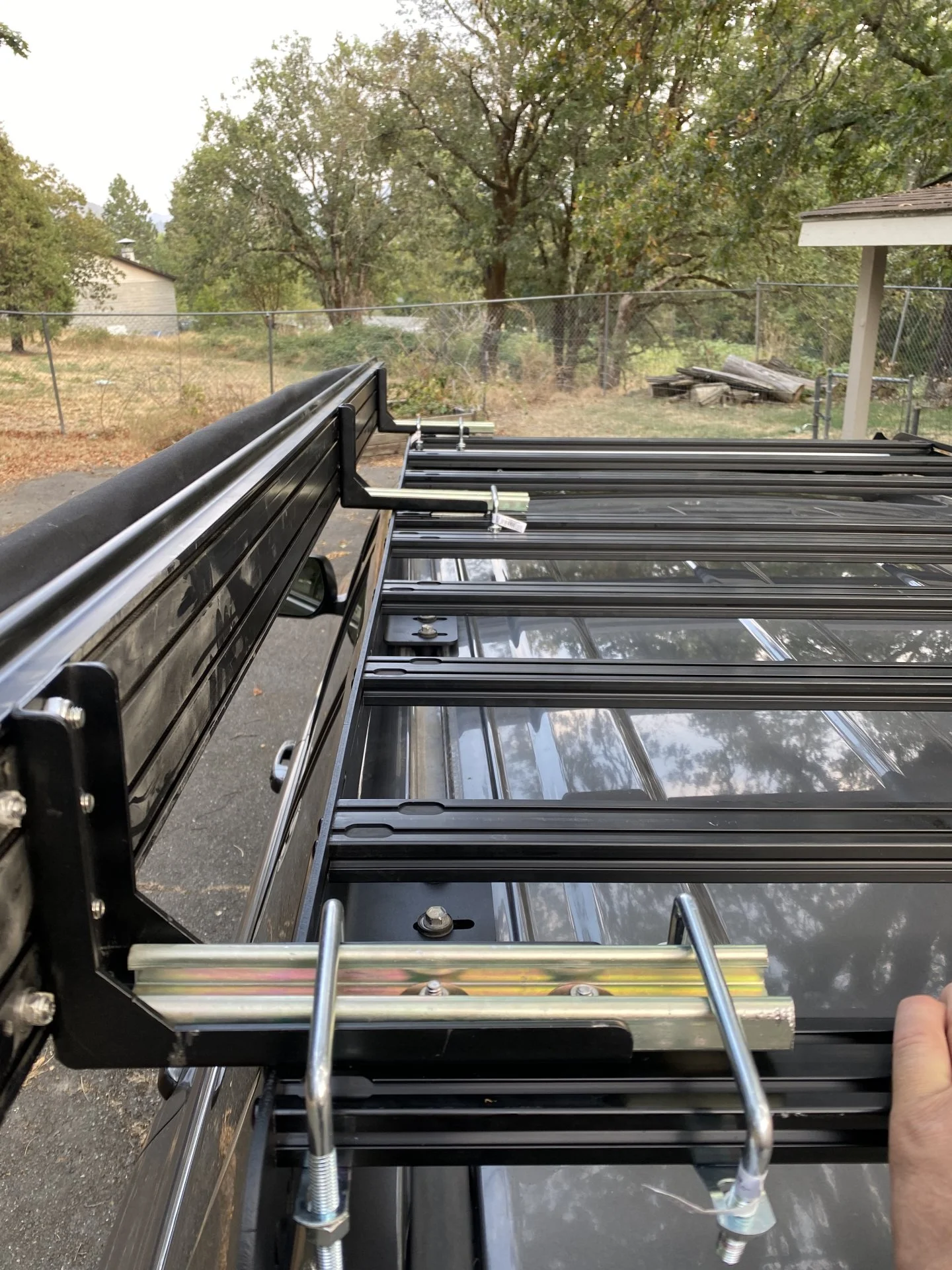

I am running an Ostrich Wing Jr on my Prinsu. I am using a combination of brackets. One Prinsu awning bracket for the front mount, as I needed some additional clearance to be able to mount the Zarges boxes. For the other two mounts, I am using Kaon's adjustable brackets. I haven't noticed any excessive flex or issues.
