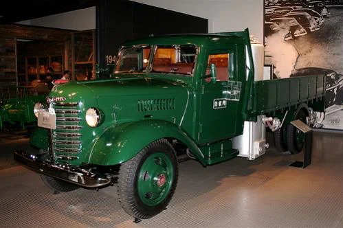

Toyota had the wood burners as well (postWWII) ...would be a cool thing wouldnt it.

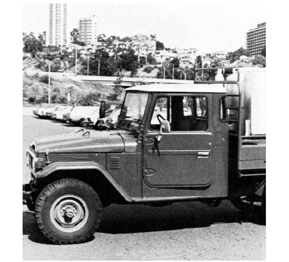

They did it in Australia .
"Perth, Western Australia, 1981. A Toyota diesel Land Cruiser fitted with dual firebox gas producer being tested. The unit has both an updraft generator for charcoal fuel and a downdraft generator for wood chips. The two are coupled so that gas from the wood chips passes through the burning charcoal and is purified of tars before entering the engine. For short runs, only the charcoal generator is lit. It is efficient, quick starting, and handles variable loads with little change in gas quality. For long runs, both fireboxes are lit. The gas formed by the downdraft generator supplements that from the updraft generator. The downdraft generator has three rows of air inlets (tuyeres). By unplugging the different rows a wide array of fuels and horsepowers can be accommodated. The unit shown was sized for use on an 8-ton truck "

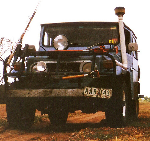

Maybe not a previous owner (as it was me - but I guess I am the PO now) but a cashed strapped uni student who was working as a builders labourer - and thought a cheap way to put on Donaldson Air Cleaner as a snorkel was to use some 90mm PVC pipe left over at the building site (Never mind the occy strap holding the number plate on).

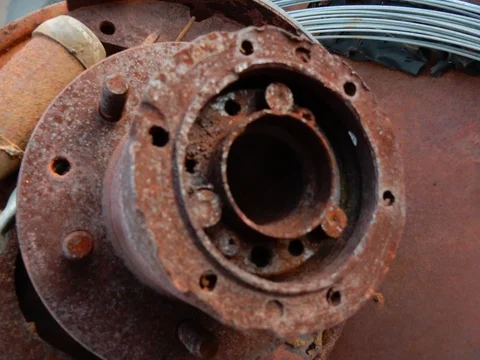

found this among some old axle assemblies and tojo junk i collected from a long abandoned prospector/miners camp. for the life of me i cant work out you even do this much damage to a fully floating rear hub? classic!
