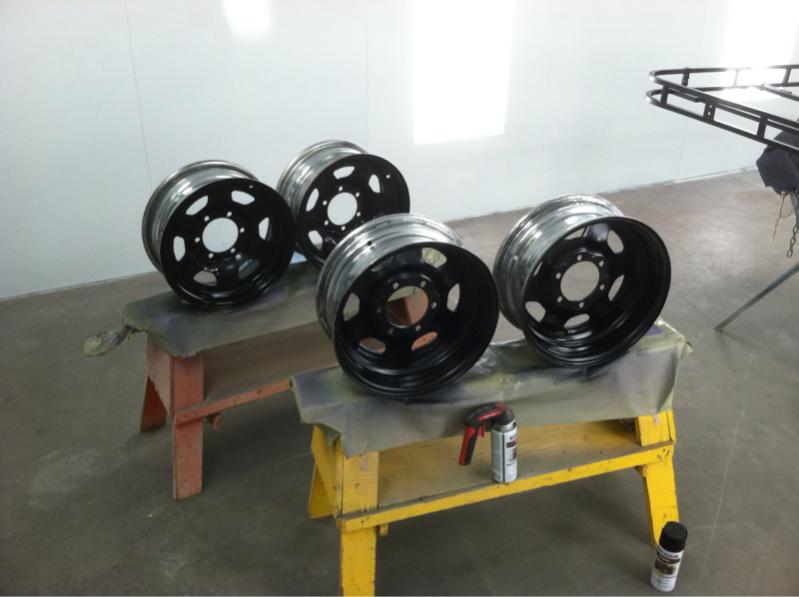

Sand em, prime em, and spray em black:-)
