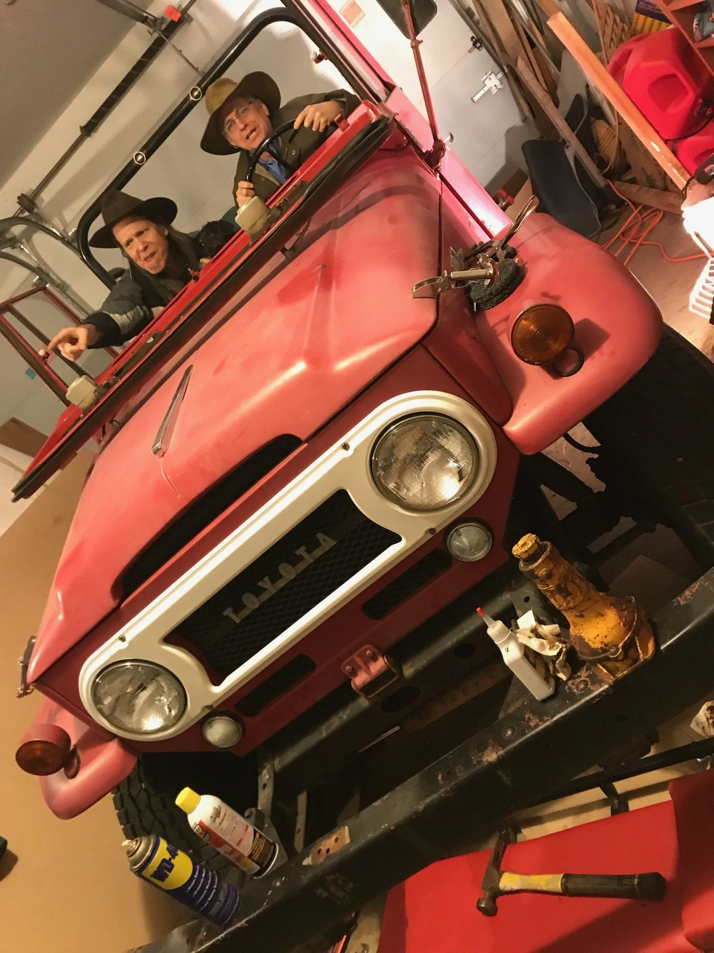

My handle of Hello Kitty came from badly oxidized red paint that several people told me looked pink. It wouldn't buff out.
Then I noticed a clear drip on my glass. It took a green potscrubber and a sharp knife to get the damn thing off. It was old clear coat. The whole exterior was coated in it. I discovered that hand scrubbing it eventually gets me down to red paint. So now, in honor of Amada Blake's character in Gunsmoke, and her beautiful red hair, allow me to introduce Miss Kitty.

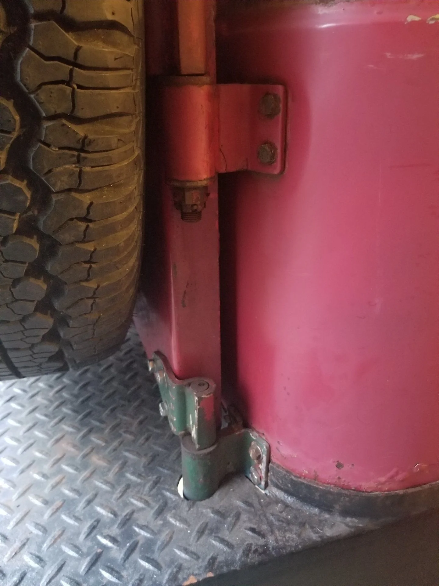

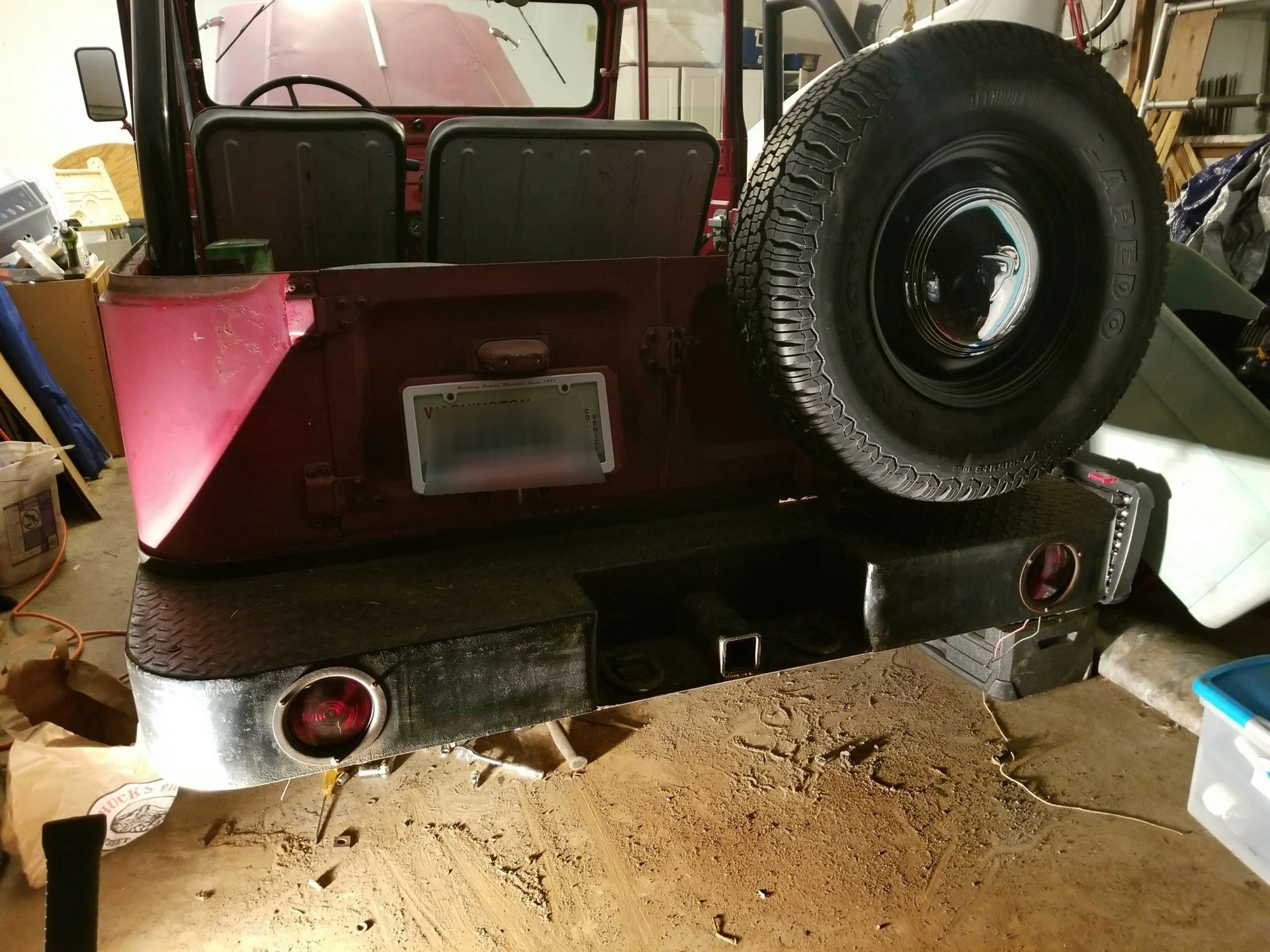

First order of business, returning some of her classical lines on the back side.
The spare tire carrier was loose in the car, and had a busted hinge. I was excited to find one from an old guy who told me 'stock was best'. I wasn't there yet, but restoration fever was taking hold.

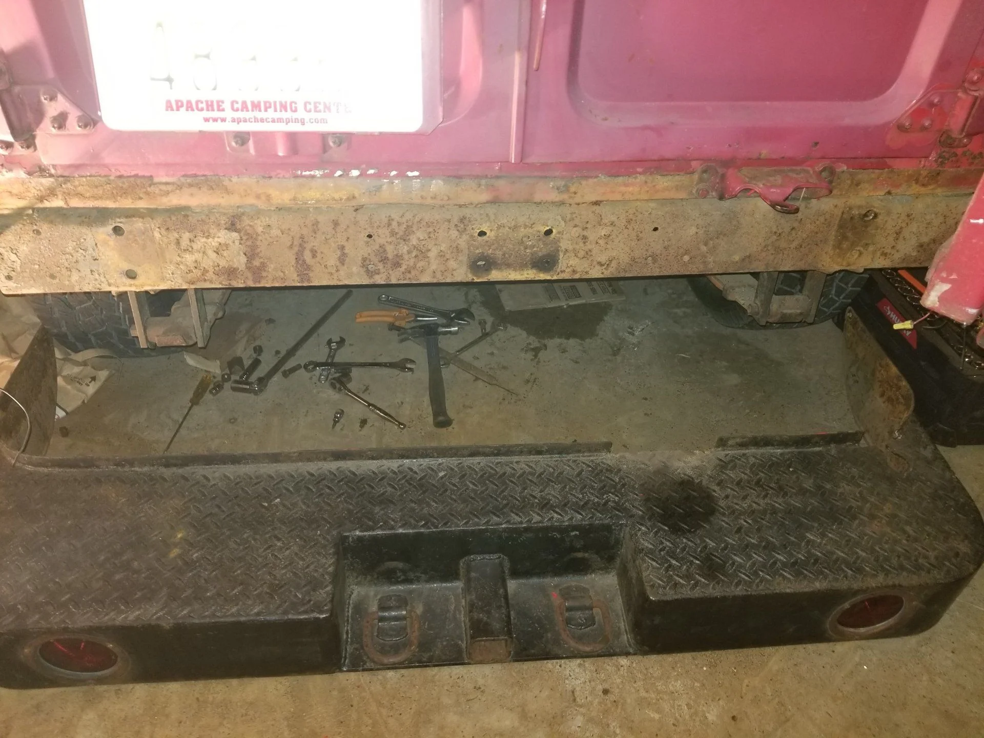

I decided, the bumper, cool as it was, had to go.

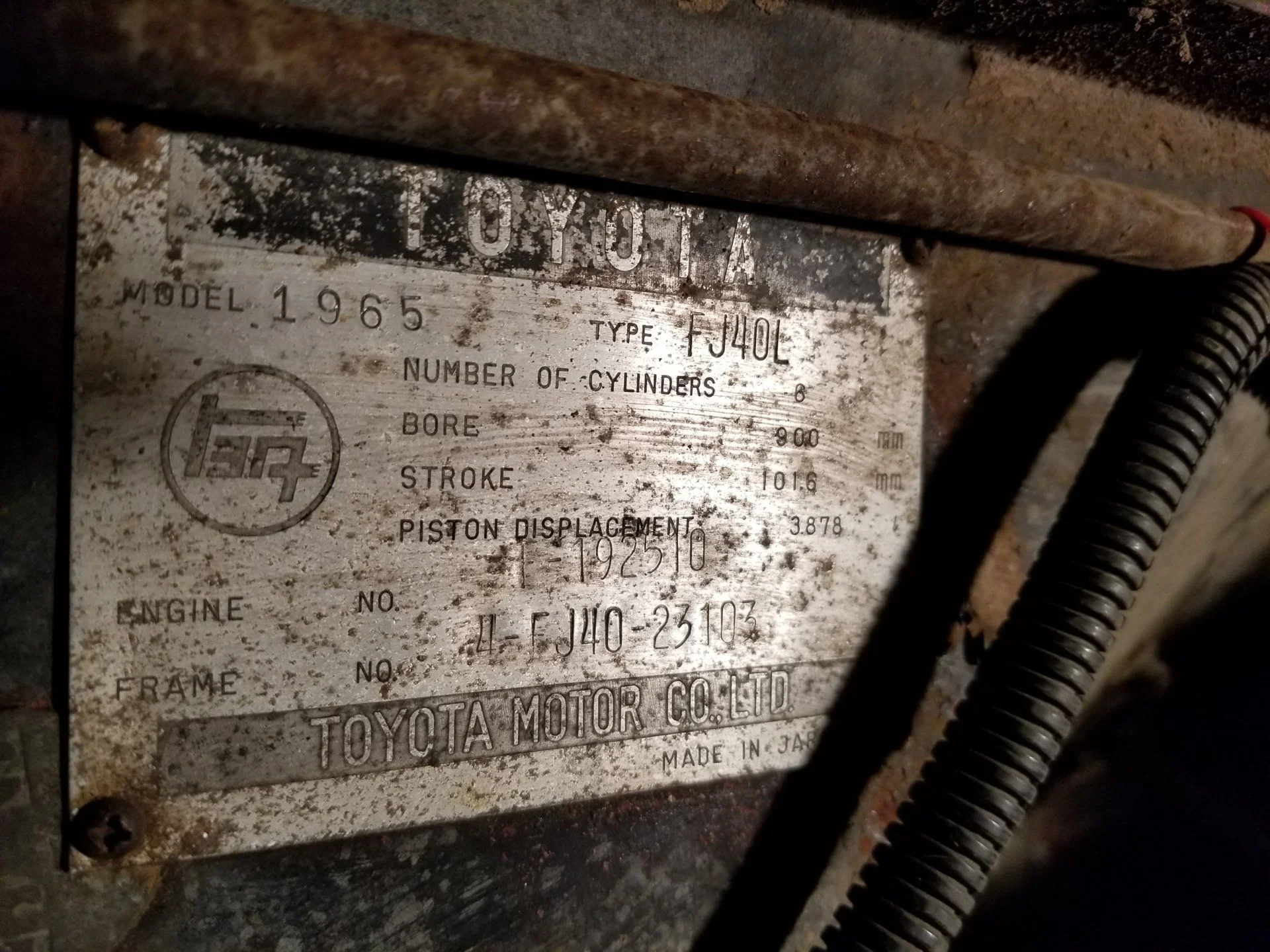

Build date seems to have been January of 1964. A brass T-65 tag and VIN plate show it first registered in 1965.

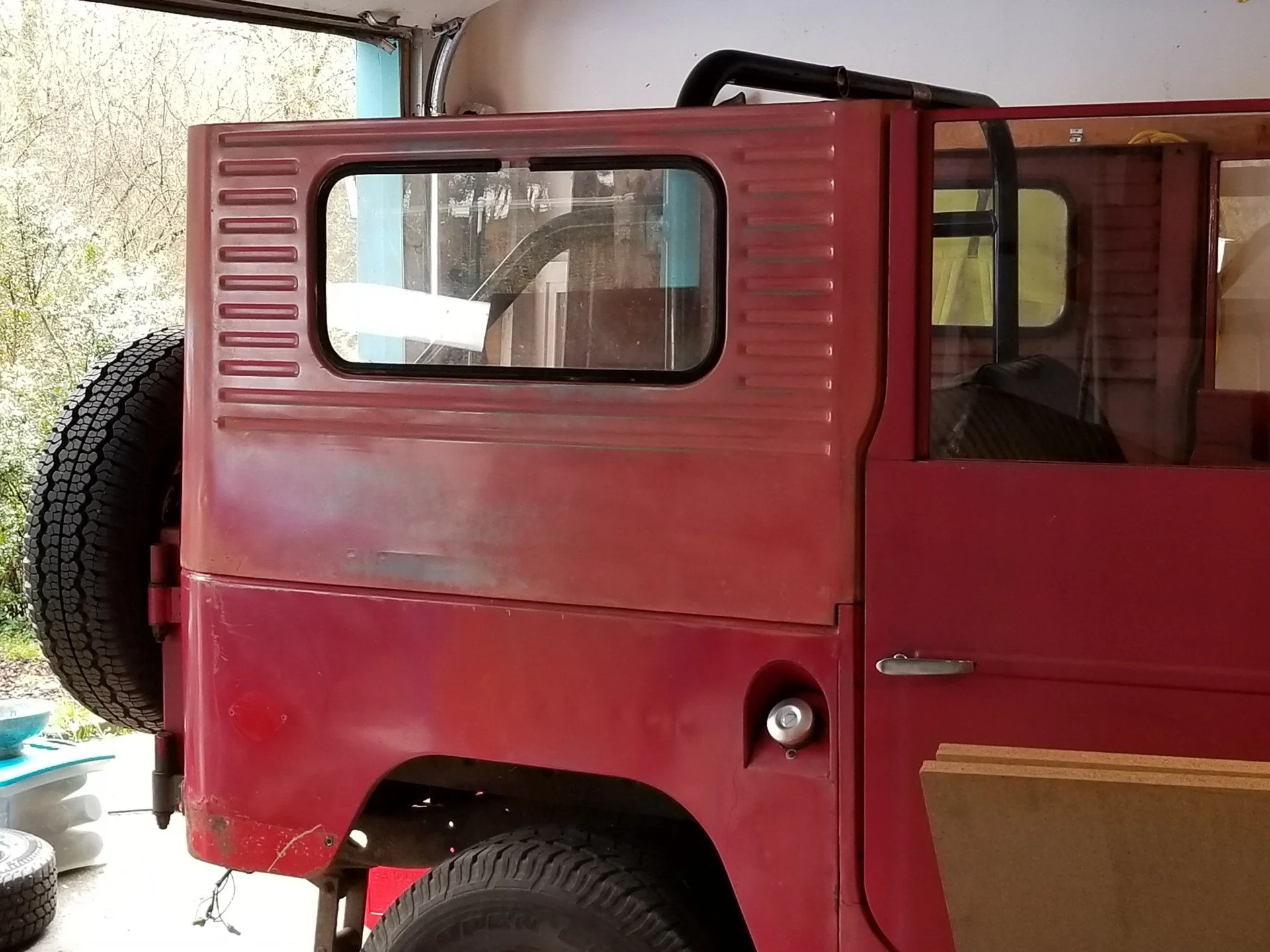

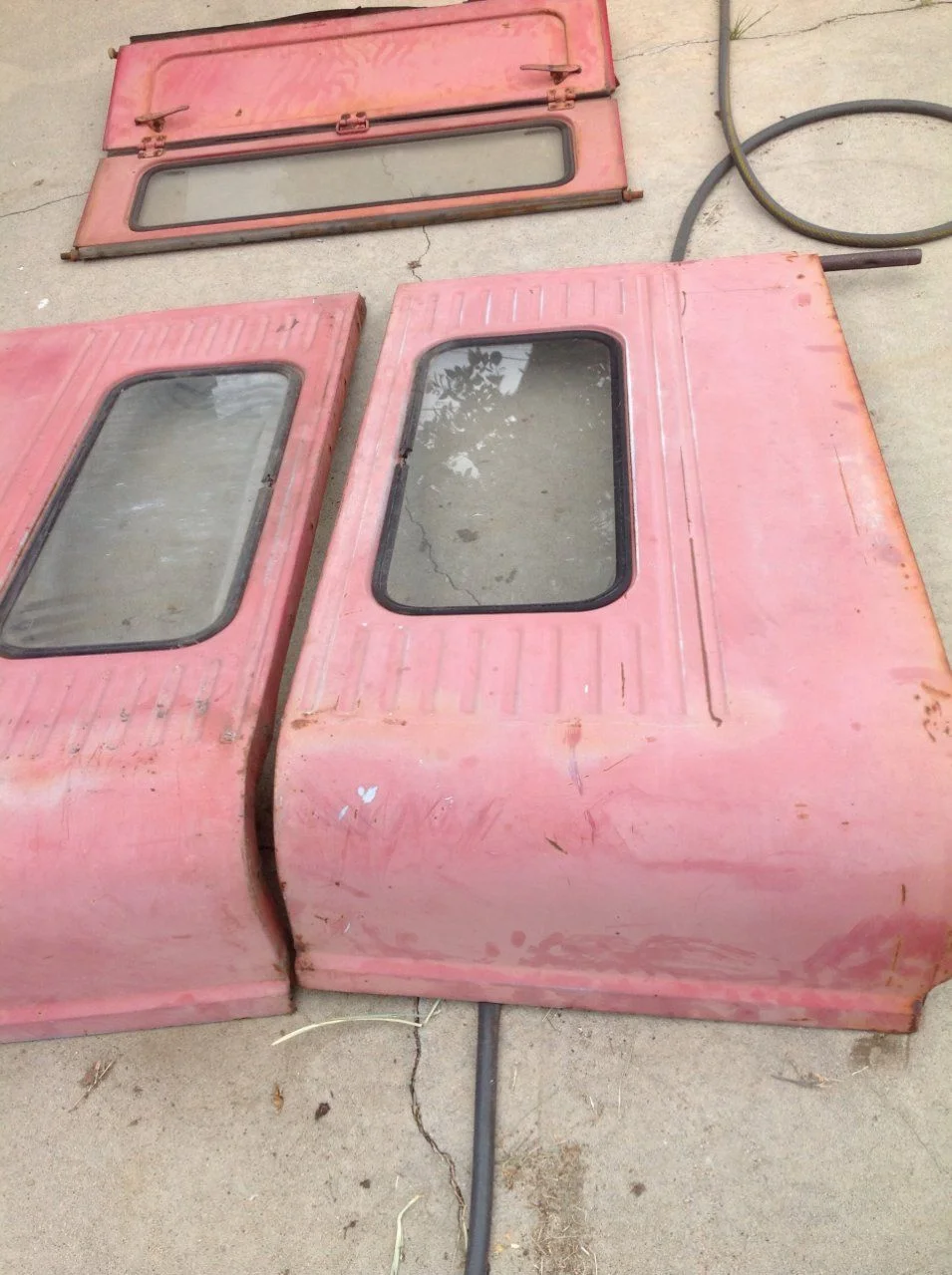

About caught up to real time, from the last 4 months of activity. My corrugated sides had corner windows added, and I bit the bullet and got these from Mark's Offroad

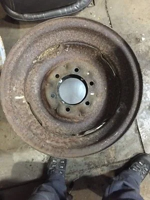

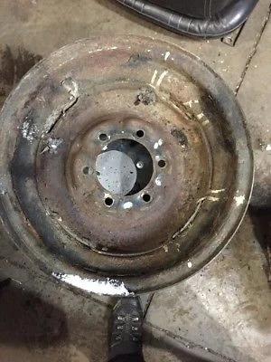

I'm waiting for three riveted rims, they look kind of rough. Am looking for one more, and plan to paint them all red. Have one new welded rim for the spare and a sole oem acorn hubcap. Ordered up a new full set of new acorns from Speedsail. Tall skinny tires are in the plan

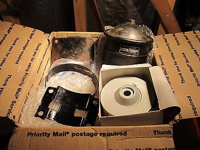

Just arrived today, a 1963 oil filter to replace an aftermarket one.
My first engine restoration purchase.

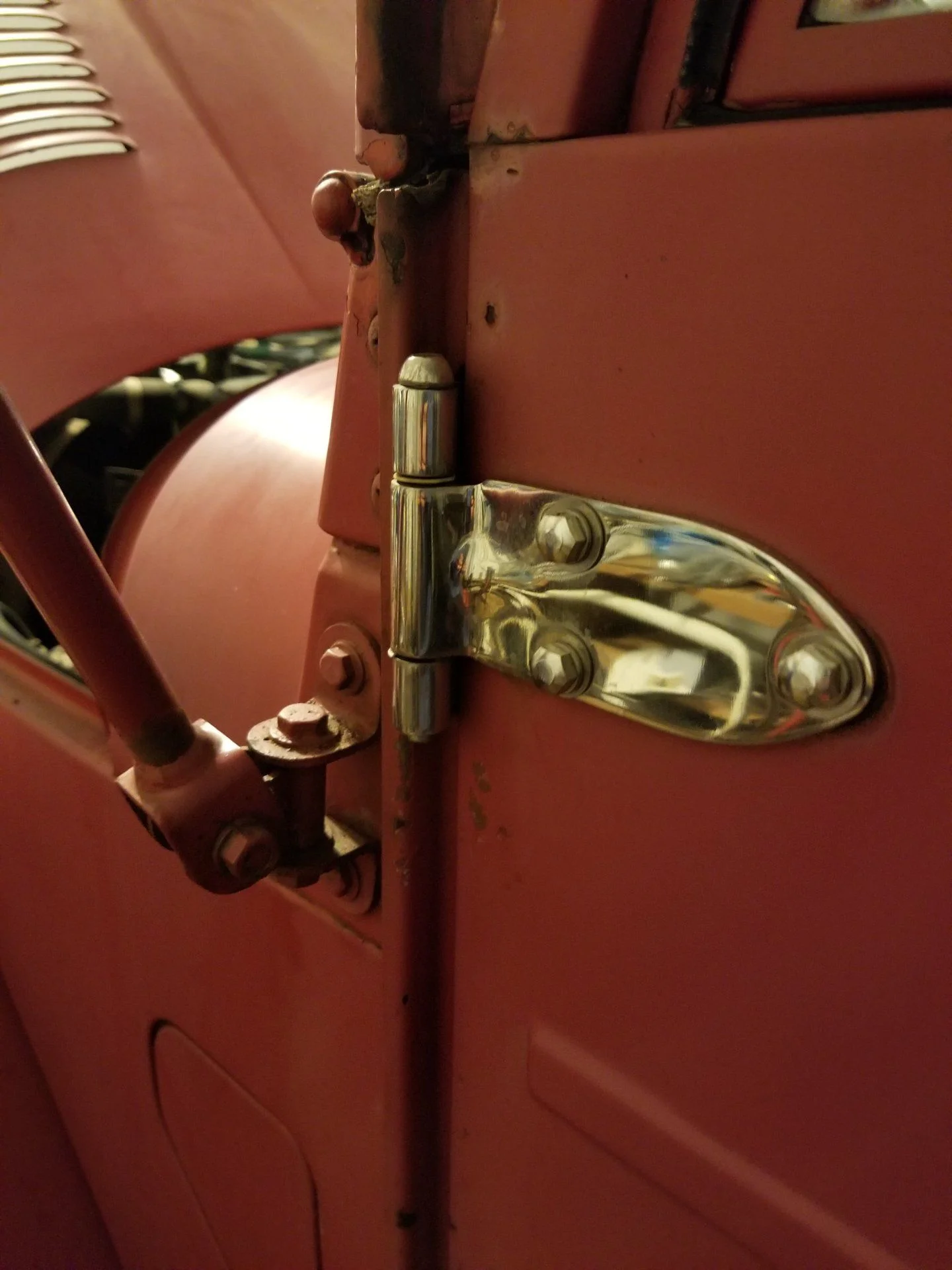

The PO's door hinges were a bit too flashy. @MadmanCruiser has some nice old
(maple leaf) red ones. I'm hoping to get 4 of these down from Oh Canada.

Talking about your wheels and tires, I’m dropping mine off to be dismounted today and the wheels will go to Schwab for sand blasting and powder coating later this week. Mine will be the stock low-sheen black. Will go back together with new skinny bias tires. I’ll let you know how the powder coating goes. It’s pretty cheap service, and I think there is a red as one of the standard colors, if you are going to go non-stock.

I want to match both the original paint, the second coat which seems to have matched the first, and what those paints have become. Am I crazy? Don't answer that. I like the patina, which is evolving as I free these colors from the old clear coat. I believe body color painted wheels were stock in 64-65. Didn't know Les Schwab restored rims. Will check them out.

Build date seems to have been January of 1964. A brass T-65 tag and VIN plate make it a 65 model.
Would it be incorrect for people to conclude that a "4" preceding FJ40 in a vin clearly identifies a FJ40 as a 1964 model?
What makes you believe this?
That is what The FJ4X registry says. And the tables there there pin it down to a build month of January 1964. I think maybe they just couldn't sell them back then and it sat until the '"65" model year.
i think you will find that the original finish on the wheels for your truck was satin black. Schwab calls theirs ‘flat’ but the sample I saw looks more satin to me. I should have mine back a week from Monday.

Found the "Color question" thread already asked and answered, and now I don't remember where I got the idea. Perhaps in a dream, as I do work on this that way sometimes. Thanks Oregon FJ, Old Red, from keeping me from screwing it up.
