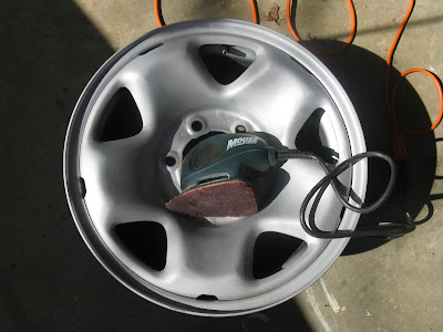

For reference, I bought some 05 Tacoma wheels and the stock silver color wasn't going to cut it. So, I took the Mouse out and used the red plastic wool pad to remove the clear coat. I didn't want to go all the way to the metal as I doubt I'd get as good a interface as the factory did.

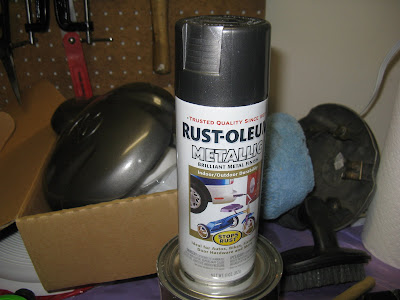

Once all the wheels and center caps were roughed up, I wiped them all down with mineral spirits and then applied the rustoleum. Metallic Rustoleum (Metallic Charcoal color to be exact).

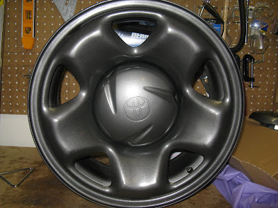

Applied 4 coats over 5 days. And now for the finished product:
Some notes. As we were installing the new valve stems, we noticed that the tool to do so scratched the paint some. I was hoping for a little better protection, but at least I can touch them up. Hope this helps someone else.
