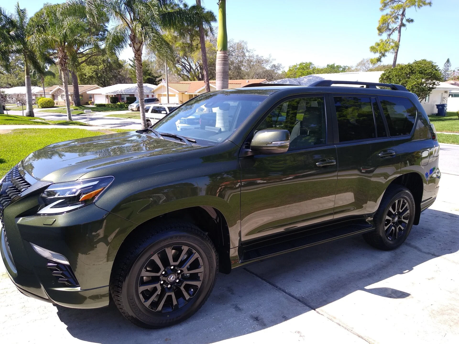

Well, I bought a GX 460 last week, I will just pay the extra and drive on.
Thank You guys for the information.
Tell us about it , what year , color and $
Picture would be nice , too.
A 2023 Blackline in the Nori Green. Getting window tint on it next week, and then a Curt Hitch. I am going to look into some skid plating for down the line. I got it at sticker. I keep hearing that this was the last year, so I made the jump,
If you're planning on skids later down the line, I'd also suggest sliders too. You can find some that will help keep a factory look and maybe even have it painted that gorgeous Nori green! Love that color. A set of bronze wheels would really set that off! (my .02¢)
Yeah, sliders as well. I want to keep it a bit basic for a bit. I do need the hitch and I am looking at a "trailer basket", perhaps by pack mule. I am in Florida and last year needed to evacuate due to a hurricane.
This would be a great truck to load up the family in and get out of town in.
