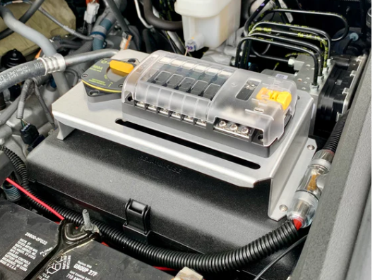

I stumbled across these guys and it got me wondering if there are any prebuilt plates like this out there to make it easy to mount a Bluesea box under the hood?
They said the Tundra option is flat and ight be easily customizable. It's a great concept. Hoping somebody has done it for an 80.
S.E.M.S. MOUNT Strategic Electrical Mounting Solution​
Looks, to me, as it's used as the battery clamp, or mounts to the battery clamp.
