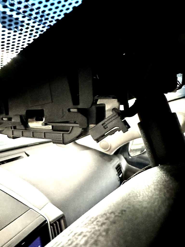

I plugged in my Bluetooth OBD2 reader and cleared the code using my phone. This should reset the cameras and get them working again , but for me the code and CELs just came right back, immediately.
I did fix this, though! Someone pointed me towards looking at the camera under the rear view mirror on the windshield. I had just had the covers for the rear view mirror pulled off to tighten the screw holding the rear view mirror itself in place, so this wasn't a bad place to start. This is what I found...
The camera was unplugged! It must've come unplugged when I was removing the covers. I plugged it back in and the OBD2 code and all the errors on the display went away, immediately. :clap:
