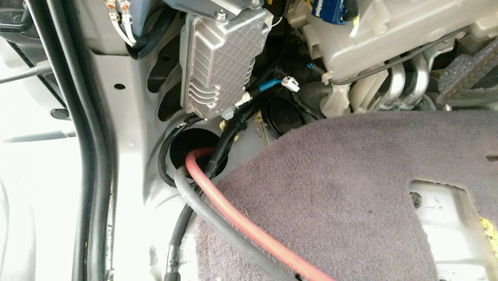

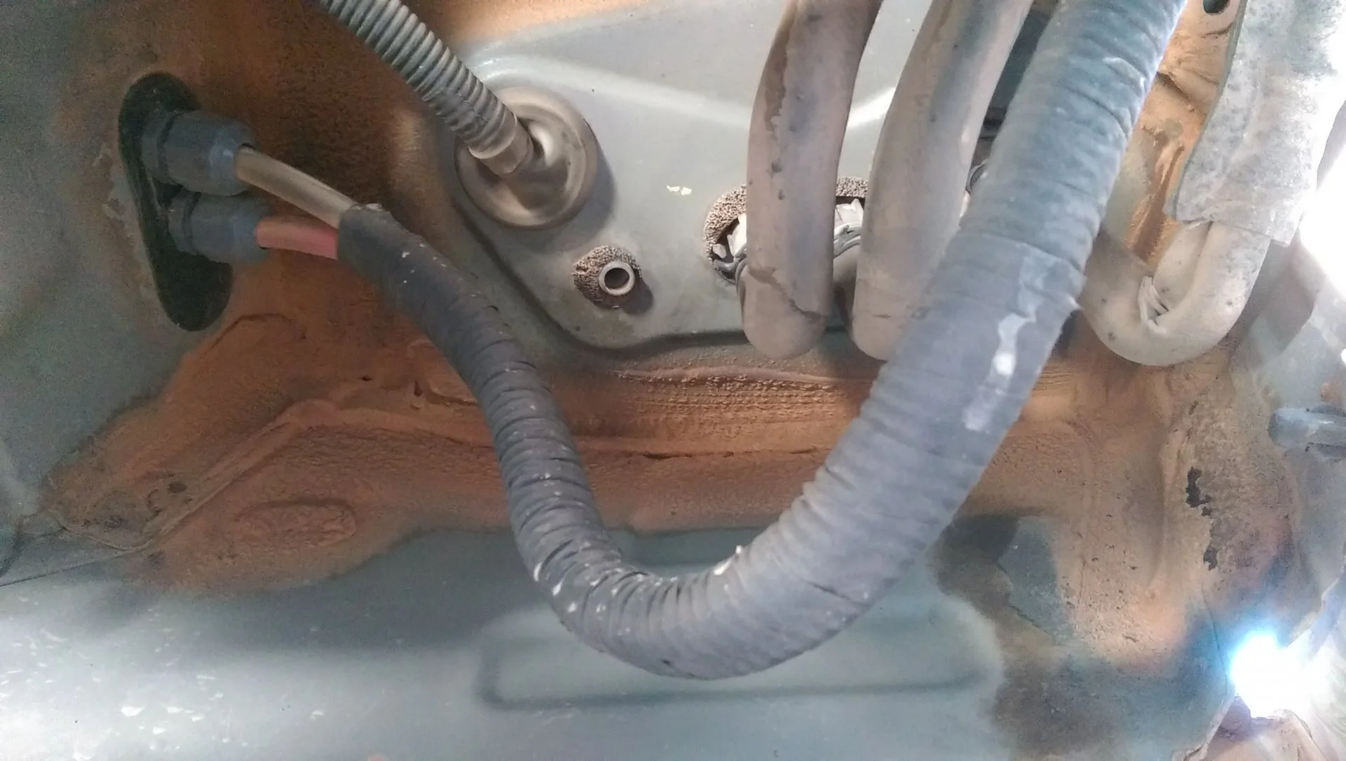

Power to cargo area - what guage wire?
Here is a grommet on the LC driver side just in front of the rear bumper and behind the rear wheel. It comes out under the plastic side trim piece so you'll need to figure out a way to get it out into the open.
Pair of 2awg.
