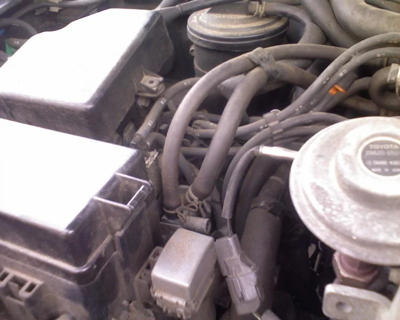

I was going through the FSM and it says that the the air control valve is what causes the idle to kick up when you are turning to compensate for the increase pressure needed at the PS pump. If I pinch the hoses, I should see the idle change. It doesn't.
So, if this is the issue, how do I fix it? It appears that there is a place for a hose to go into the plastic peice that the hoses meet in but Im not sure and that just sounded confusing. The FSM doesn't really show this in detail (that I can find atleast).
John was saying the meeting he thought it was the steeringbox since thats what happened to his way back. Hopefully not, but we'll see.
I'll post a pic up in a minute about what part I'm talking about. just need to upload it.
