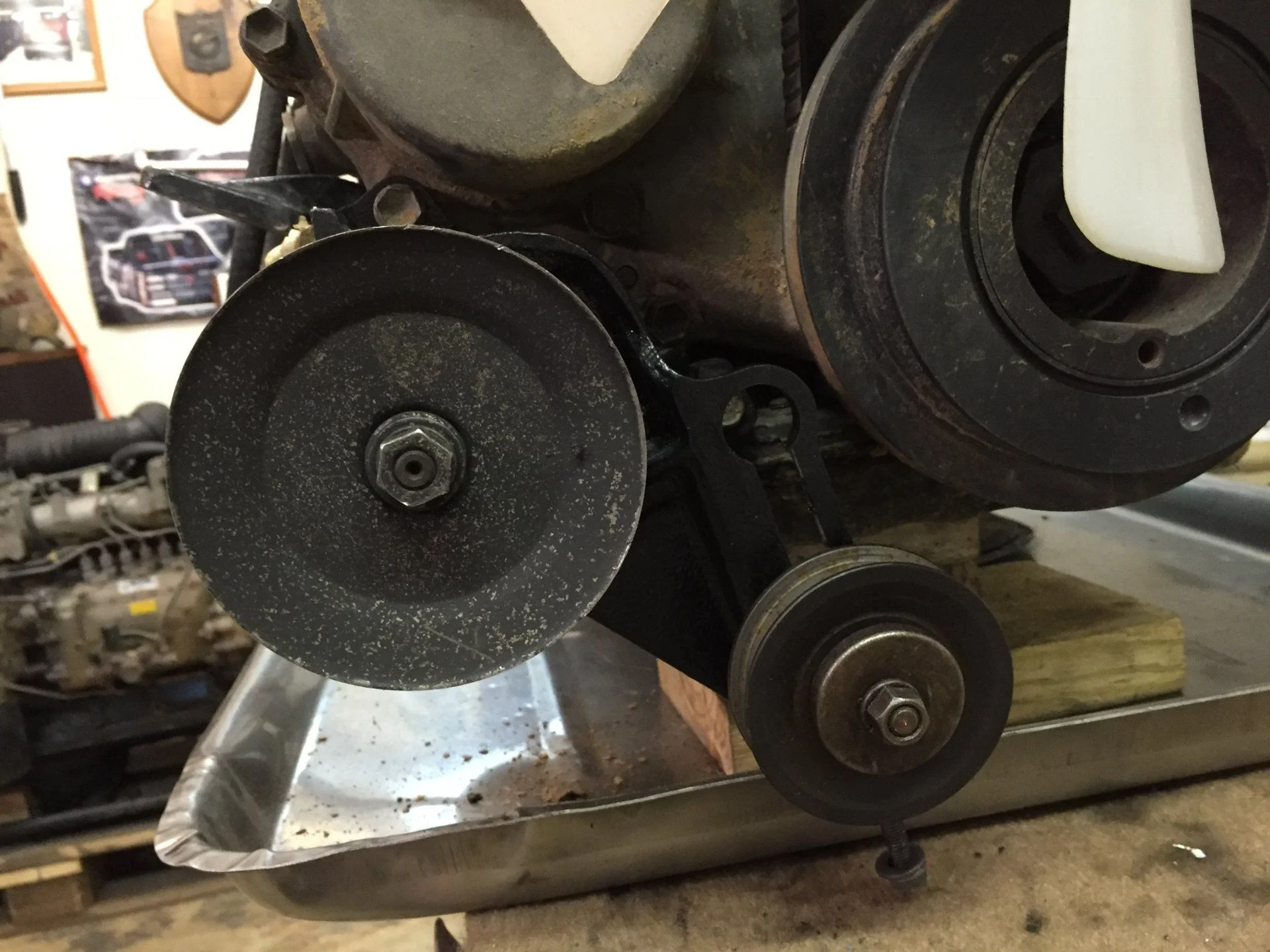

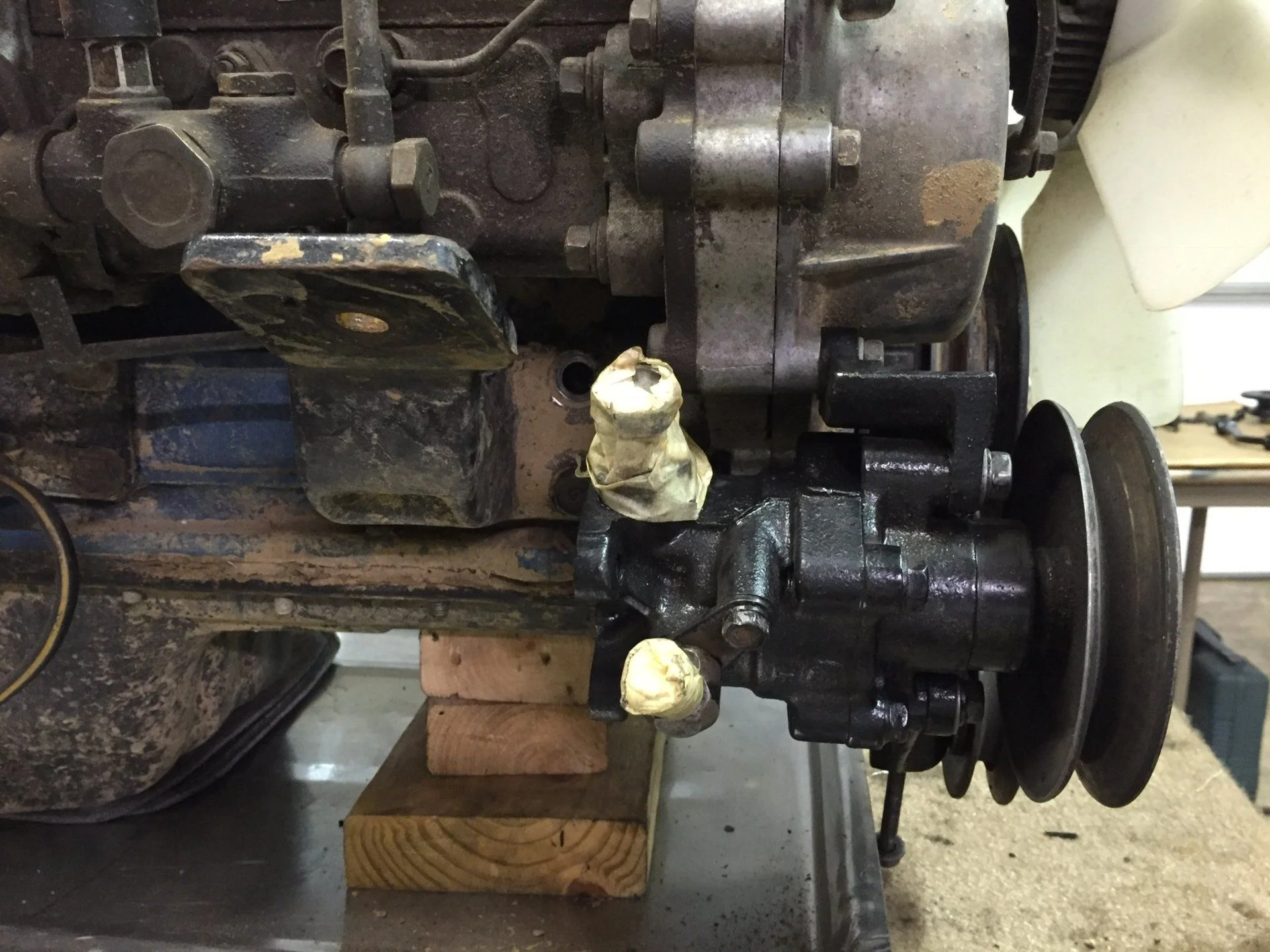

Apparently some did here is the proof. It’s not obvious but the PS mount is actually part of the right motor mount.
Oh that's great thanks for showing me. I guess I need to try and locate a harmonic balance/ crankshaft pulley.

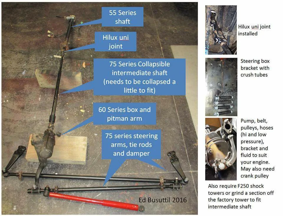

No LWB diesel came factory fitted with power steering but this conversion is extremely common down here. It's essentially a 40/60/75/80 Frankenparts deal that by pure luck [or good design?] fits together in an OE way. I have the conversion here in a .docx if you want it? Can you attach a .docx to a Mud PM?

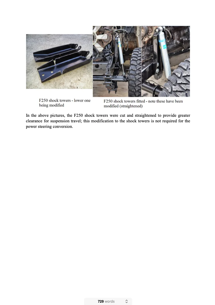

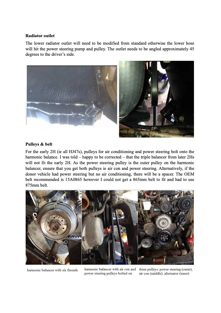

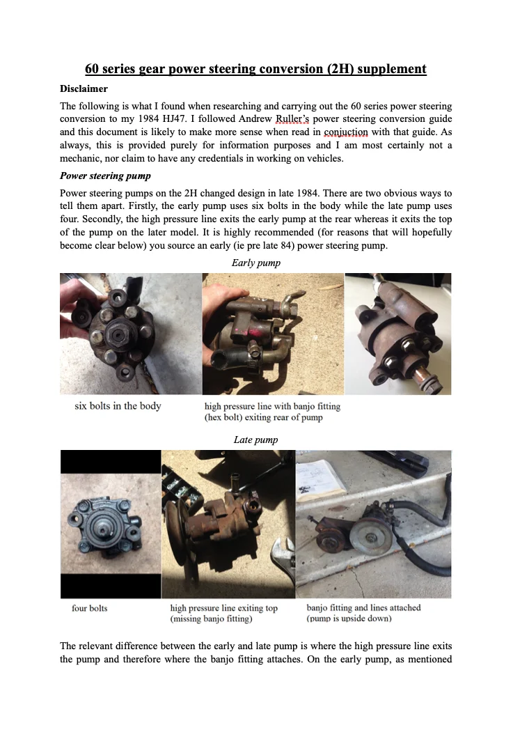

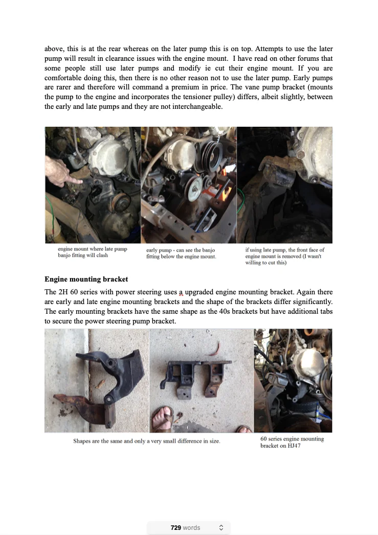

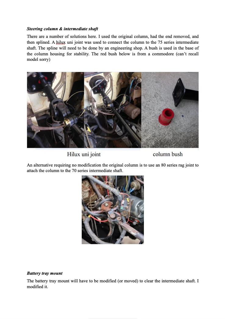

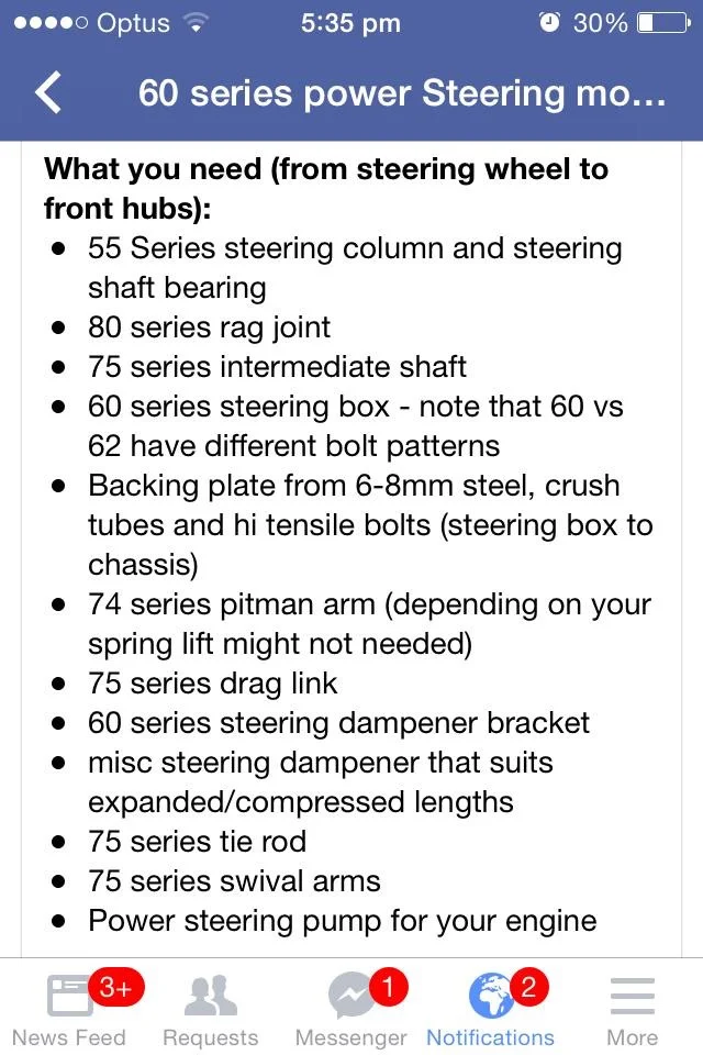

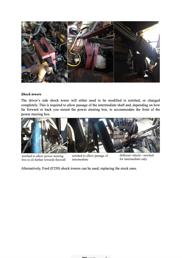

@NOSAJ / @jatatar / @afsiddiqui here's the doc. It's designed for a 2H into a RHD HJ47 chassis. Its a guide to be used in conjunction with the parts list in the next post. There's some 70 series parts which are readily available in Au, but I'm sure they can be shipped to countries that are light on those trucks. Happy converting!
Oh, one last thing. At the firewall there are two options: a] an 80 series rag joint or b] a 70 series/Hilux universal joint. I went with the uni as it's more direct.
One last thing Part II: My truck is a 1970 FJ45 so it had the one piece column and steering box. I think the changeover year to the two-piece design that ran til 11/84 was 1972. Anyway, if you have this type you will need to cut the shaft at the firewall and spline it for the 80 series rag joint/Hilux uni. Because of the OEM design of this system you will also need to retain it's fore and aft movement somehow. There is additional fab work required to do this. I slipped a bearing over the shaft [slight flap dic relief required] which then presses into the outer tube. I had the shaft machined to accomodate two snap rings to hold the bearing in place. This is the same design as the 08/1980 onwards steering columns. If it's good enough for Toyota it's good enough for me.
