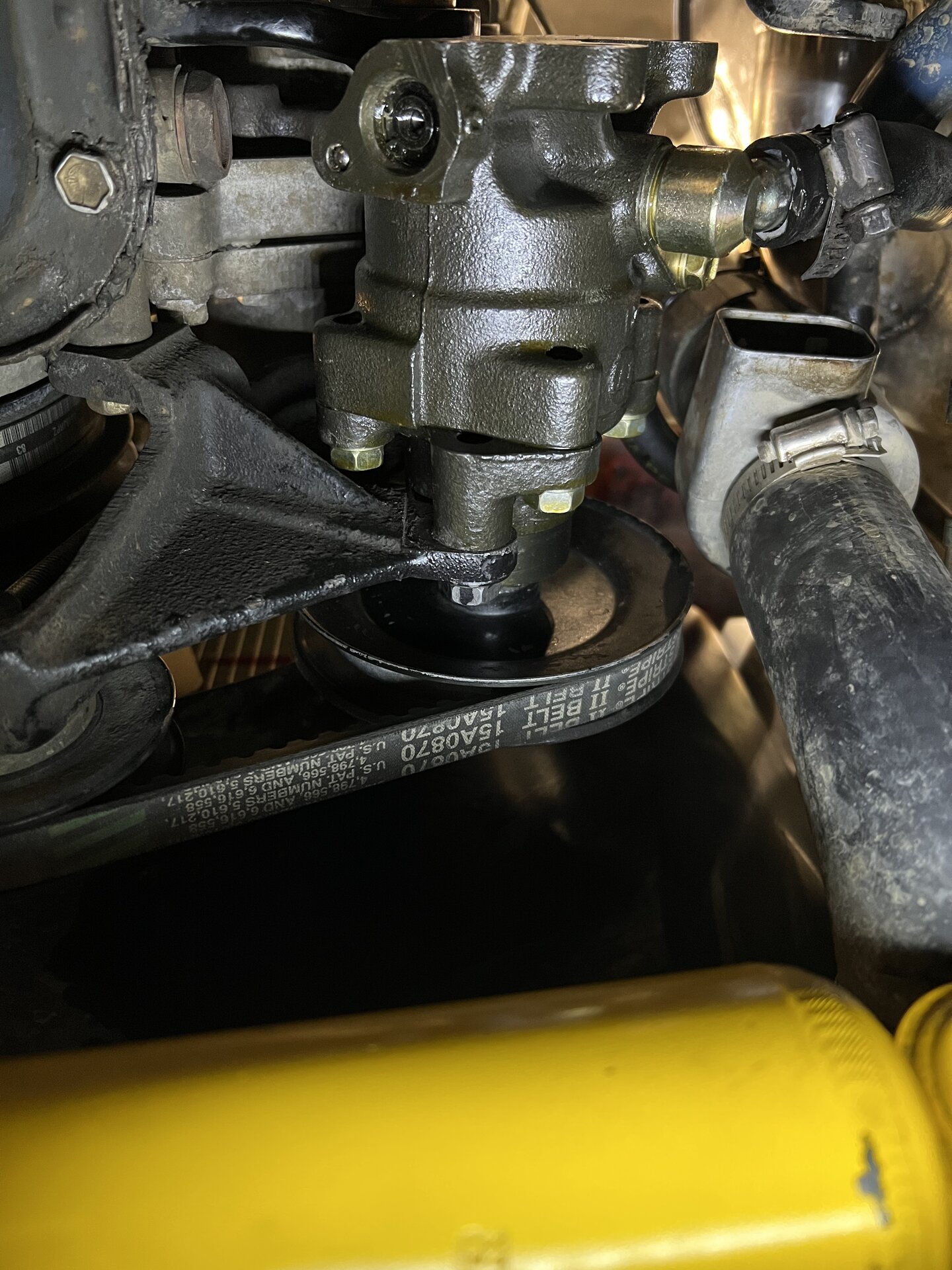

I figured, just noting that for future people's searches really. I think honestly any quality ATF would be the way to go, but since the Toyota brand is within $1 of Mobile One and others I figured go with Toyota. Mine was very dirty too. @Felde 's flush technique was definitely needed.
