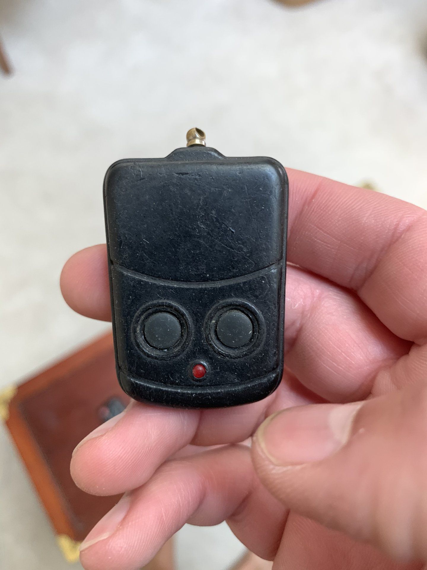

This is the non-working fob. No brand mentioned on it.

FYI, I think I fixed this issue over the weekend. There was a small circuit board inside the drivers door cavity that had been spliced into the Door Lock Control Relay. I assume that was the received for the remote. Doesn't look like it was an actual security system, and more just a remote lock/unlock system. Once I removed that, it seems to be working as normal.
