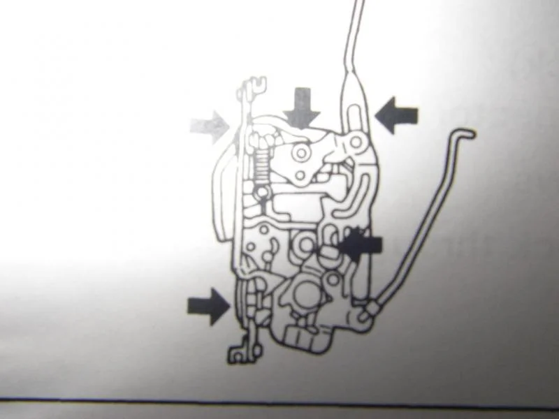

Just had this happen last weekend, my problem was a broken spring that is supposed to keep tension on the handle/lock mechanism inside the latch. the first picture in the above thread (I think) shows the top of the mechanism; I had to peel the top of the door panel off and use a wedge to allow a probe and light down inside the channel for the glass. With the probe (12" screwdriver) I was able to push the mechanism together and open the door using the handle like normal.
of course I have no pictures so my anecdotal evidence is worthless....:rolleyes:
However the spring is shown in a picture in the FSM that I will take a picture of now and post in a bit..FSM picture BO5179; involving where to grease the latch/lock, in BO, page 12.
(edit: sorry, digi-cam batt just crashed and charger is at work)
Anybody able to come through with a picture? I can't get back to the office till middle of next week.
got it after all
seems downloading takes minimal DCV, here you go: my broken spring was in the top left corner per the picture, I was able to source one at an industrial fastener supply.
HTH

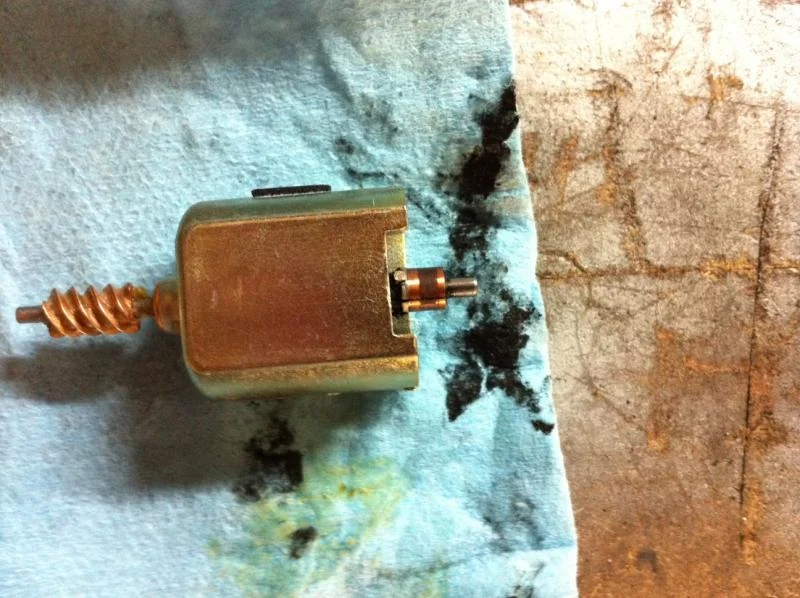

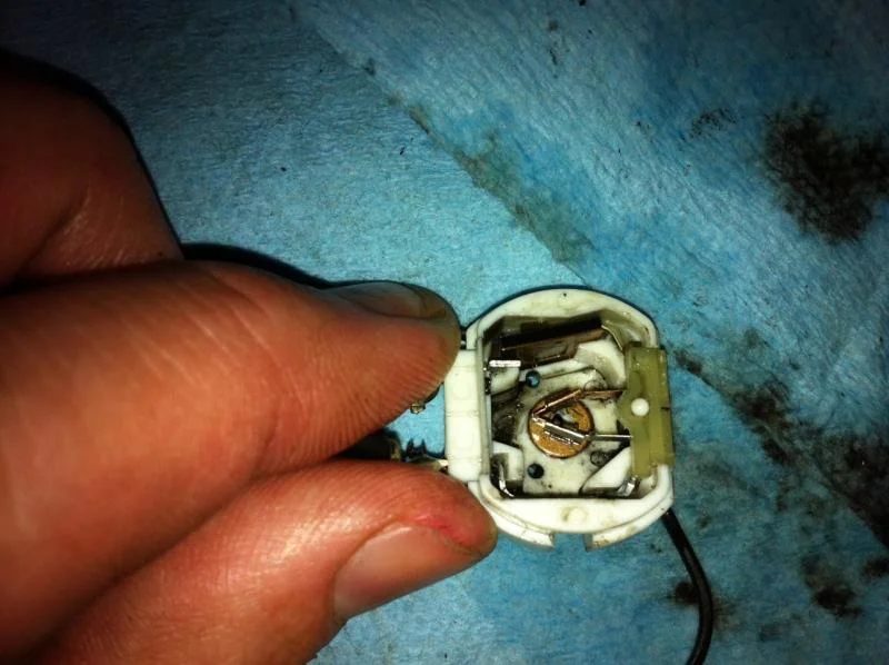

So I read through this thread and the full 13 page thread in the 100 section. Buried within the 100 section thread was a post by "ubiquityman" who had success by taking apart the small motor and cleaning it. Since I didn't have a new motor on hand and I'm not even sure which one to order for the 80 series and I'm not as talented as "cartercd" to weld a nail to the end of a motor shaft, I figured I would give it a shot.
It seems to have worked. After 2 years of classic symtoms, the lock is working great now. It appears that grease and crud had collected itself onto the commutators and brushes of the armature. With a little WD40, paper towel and a small screw driver I was able to clean it up substantially. Here are some before and after pictures to help you if you want to try it yourself. Note all the grease/crud on the paper towel in the background. I'm definitely gonna go this route on the other locks as they have issues. If I find one where the brushes are too wore out, then I'll try ordering another motor. I hope this info helps...

Yup, just clean it! See my above post and pictures...
Looking at the above pics of the motor brushes, those are probably at least 75% worn away at this point. Given how old these trucks are, you may have given yourself a few more years of service by just cleaning them up. Nice!
When I replaced the motor in one of mine, the old brushes were down to zero.
