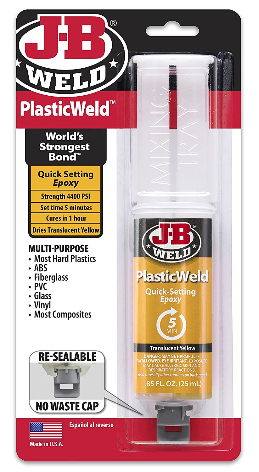

I have had good luck with Plastic Welder from JB weld. Stuff holds like crazy with any plastic I have used it on. Only thing it turns kinda milky yellow but man it holds up great, good flex and rock solid bond. I have used it on roof top boxes with great results...
Thanks man, I'll try that instead! Did you find the set and cure times shown to be accurate? The color you describe is pretty much what's in there now.
My experience here the non-humid west... it set up quick and was rock solid. The times were accurate in my experience.
