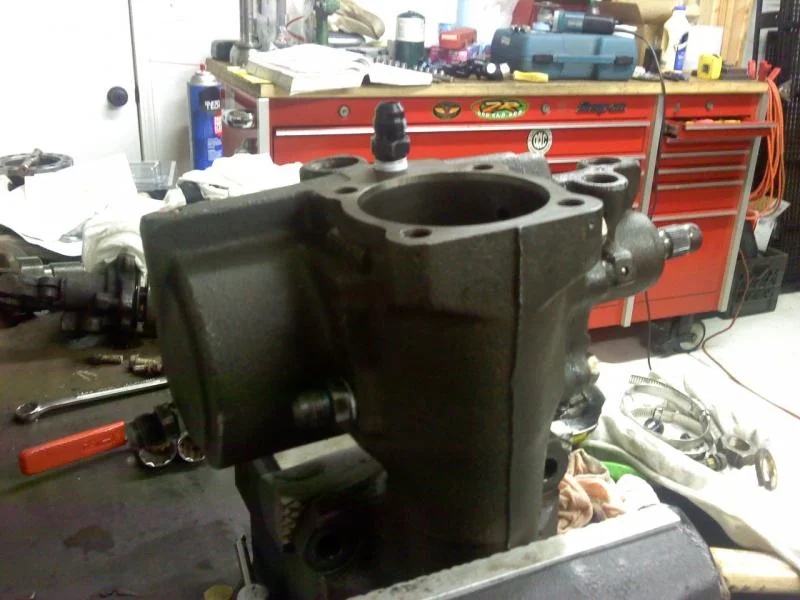

Beno was kind enough to snap a pic of my box before it was assembled and installed. The second pic in post #71 (and below) shows the locations I tapped to best fit on the 80. The forward fitting in the Marlin thread is a very tight fit when the box is installed as the brake lines have a support mount in close proximity to the front side of the box.

Note: (as copied from the Marlin thread)
FJ80 Box - Top/End hole has pressure when turning right,
FJ80 Box - Side hole (TOYODA) has pressure when turning left.

I saw that one but i heard you were supposet to tap into that vein on top of the box, next to the adjusting screw, does it matter?
It doesn't matter, either the front or the top of the box will provide pressure for turning right. If you do tap the front side make certain you check the clearance between the fitting and the piston as I found when installing the fitting on my box. I removed .125" - .250" of thread due to how I tapped the casting.
