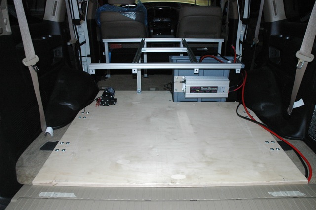

The "usual heavy duty battery setup" many of us did use may be arround 35 kg, if we use a small battery with 95 AH (most use 100ah or 200ah Batterys in the rear)
26,40 Kg Battery (if using a small 95ah AGM Battery)
3 Kg Inverter 110/220
5 kg Cables
1.5 kg DC / DC charger, booster
1 kg 220v/110 Battery charger
1 kg Solarcharger with cables
Because of the weight and also the space my built-in Power-Setup need, I look a long time after a better solution arround.

That it is so much lighter and lightweight - is very very nice, compared to our built-in Setups like mine:

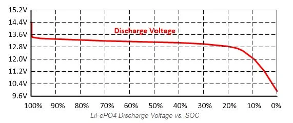

And this is definitely nit-picking:
But I use 13V to convert watt-hours to amp-hours so 768/13 = 59Ah. And discharge below 15% of capacity is not good for battery life but it can be done. But yes you are correct overall the LiFePO4 chemistry bests lead acid by a very large margin.
Thanks for calculate - so 50Ah is really usable at my probaly future setup without hurting? Pretty comparable to my current builtin 95AH AGM Setup.
