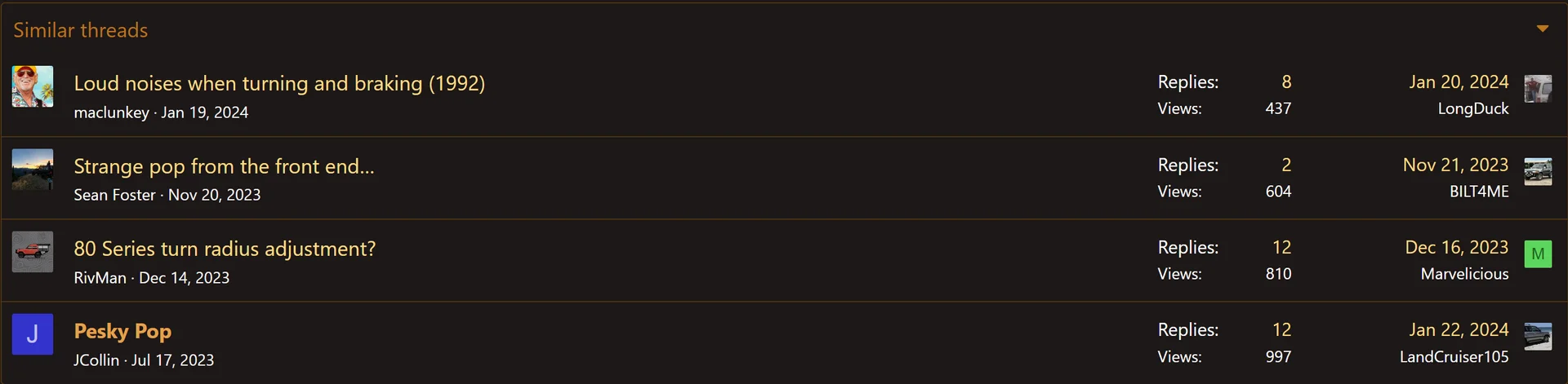

IH8MUD will post similar threads to your below the bottom of the post. E.g.:
This can jump start a thread search.
