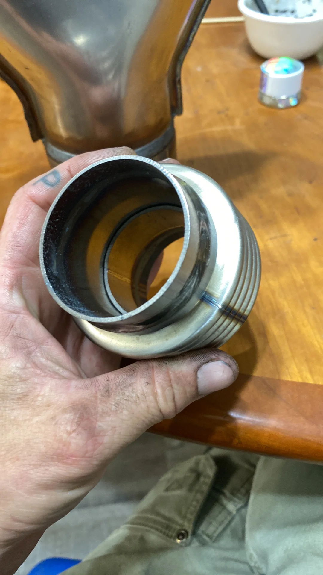

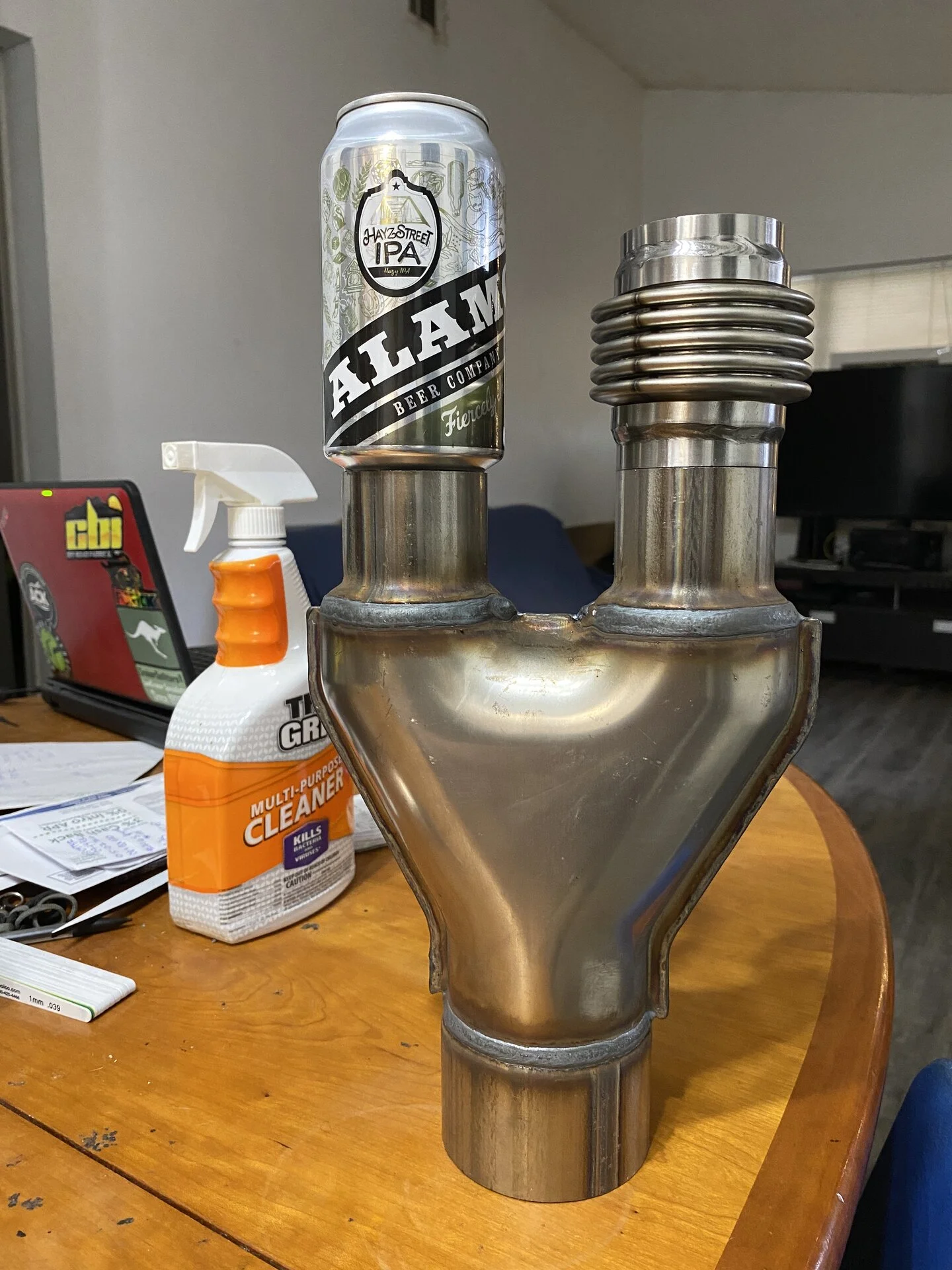

Well, it’s gonna be nice to have no exhaust leak. I got some 2” v band sets ordered. I honestly need to order some 2” resonators. I also coulda probably stepped the pipe size up, but who are we kidding here? The name of the game is clearance and no leaks, so sticking with 2”.
The bellow is a nice little piece! Much better than anticipated. My OEM one is SUPER cracked. Held together by rust and prayer.

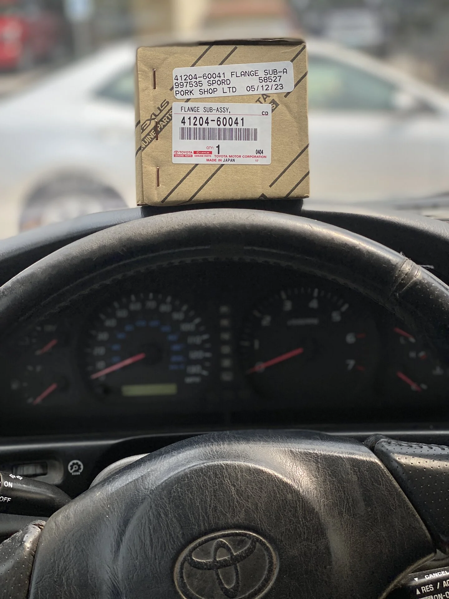

Also, my 29 spline flange showed up today! I reckon I’m gonna have to get to some gettin’ this weekend. Supposed to be rainy, so sounds conducive to not effing off priorities and making this an actual priority.

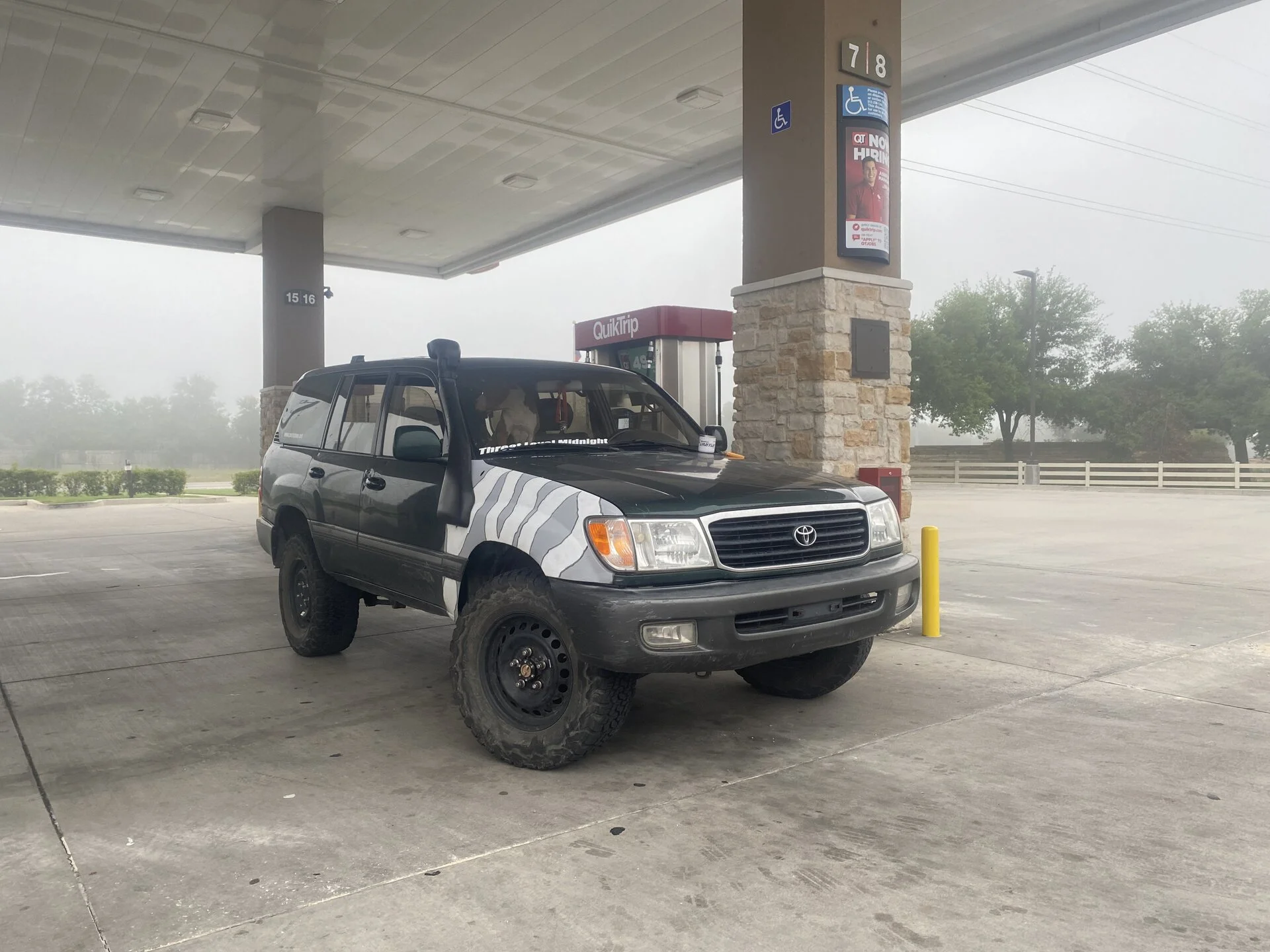

32 DAYS UNTIL GSMTR 32!!!!
I really gotta get in gear. This morning’s fog in Central TX has east TN heavy on my mind. This thing ain’t ready for 2500 miles as of right now, nor am I.

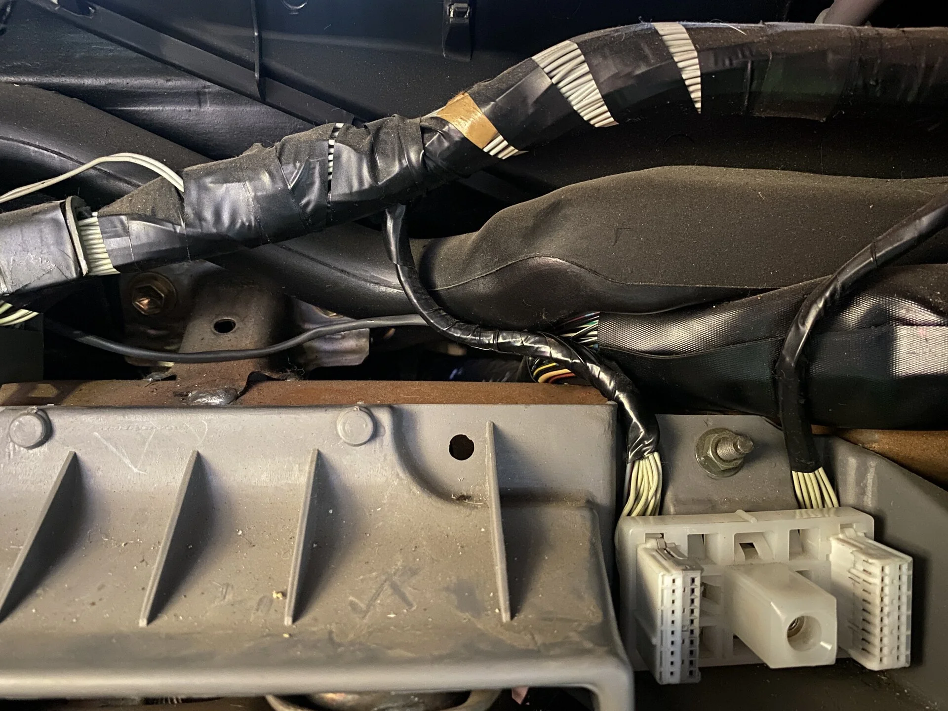

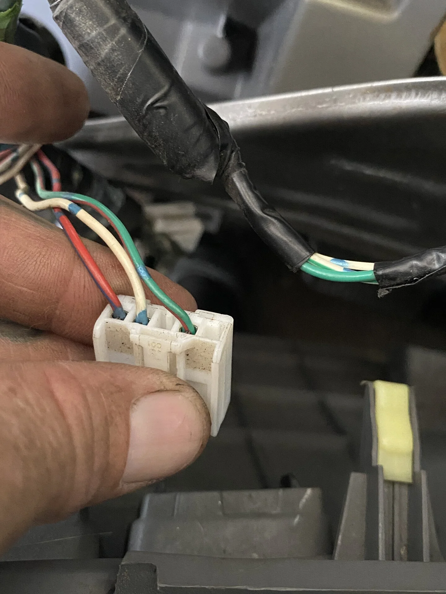

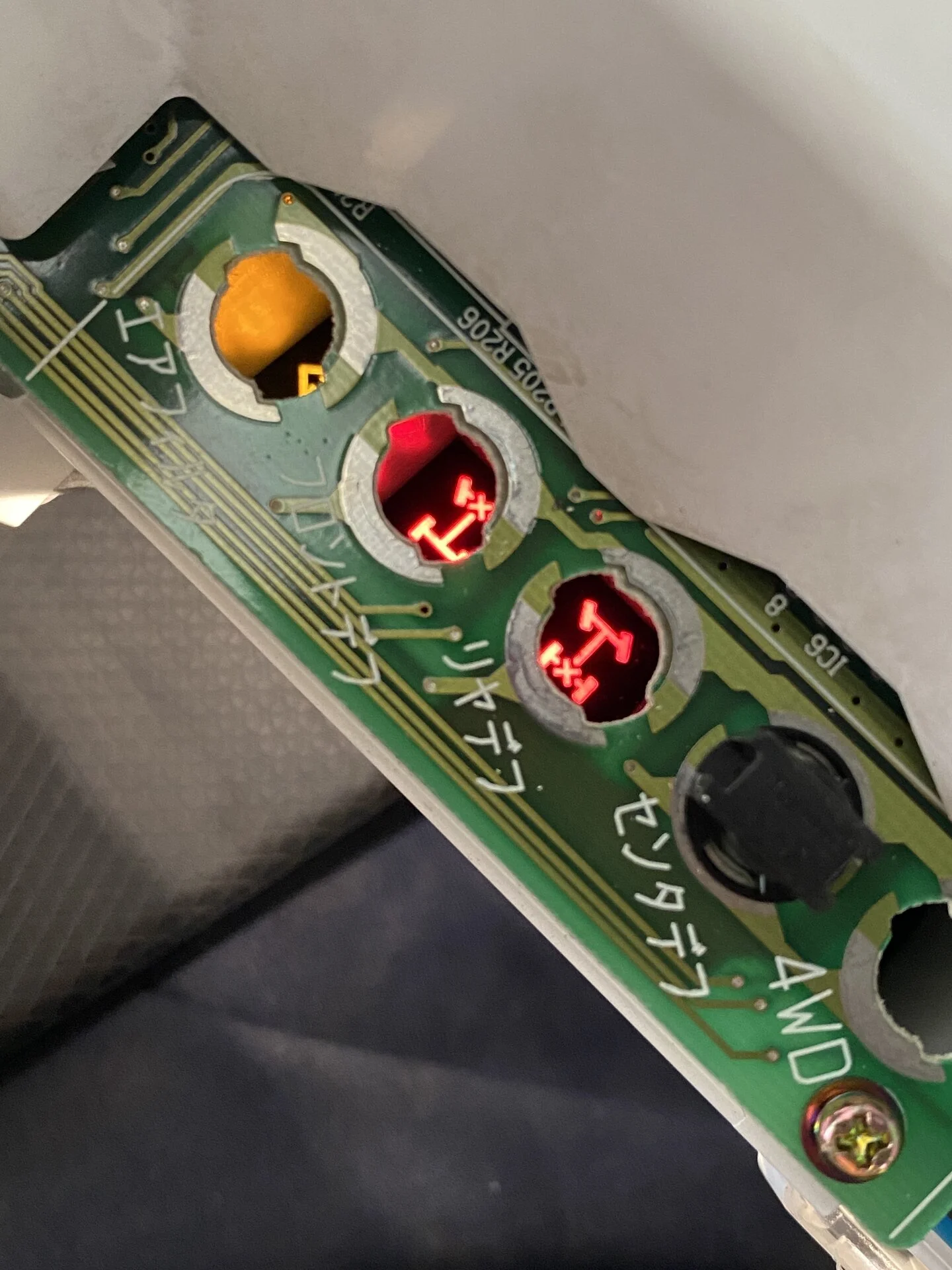

I think this is gonna be today’s project. When swapping the 80 series locker switch in I noticed pin 2 was already in my harness. Well I’ll be damned, Toyota! You wanted us to have a 105, who screwed us?!
That led me on this hunt and it did not disappoint!
One thing I’ve always disliked is aftermarket toggles and clutter on a dash. I know things gotta be added at some point, but I don’t want a space shuttle. I’d like to keep The Jetson’s on the ol’ tube and outta my cockpit.

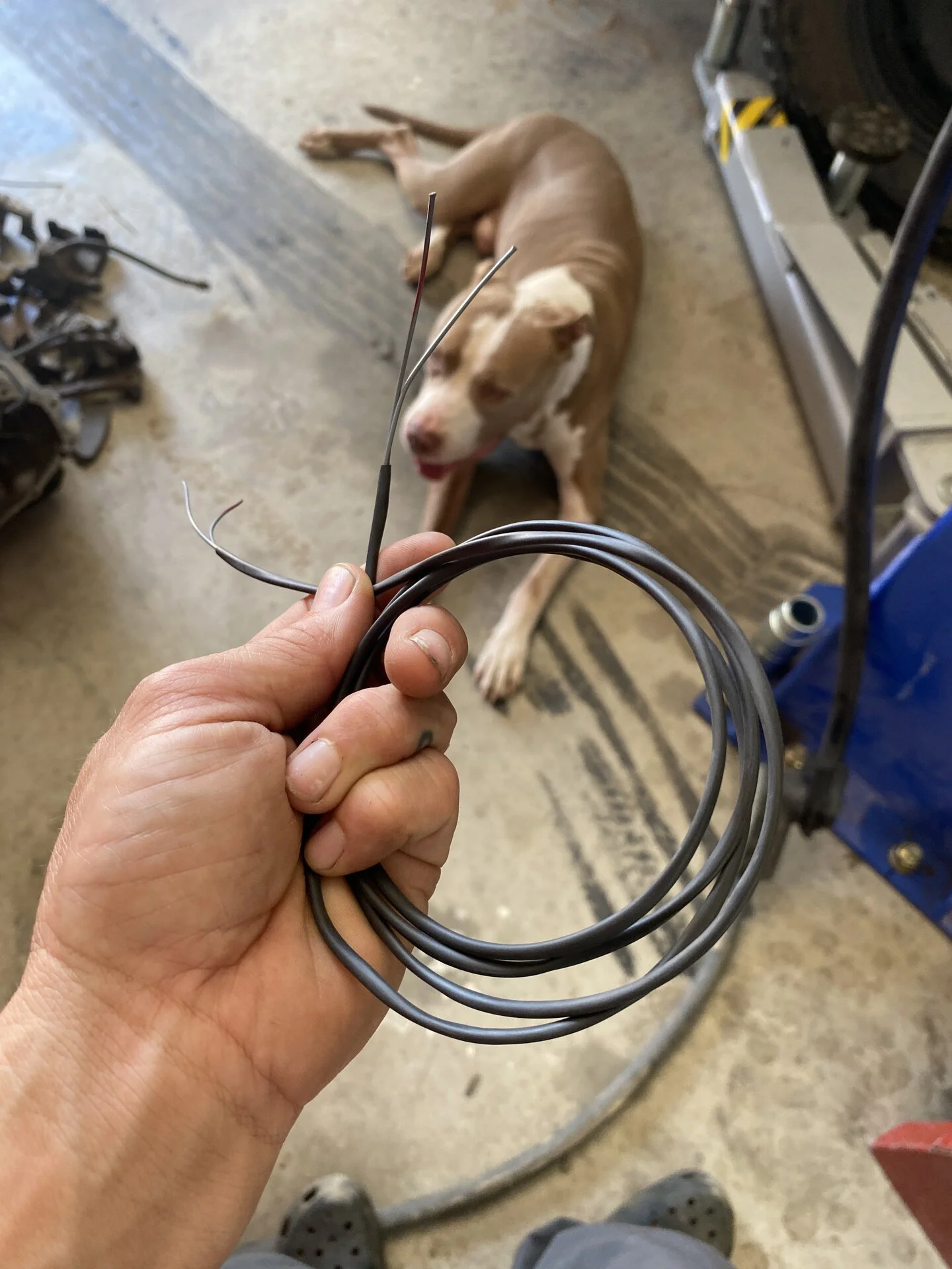

Went ahead and robbed Peter to pay Paul by way of some terminals to make my sub harness for the dash lights. Some milspec tefzel 20ga wire and heat shrink was the go-to here. Pictured is the cold side of the rear locker indicator that makes its way to the passenger kick panel. Welp, no locker ECU means I don’t need this circuit to take that ride, so I pulled it out, and got rid of it. Replaced it with two terminals that Toyota was kind enough to load in the connector for me that wasn’t being used. Took a little finagling to get them out, but overall fairly simple if you’ve played with stuff like this before. You can see the wires I ran in the connector ready for reassembly into the housing.
And the light harness. Grey for the rear, grey/red stripe for front. Bonus pic of a Beefy Good Boi.
And terminated and run through the dash, awaiting its marriage with switch and lockers.

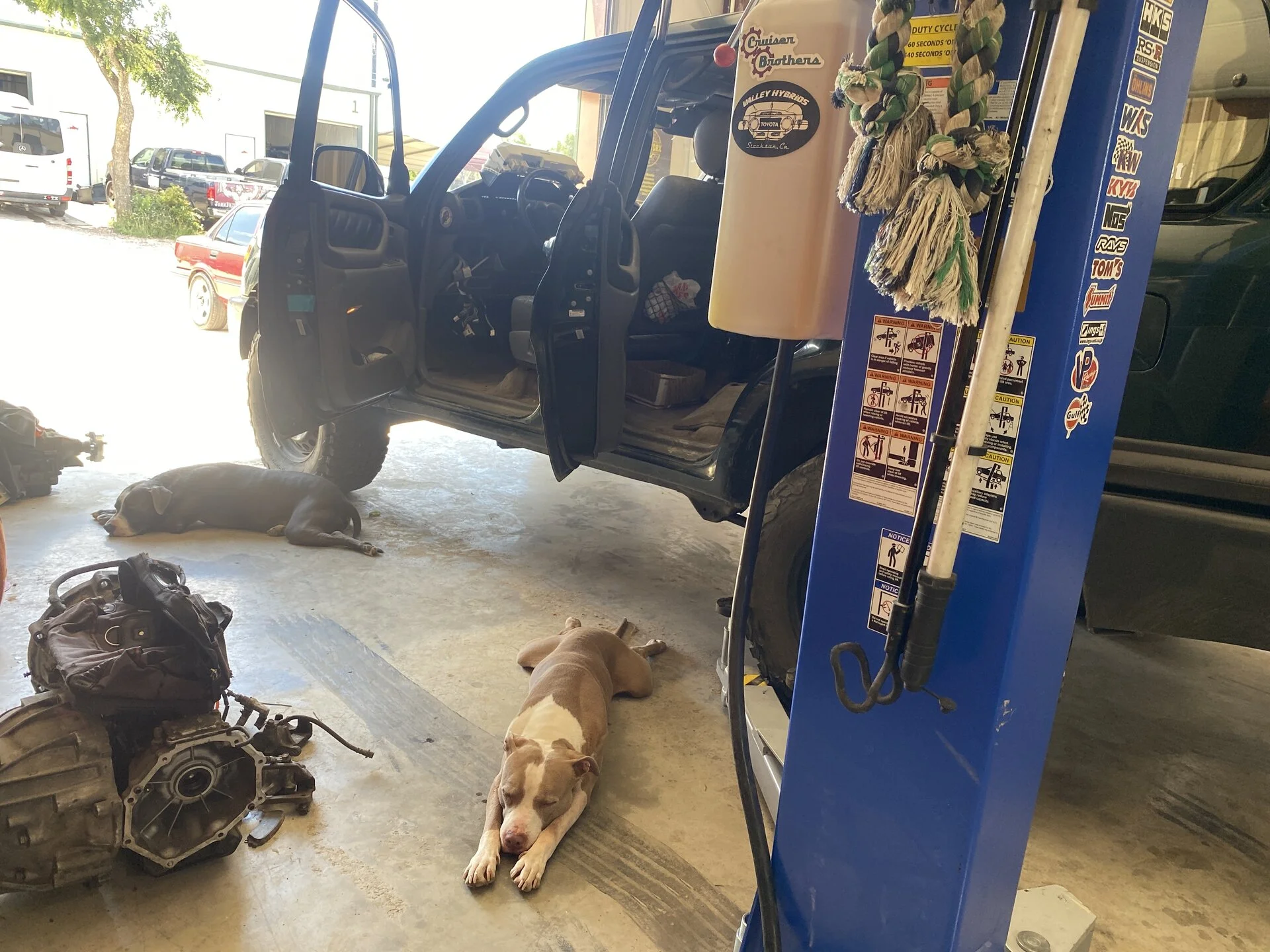

Welp, the Boy smacked some s*** i explicitly said “Hey don’t smack that” about. Proceeded on turning right towards it and smacking it while I stood three feet away. The look on his face was about spot on to Navin R. Johnson’s when he realized the oil cans at the filling station weren’t defective. It’ll cost me three grand to appease a third party, but the lesson for him was invaluable. The character he showed in the moment absolutely made me proud and I made sure to let him know this isn’t a big deal as nobody was hurt and things can be replaced. The only way it can be a big deal is if we don’t learn from it. We had a yarn about what he feels his strengths and weaknesses are behind the wheel and decided we’ll work on strengthening those skills individually in a targeted manner. I know it shook his confidence but tomorrow he’s got that forty minute drive ahead of him the same as today, and the day before. Besides, we still have a long way to go until GSMTR ready and Toyota Boot Camp is about to be in full swing to make that happen.

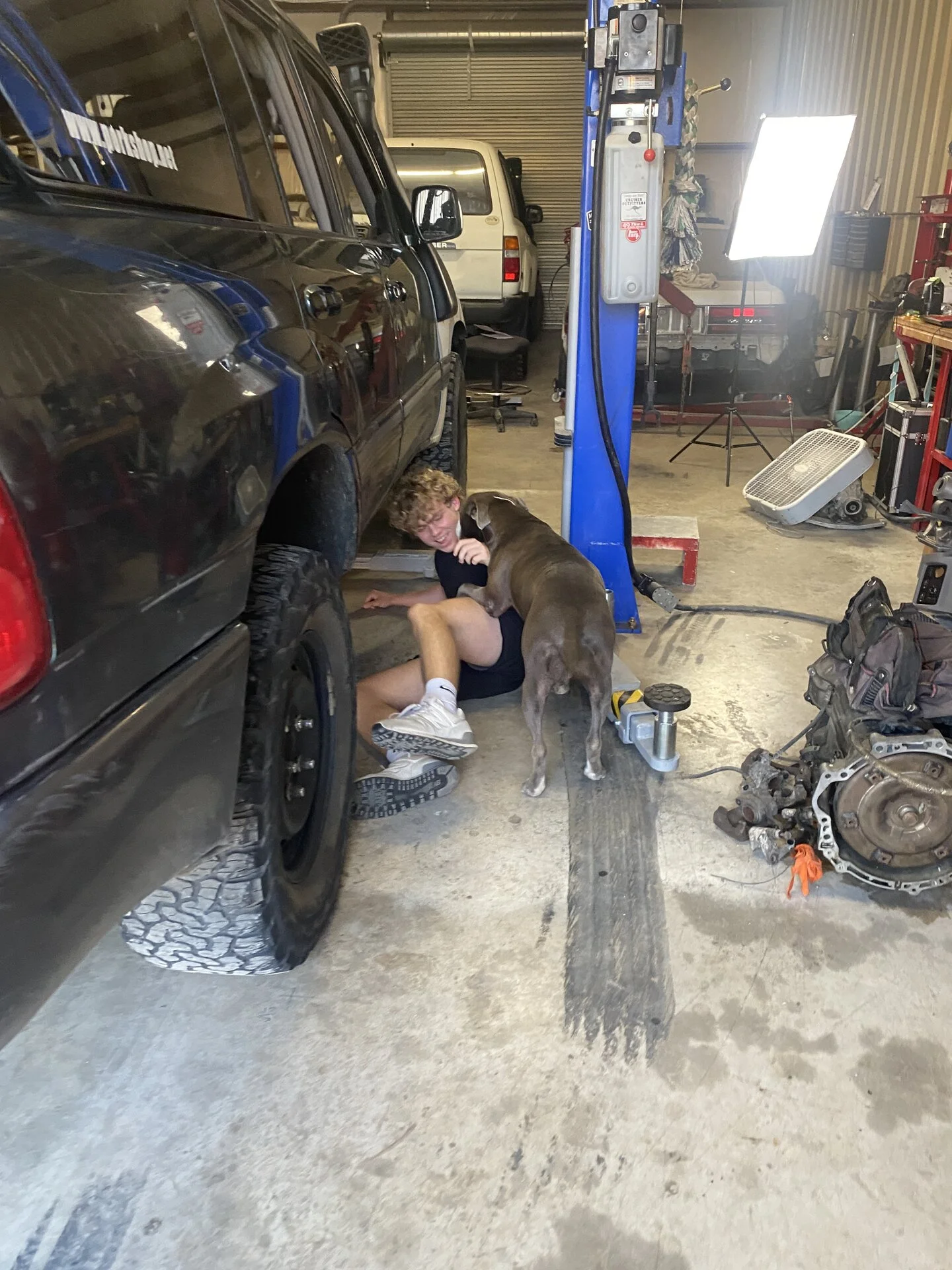

Moving on, I got him to rack the truck. PigPig taking every opp to swoop in for some love per usual. I had been hearing a click correlating to braking and knew it wasn’t the rears as I had just went through those when sorting the loose e brake. My dead ass was thinking it was the driver side, but after riding shot gun we went after the front right caliper.
Essentially it just needed to be cleaned of debris with a wire brush then thoroughly lubed. Seems to be sticking slightly on an edge of the inside pad and slapping against the rotor when brakes were applied. Retracting the pistons led me to believe there was no issues there as the process was linear in motion so we cleaned up everything and went back together as these pads are good for the trip. Cleaned up the slide pins on the bronze wire wheel and lubed ‘em, ready to go.
And back together. At least if we don’t get to make it to GSMTR I can blame it on his work, yeah?

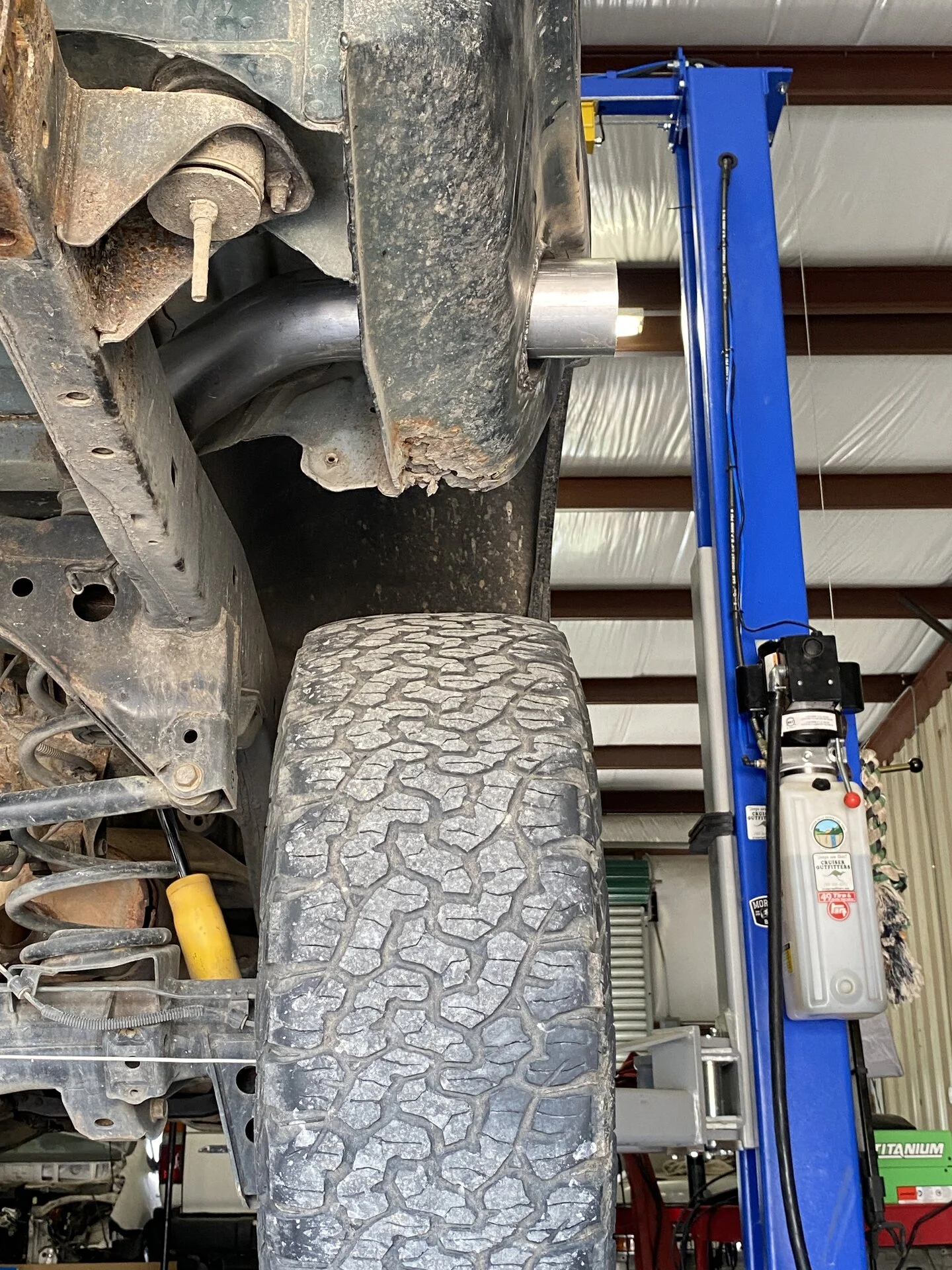

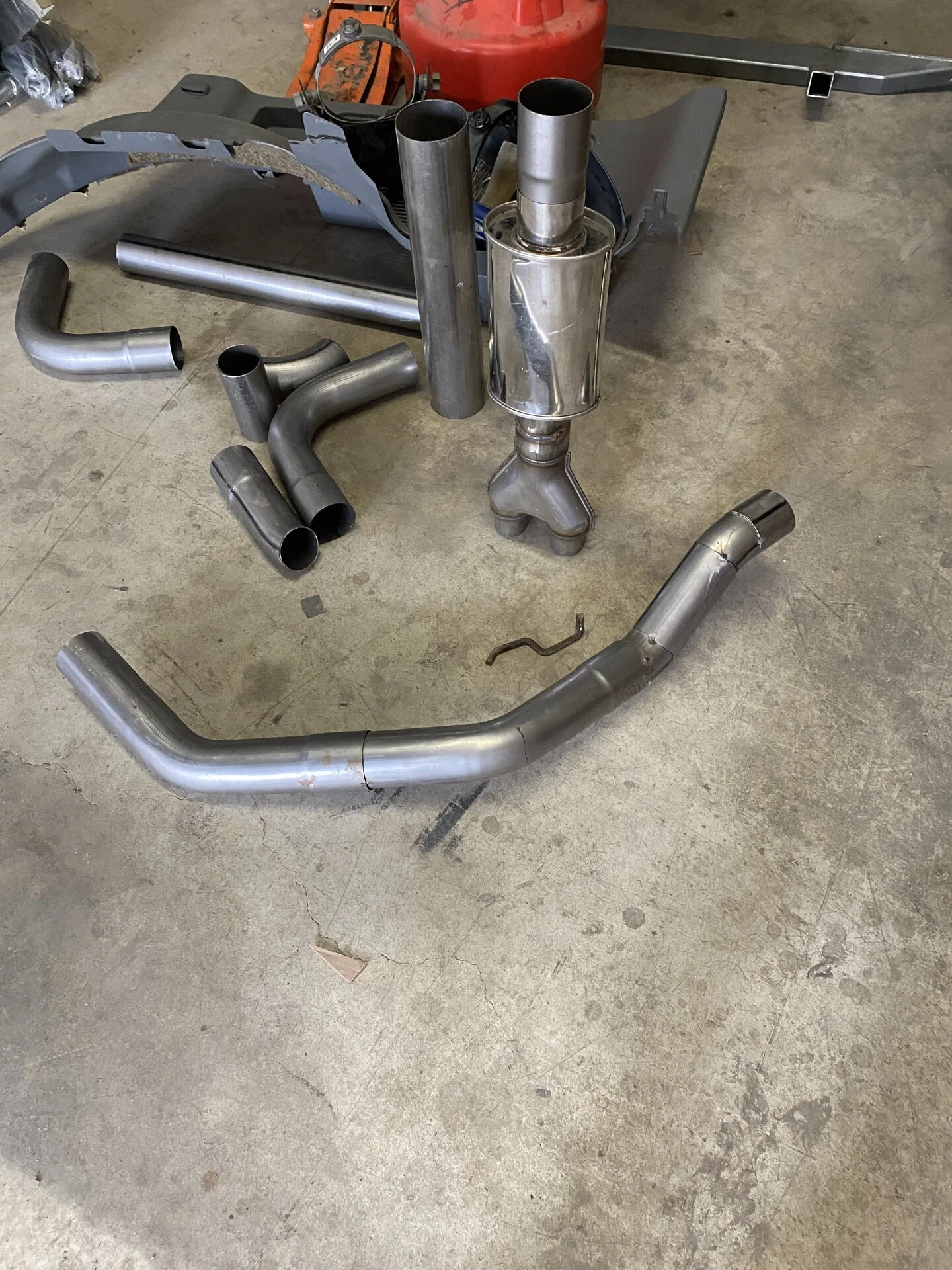

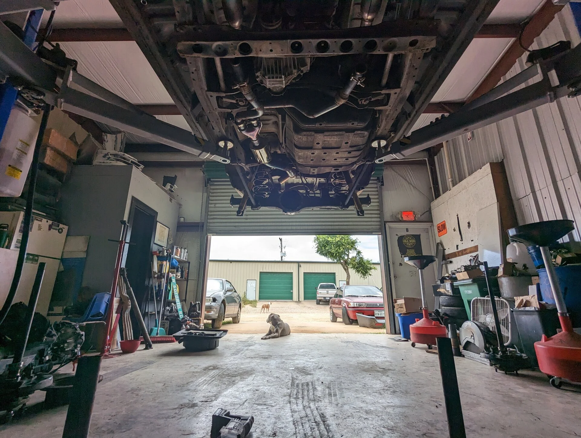

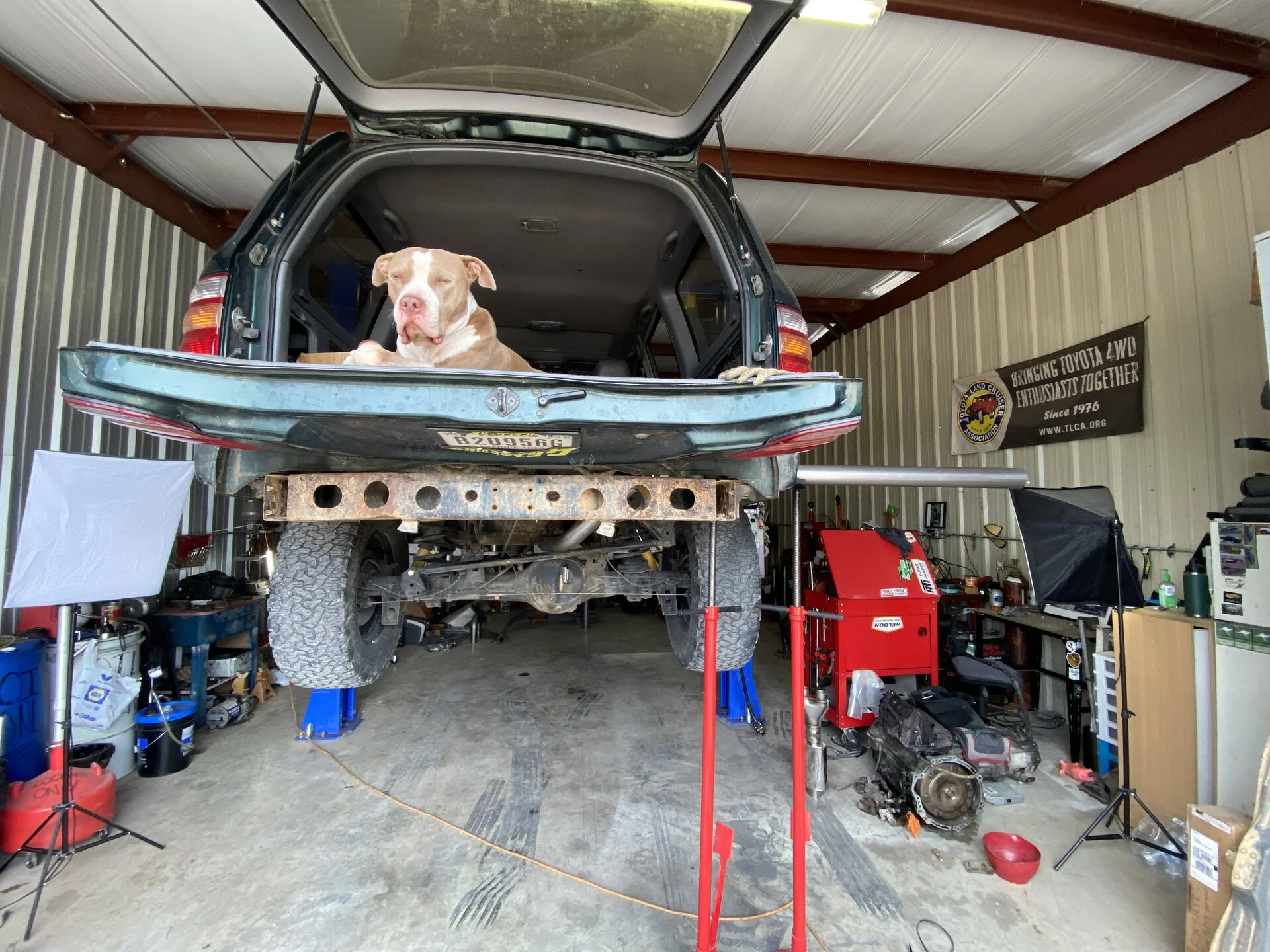

When I said I wanted my exhaust tucked, I’m talking Lt Einhorn spec tucked. So I started with where I wanted to end.
Needs more tacking and grinding but the dogs and kid were bored and frankly so was I lol. 4” pipe through the body as a sleeve so I can run my 3” through it and put the side of the bumper. Just don’t want the exhaust drone or exhaust fumes coming through my rust holes, and don’t want it to get smashed like the old one did right off the bat. FWIW I only caught the sound deadening on fire twice.

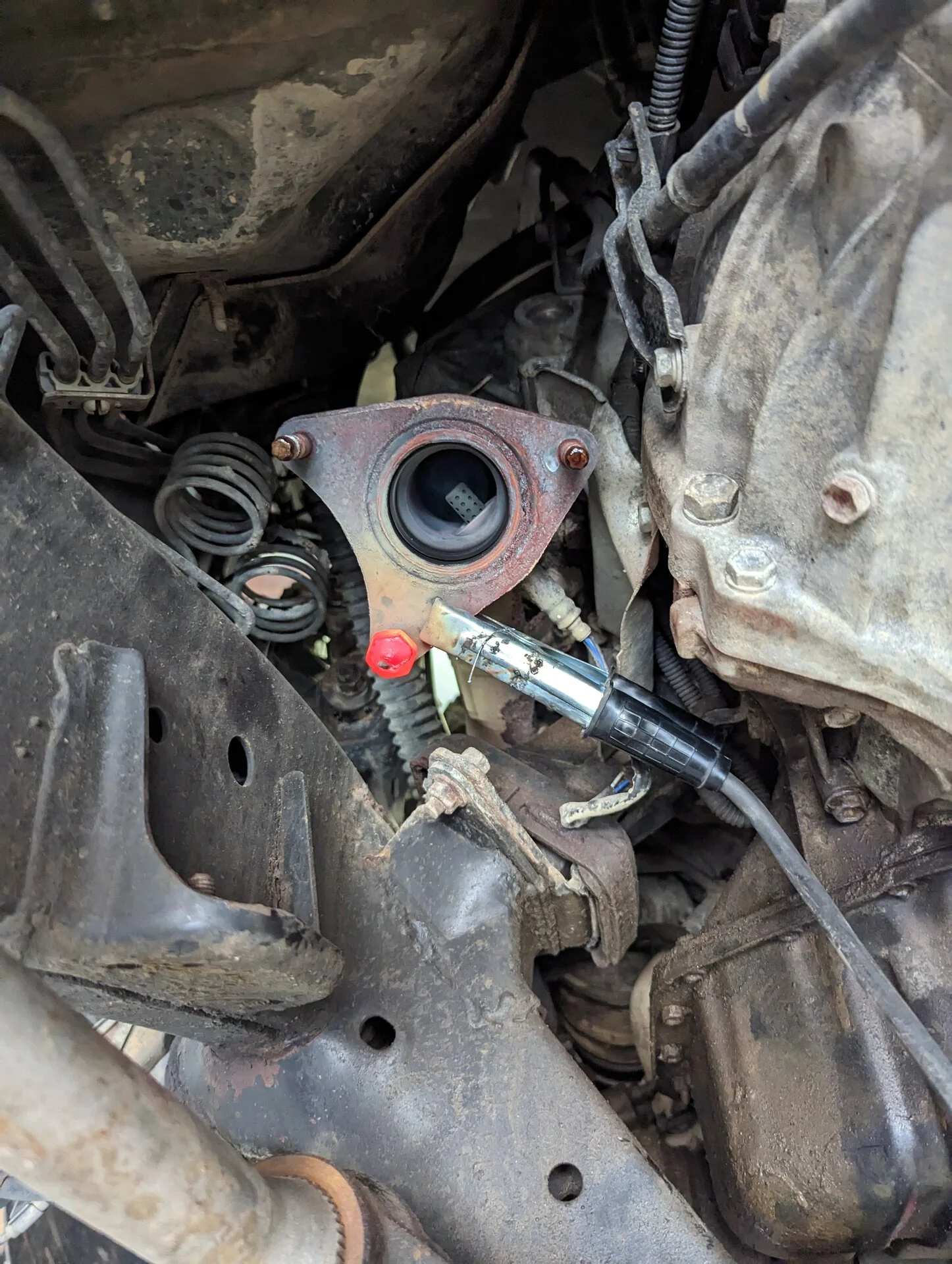

A little upset that I didn’t catch the front yoke not being in the order, but it’s coming. In the meantime, I’ve been thinking about fixing my exhaust manifold leak (and lack of exhaust left, in general) in the most unreasonable way possible for probably three days now. Last night I ordered a bunch of tubing, a y pipe, and a bellow. But I woke up thinking about this particular diet again. Anyone got a cheap or free LC100 oil pan and pickup in central texas (or like, a 3ish hour one way from central TX)? Also looking for a cheap or free blownt-up 4spd auto from a 100 series as I want the input/output shafts. I’ll have the Vitz available next week/end to make some moves if so.

50% of the collector studs bolt and 100% of the 9 nuts I welded on didn't do s***. Ironically the first time I've been to a gym in my life was yesterday and I did shoulders. And the drilling of these guys was shoulder day, round two. I take comfort in the fact this flange looks like the squirrel fr 'Ice Age'

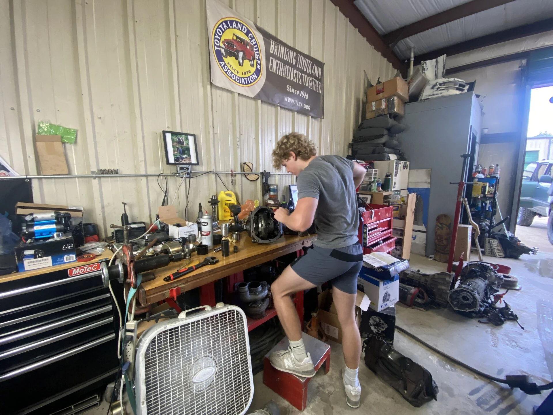

Getting this pre-load set with a crush sleeve is gonna suck. I don't have the right shims to get what I want outta the solid pinion spacers and I weigh like 141 right now drinking a beer, so it's gonna be some work.

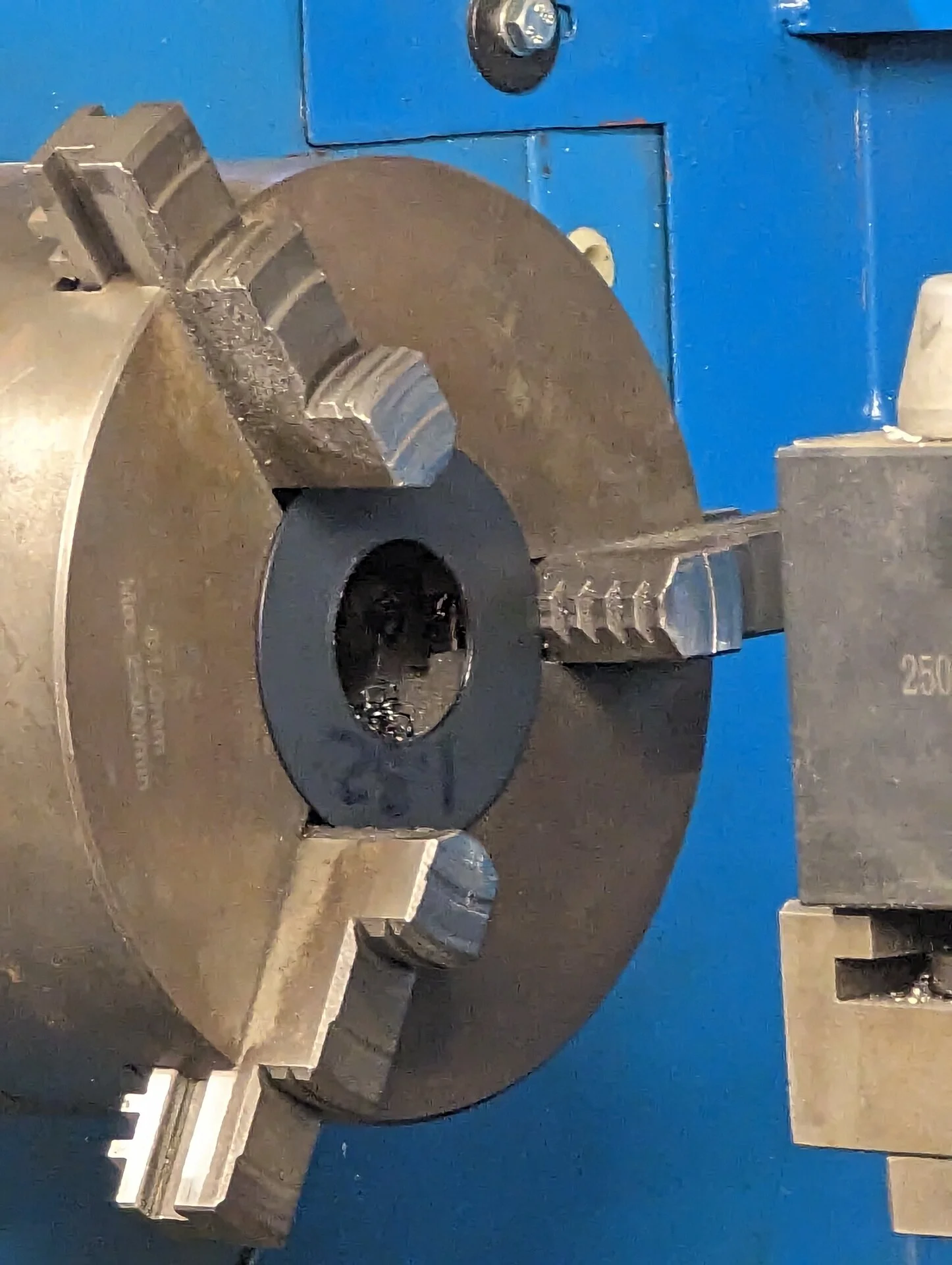

Oil slinger on the lathe. Only a 2.3 hour round trip. If you have a 100 series chances are you're gonna need a 32 spline oil slinger from a 200 series with your 4.88s. There's two left in the country in Toyota's system, and this was discovered Saturday. I daily the 100 so this has been a huge McOof.

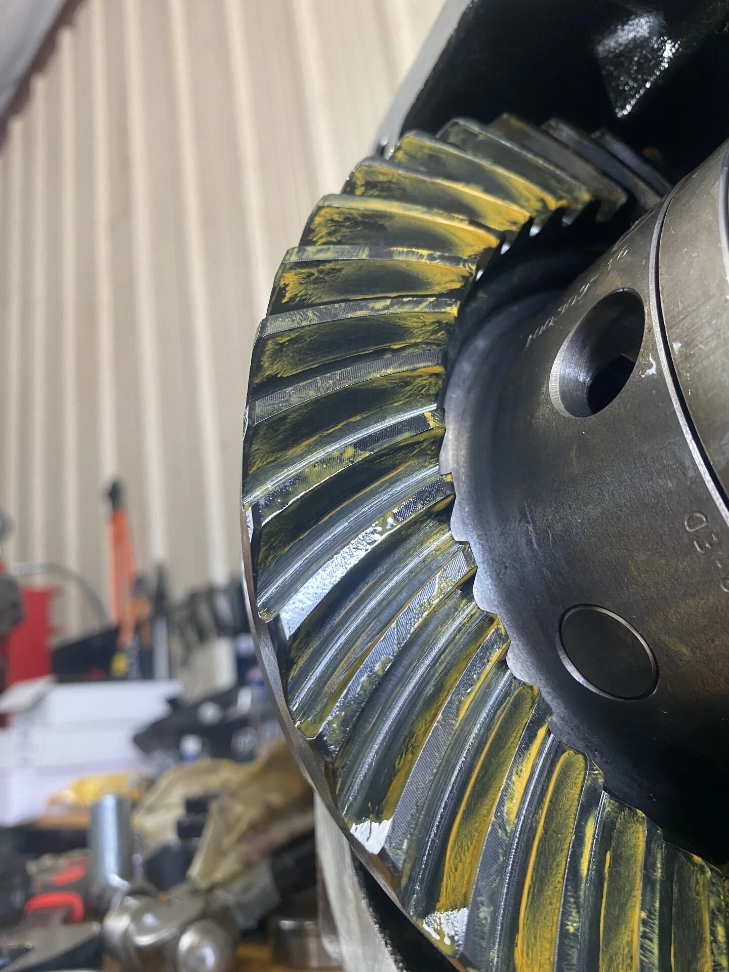

Remember folks, I'm not a welder, I'm an idiot WITH a welder. No matter, she's glued like Abuela to her novellas. This pic is real time. And I'm 99% I stuffed the ARB short term meaning I'm gonna be swapping the ring gear back to the LX470 LSD carrier after popping it open and shimming the ever-living-s*** outta it. A mistake I will never make again and a tool I discussed having made. There's a chance it still is okay, but I scratched the seal surface and that's a huge McNoooooooo
But hey, here's where we at. Stock master P shim was .050, I'm at .043 and happy. I remember coming home one day in 6th grade just before my birthday, probably a few days after my father's. We had hit a lick in Bethlehem and came up on 5.29s, a lock-rite, and a Detroit for the rear of the Hilux. By hitting a lick I mean I backed my dad's truck right into a tree and he filed insurance, beat it out, and bought himself the birthday present he deserved. Anyhow, I walk around the house to find the pickup in reverse on Jack stands running in 4 hi. My father, casually sitting on a 5 gallon bucket taking in the scene with a Marlboro hanging out of the corner of the smirk affixed to his face, sees me and comes and hugs me. I'm kinda taken back, not that a good hug wasn't normal, but the fact that the situation didn't seem to call for it. "You gotta keep your head in the game and pay more attention, but this is the best **** up you'll ever make. This is gonna be a game changer." He killed it, let it cool as he swapped the Boggers on and we were off to go test it out. That led to wheeling til around 10pm on a school night and a super excited conversation about how we were 11 months out from GSMTR 1998 and the fact that welded diffs and clutch dumping a previously rolled 55 with a Bondo roof was a thing of the past.

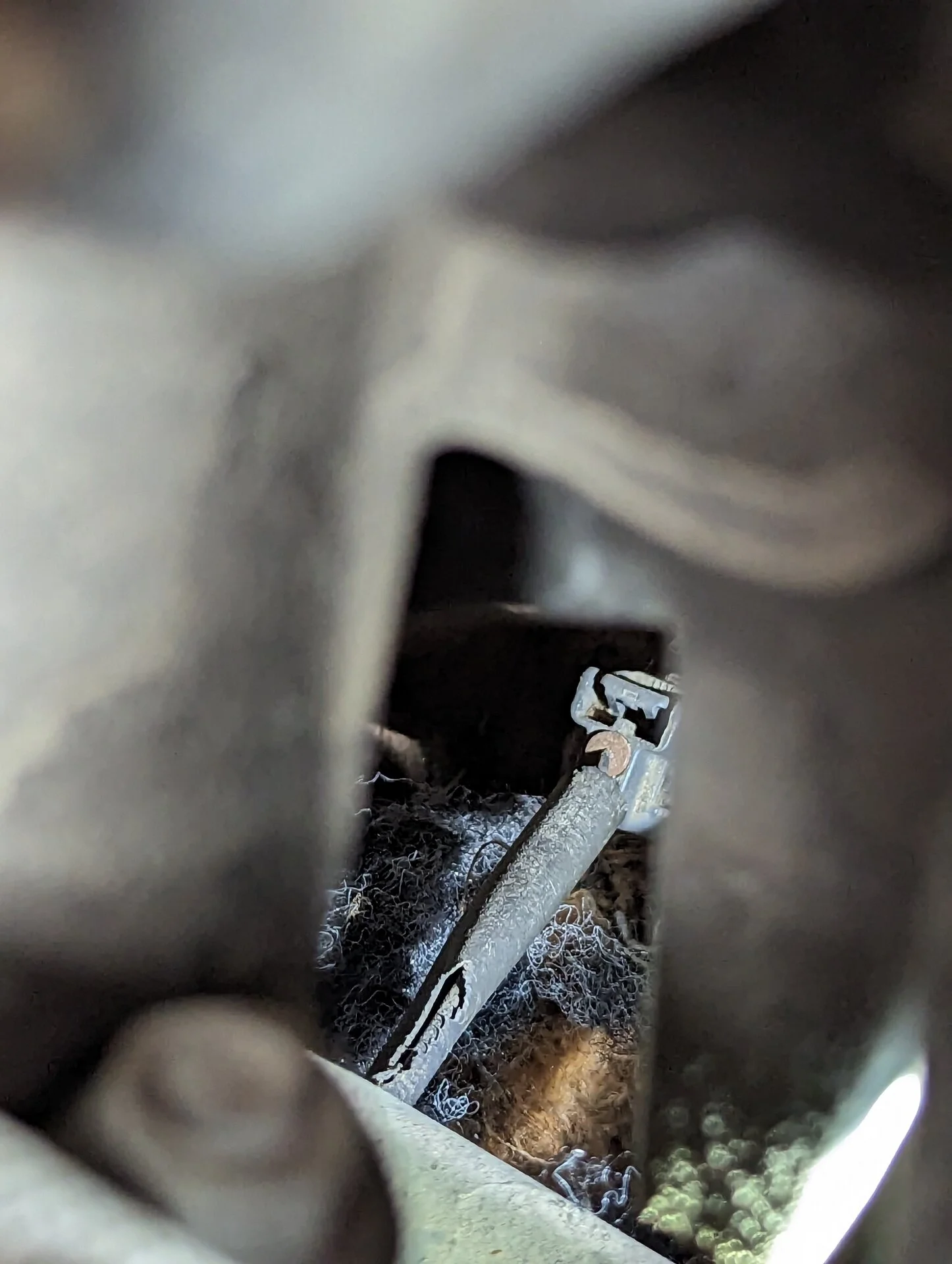

Knock-knock? No, rodent. Ended up doing the 12mm test on the heater tees instead of 14mm test and they're still there. I'm gonna be honest and say I don't wanna pull this intake, purely because I won't feel right not doing a starter or all the injector o-rings while I'm there. I just don't wanna spend anymore money.

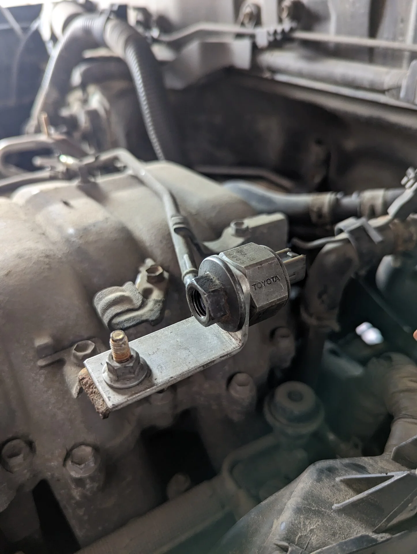

Anyone wanna take a guess on if this is gonna work or not?

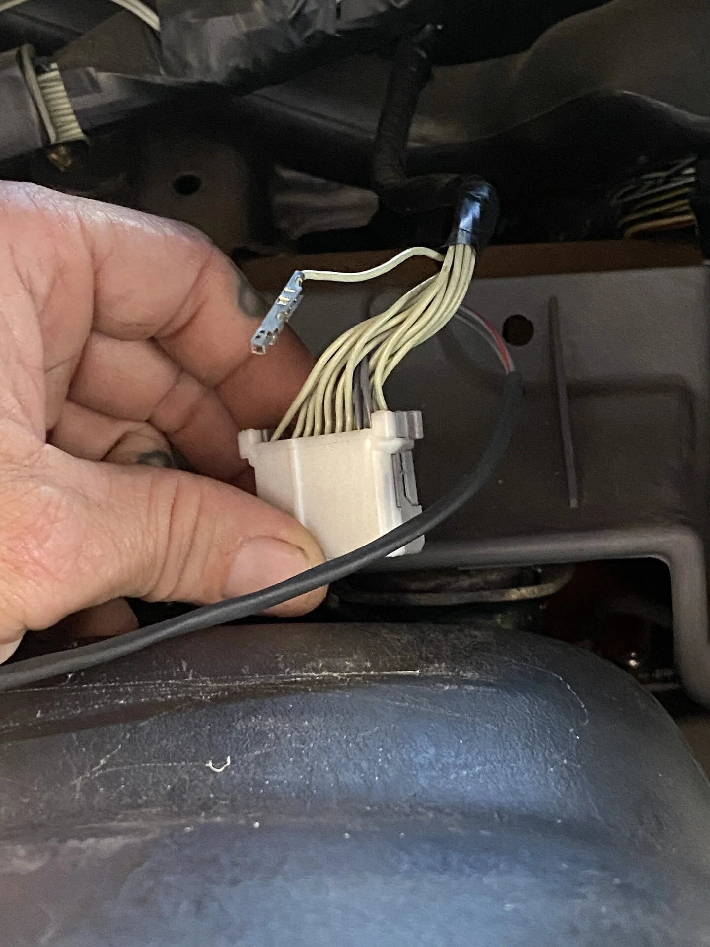

Lol, my net service S U C K S at the shop. Guess the picture didn't load. Gonna find the connector that runs to the knock sensor, then I'll repin that with my own wiring and a new OEM connector since I have a bunch of new wiring supplies
