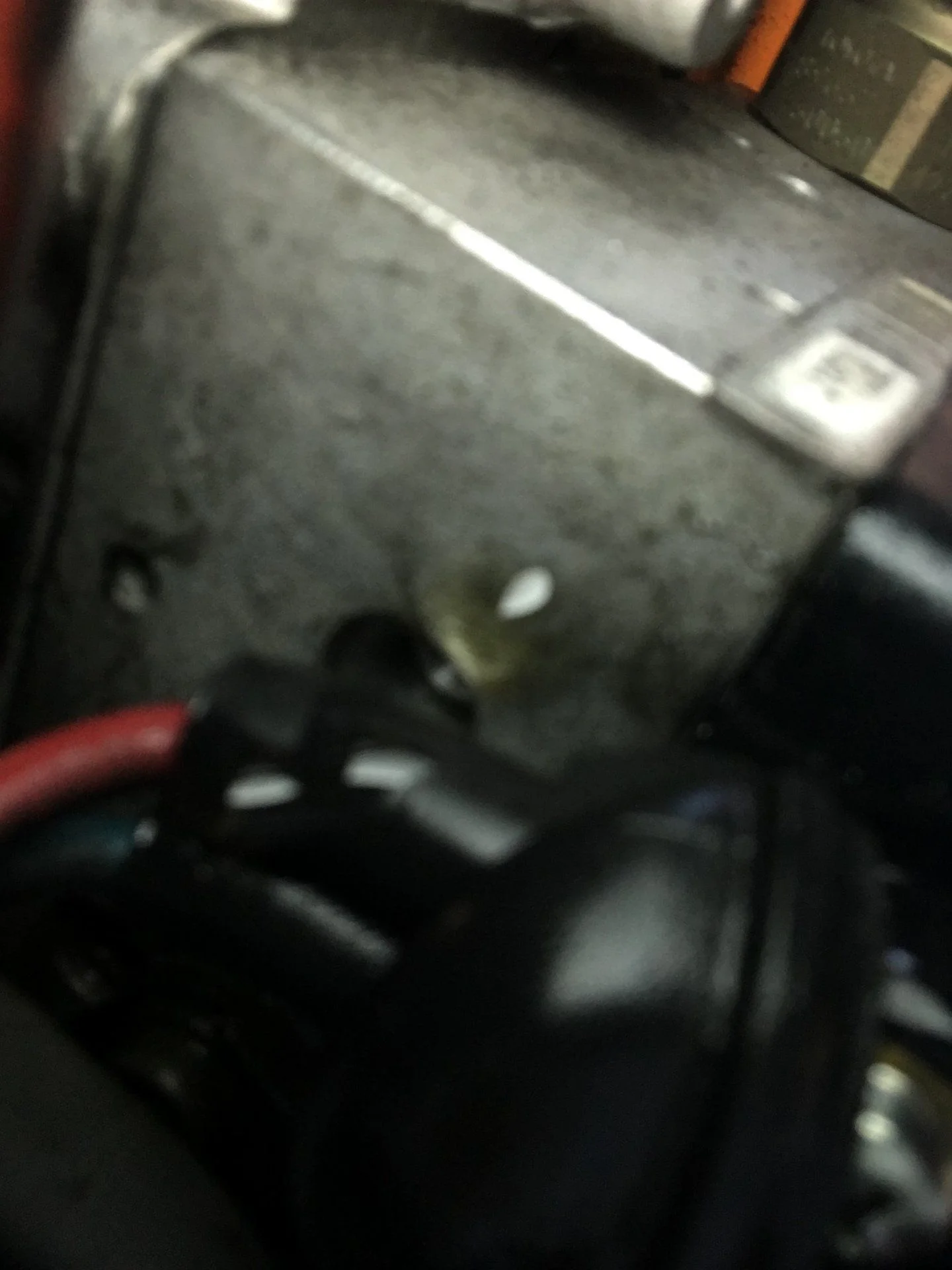

I've been driving it around town just fine. It's not effecting brake performance yet. Should be okay as long as I check fluid level and the system keeps holding pressure. I suspect this weep has been going on for a long time and I just recently found it. I'll PM you about taking a look.
I voted no, but I have the same weep/leak as shown by @mitchjohnson000. 1999 LC with 251,000 miles.
The difference with mine is that I noticed it first because mine had actually dripped down onto the inner fender (maybe 2-3 drips). I did some off-roading on a dusty trail and the dust collected on the drips and have not seen an additional drip since. The brakes seem to be working normally and my fluid level looks good; never low or high. I am monitoring the fluid level and leak regularly, but am fearful of potential brake loss.

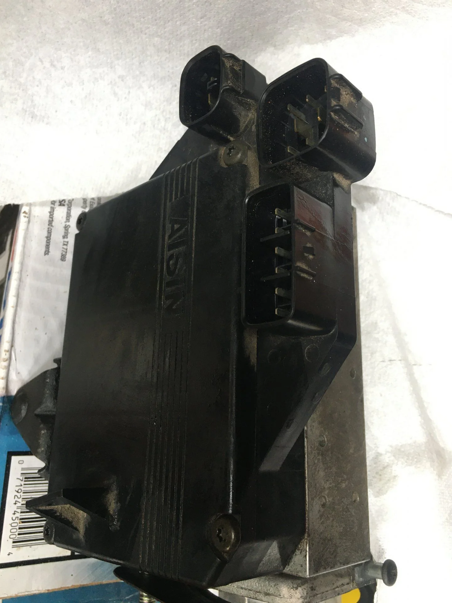

@FxFormat Thanks for chiming in. See what I found below.
City Racer
Is this the part or is there something else you might think is required?
Many Thanks for the feedback. This is why the forum is the best!!
City Racer
Yep, that would be it, it's not too hard to replace, took me a couple hours to do so. There's a guide on how to remove that whole unit as a whole on this site somewhere, search "Brake booster rebuild" it should come up, remove that whole thing and swap it over

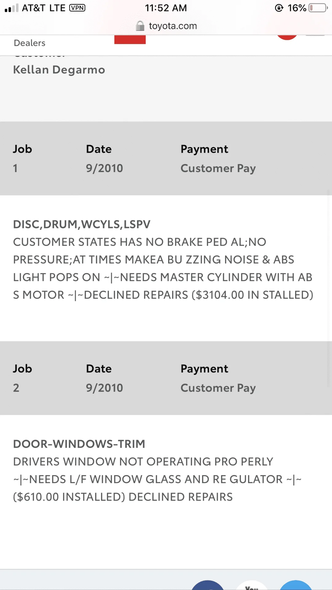

Been thinking about this recently as I picked up my ‘98 with about 230k miles on it. Haven’t had any problems with the brakes and just found out why.
don’t know what mileage was on it, but seems like back in 2010 a PO lost their brakes. Looks like they declined to have it done at the dealer, but was replaced with OEM unit somewhere else. So -

Yeah mine was done by the PO as well. It was a $3600 job at the Lexus dealer. I think it was around 220,000 or so. Too lazy to look up the exact mileage. But that was one of the main things that sold me on the one I bought.

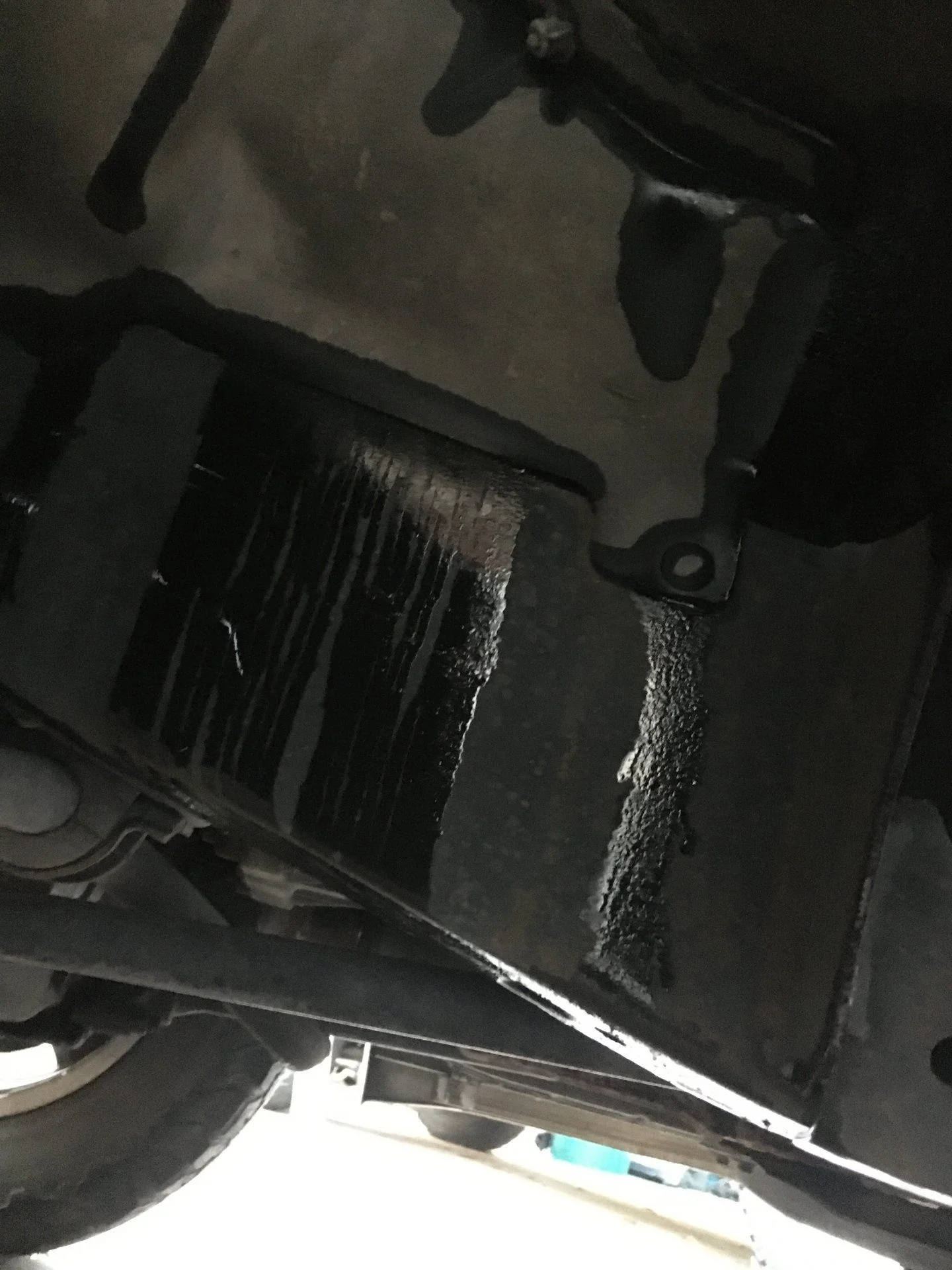

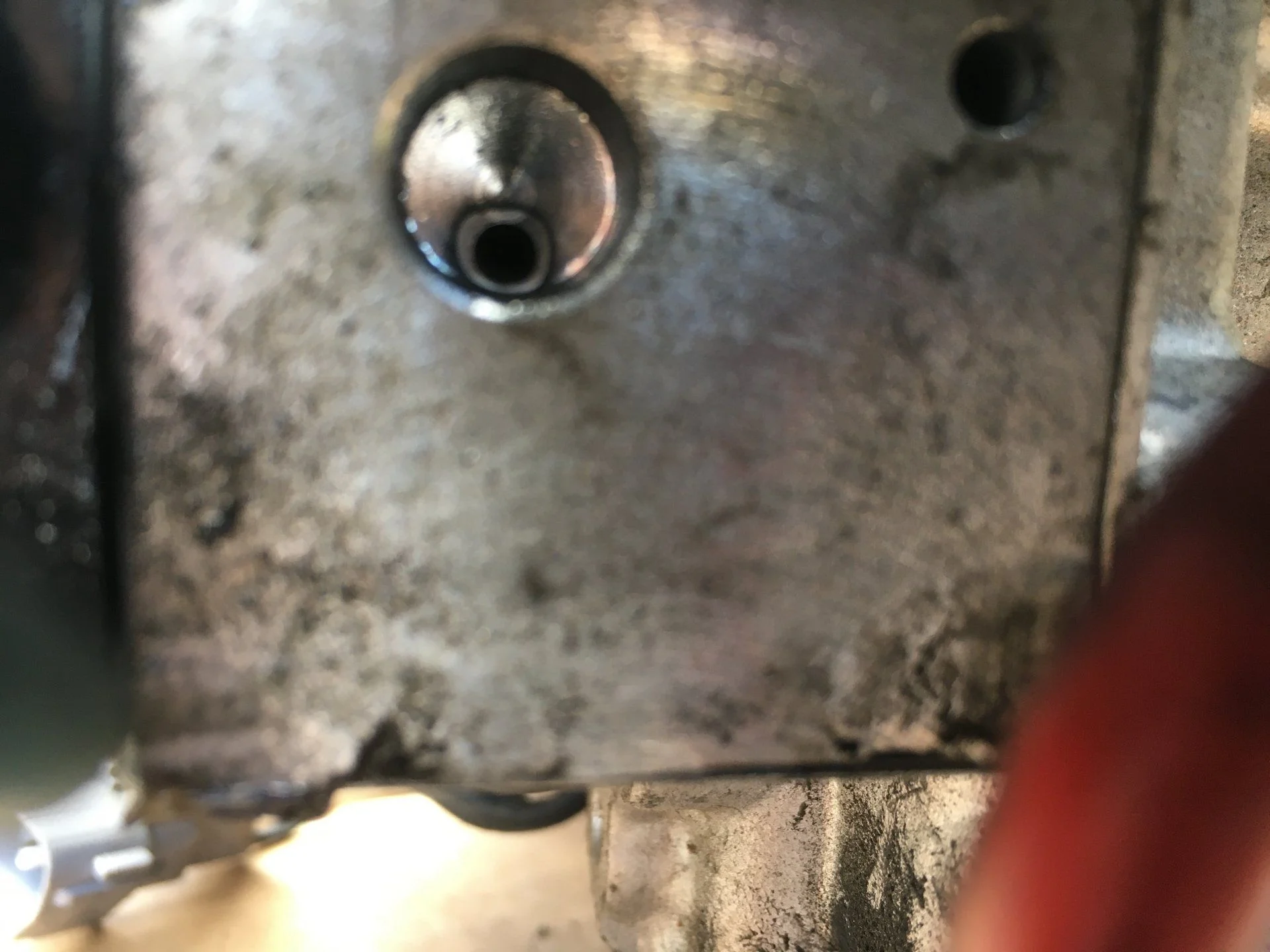

This week the brakes in my 2000 LX with about 195k mi had some sort of sudden failure in the ABS valve body that cause fluid to dump out at a fairly rapid rate. I posted this failure in the main forum earlier but thought I ought to post here also.
I drove my LX over 100 mi that day with no issues and parked it in the driveway. I went back about an hour later to moved it so the Mrs could pull her cruiser in. I looked back at where the LX was parked and there was as huge puddle on the ground. I shut it down and looked under the truck and fluid was raining down the driver side frame rail in the front wheel well. I popped the hood and there was a steady drip coming from under the brake Master Cylinder area. The drip slowly stopped after a minute or so. When the key was turned back to the 'on' position the drip immediately came back as the booster pump powered up. The leak seems to be coming from near a hole in the bottom of the ABS block which is next to where the leads for the booster pump connect. Below is a picture of where the fluid was dripping from. I disassembled and took a picture of the bottom of the ABS valve body up inside the hole. It appears that there is a smaller tube or hole that goes up into the valve body. It is likely that what ever seal or component failed caused fluid to dump through that hole.
Some things to note:
The reservoir was not over filled and brakes had not been worked on recently.
This truck has been a TX truck all its life and is about as rust/corrosion free as they get.
The leak is not coming from the seals between the reservoir and MC as that area was dry and the leak seems to be driven by the pressure of the brake booster pump.
The last time I did a full flush on the brake system including the ABS module using Tech Stream was about a year and a half ago and I use Prestone Dot 3 brake fluid.
No alarms or lights went off, possibly because there was still fluid in the reservoir to feed the pump.
I feel very fortunate I was just in the driveway when this happened.
I filed an incident report with safecare.gov
I searched the forum and it seems that there are only a handful of brake failures of this nature, so hopefully it is rare instance as we have two LCs of similar vintage to the LX.
Right now I am in desperate need of an ABS Valve Body. Toyota will only sell the ABS Valve Body with the master cylinder as a sub assembly part no. 47025-60041 for about $1,400 with tax and they say it is back ordered and will take at least a week to get one. If anyone has an ABS Valve body for a 2000-2002 LC/LX that they may have left over from replacing the whole unit for either a master cylinder failure or a booster motor failure, I would be very interested in purchasing it. The last to pictures are of what I need. I have also posted a wanted add for this item in the Mud Classified.
