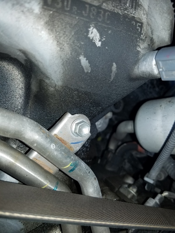

You are correct. Here is a pic of a leaking cam tower as seen through the wheel well (Tundra but same concept).
@bamma - That helps a ton!
