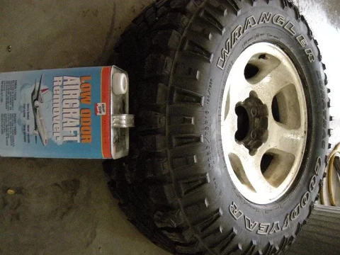

Sanchez is exactly right! I started off with Aircraft stripper>
Brush this on in a light coat trying to go in one direction, let set for 15 min. or so, powerwash & repeat. After powerwashing for the second time, I used a Scotch Brite pad in the inserts where it is rough and knocked off any loose flakes of clear.

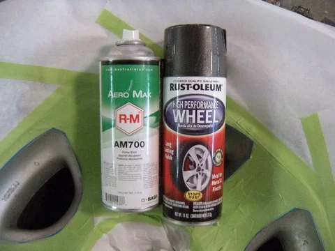

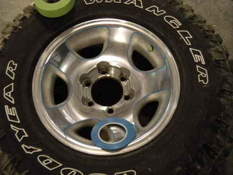

Next step was to clean the wheel up and mask it off for its coats of paint. I found some charcoal wheel paint that matched my bumpers really well. I found that if I masked and painted, then sanded and polished, it straightened out any lines that weren't perfect from masking. I used 3M 1/8" blue fine line tape to mask the outer edge, then covered all the rest of the unpainted surface with tape and paper.
Before I sprayed, I used wax and grease remover and blew it off really well. The first coat to go on was a metal etch primer. Don't put this on heavy just needs an even light coat. After that dried for 10-15 I was ready for coats of wheel paint. I ended up with about 4 good even coats, it dries pretty fast and seems to hold up well.
