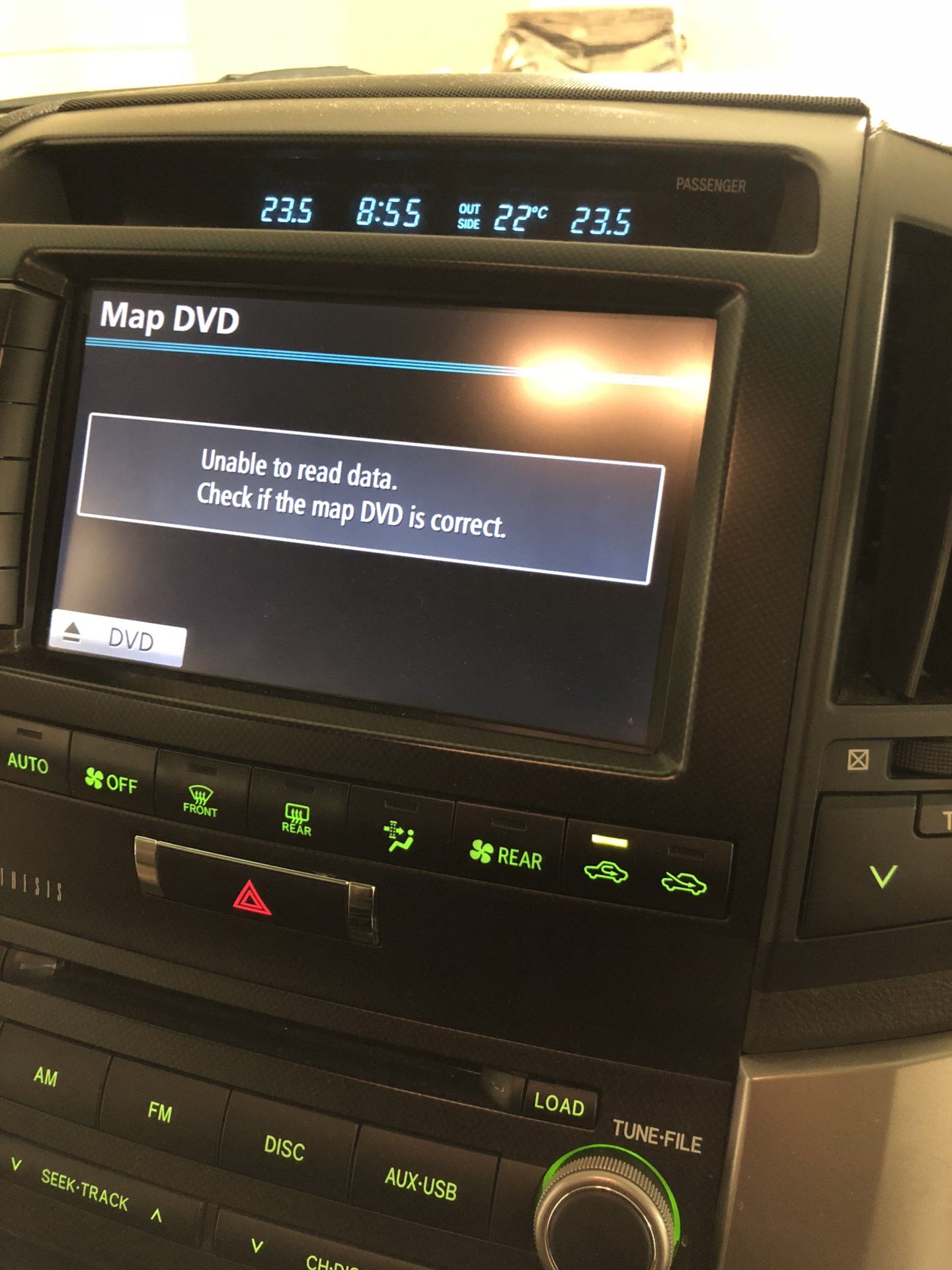

Been a happy owner of 2011 LC 200 with only 53 K miles on it.
Yesterday afternoon an error cam on the Nav screen :
“ Unable to read Data. Check if the map DVD is Correct”
After some web searches i tried to :
1- Eject the DVD but no response by pressing eject button on screen but no response
2- Tried to the “ invisible” top right than top left buttons but DVD won t be ejected.
3- Last resort: I disconnected the battery for 10-20 min in a way to reset system.
When i reconnected issue got worse with diffuicilty to start and Error message :
“ Program cannot be read
Pls consult to a dealer. “
Nothing works now on the main screes ( AC, Fan, Telephone....)
The 200 did start up but with a lower RPM.
RPM is at 500 whereas it should be more in the 800.
I am taking it to a Toyota shop tomorrow that gas tech stream.
Car is drivable but no contorls ( AC/fans) and RPM is lower at idle.

ISSUE SOLVED:
It ended up being the DVD disc which was out of place. We had to mechanically dismantle it and put back the dvd in place.

I took to a Toyota shop I am good friends with it. We dismantled the DVD unit opened it and put the DVD back in proper position.
system booted up properly and solved the issue.
The DVD was out of place in the unit....
