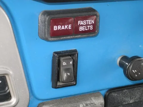

Glow switch for extra/after glow, which was only installed in "cold" countrys.

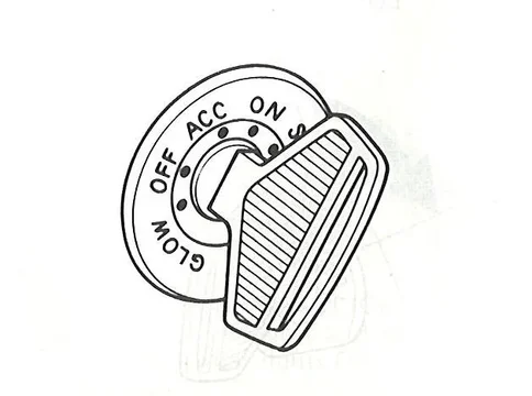

The ign key
Turn the key to the "glow" position.
Hold until the controller comes up bright orange. This can take something between 10 and 20 seconds.
Turn key to the start position and start the engine.
If you have the extra glow switch you can hold it for afterglow until the engine runs smooth. No longer then 20 seconds!

Ok, I have the right lock and I have the right switch behind the lock.
Lock states glow and I can turn the switch to glow with a screw driver.
I am not able to just turn the key to glow though.
I noticed that if I push the key in hard and then turn it, I can.
I do not have to push the key in hard to get to Acc or start though. It just turns.
Is this normal?

It sounds to me that the push-in-to-glow is a safety thing but I'm not sure about that. My '78 BJ40 doesn't have that but also not the steering lock, so I can't tell you if it's normal.
Let's hope another '79 and later owner chimes in.
Rudi
I don't have to push my key in further to be able to rotate it backwards towards glow either Rudi. And I have never heard of anyone having to do that before.
Sound to me like there is something wrong with either your key or your ignition barrel Berntd.
