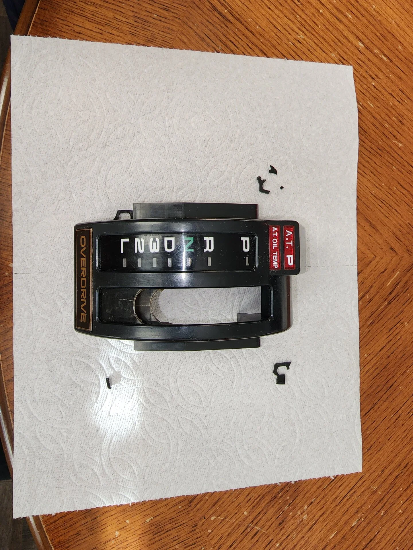

How would you guys go about repairing the brittle plastic on this shifter box and other interior plastic trim?
I bought the parts to do this.
Have not yet completed it yet, but seems like a nice alternative. I tried 3d printing new plastic but it was a pain
If you are repairing cracks or have the broken pieces, I have had good luck with cyanoacrylate (crazy glue) and baking soda to reinforce and bridge gaps.
Edit: meant to say baking soda
