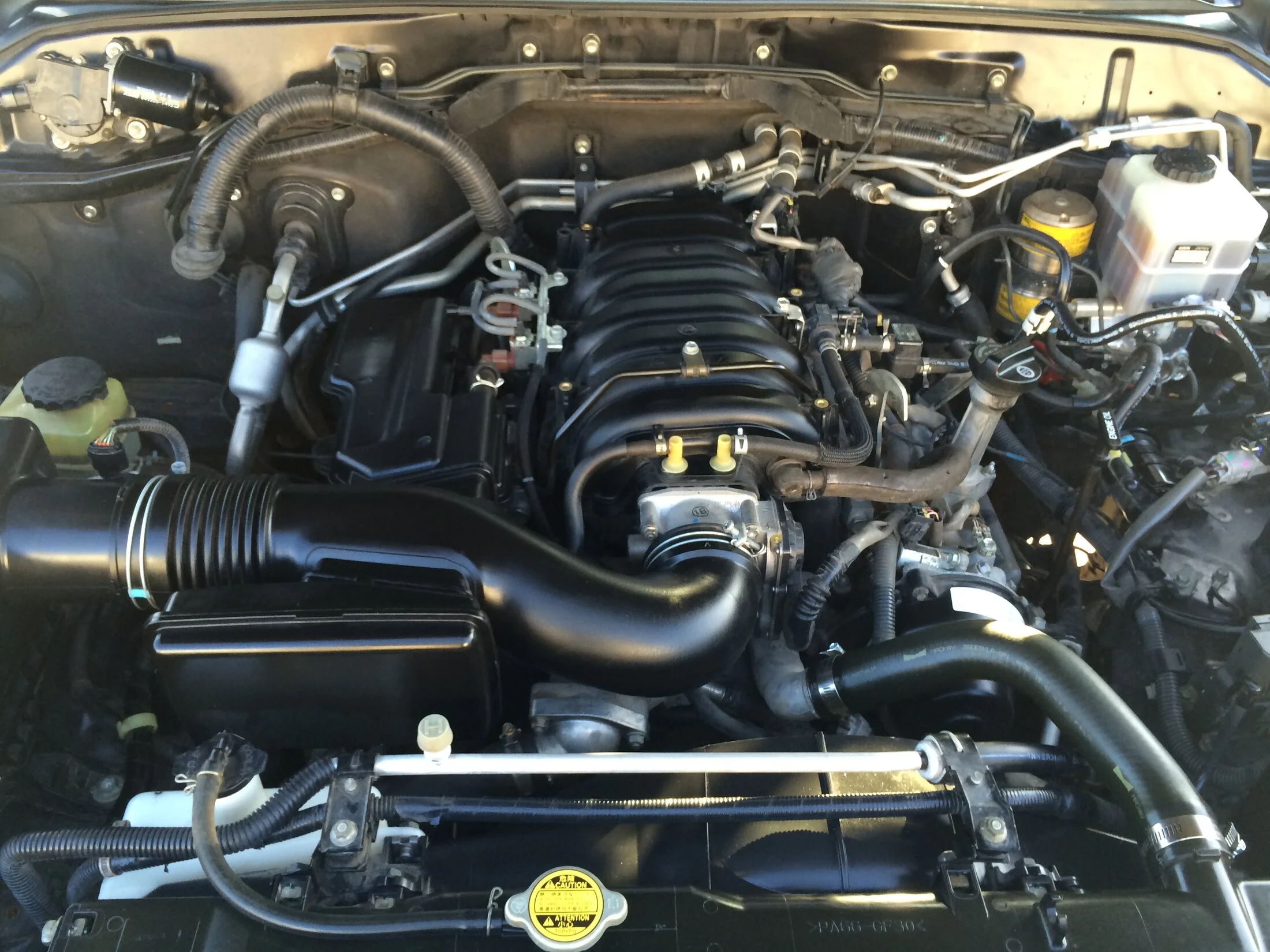

I'm having the same issue. Engine cover vibrating like crazy when in Drive at red light. Put it neutral it stops. I left it in drive and pulled the E-Brake, popped the hood and could make it stop by placing my hand on the cover. Im curious if it was reinstalled incorrectly? I kind of want to keep the cover. Any suggestions on how to make this stop vibrating? PS its been cold cold cold here in NC

Refoam it
Just removed cover and only one of the 2 pieces of foam are there. Im assuming this is causing the vibration. Any pointers as to what type of foam I would use to replace?
