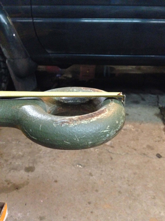

After years of dissing pintles I finally realized what was being done wrong. The cross-sectional OD of the lunettes are typically too small. Like this one:
See how much gap there is between the lunette loop and hook of the pintle? It should better fill the opening in the pintle. There has to be some gap for it to work right, but that gap is excessive and likely makes a lot of noise.

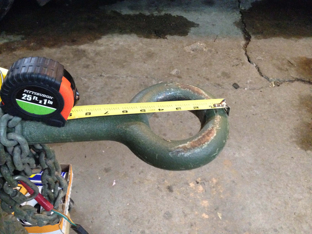

Compare the above pic to this:
Still has plenty of operational clearance, but way less opportunity to make noise. It wasn't until I bought the ring above that I realized that there are differences in the cross-sectional OD of lunettes. I though there was some std. out there that made them all the same. Not true. I now have a lunette like the one in the first pic destined to be recycled.

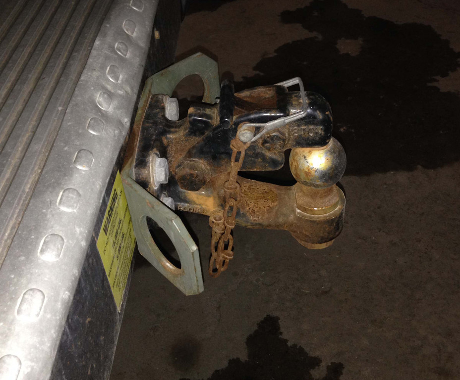

On the Bronc-up I will only have a pintle hook. I'll be able to tow anything that I need to tow with it and can drop a snatch strap on the hook, then close and latch it faster than I can deploy anything with a shackle.
I suspect this is the case. I recall coming across sizing guidance on pintle/lunnette combos somewhere years ago. I would think it would be more commonly available info, but needs more digging it seems.
We use a Reese 8-ton combination pintle. It would seem to be noisy, but isn't really.q

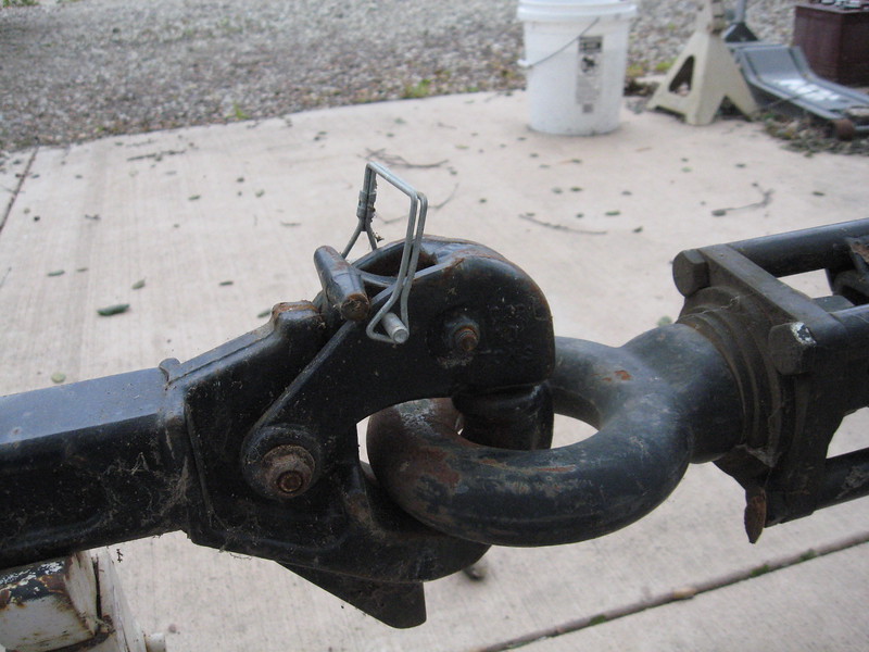

Our M101 CDN came with this lunette, with a round cross section of ~1.75"
In more of a side view, you can see how its beefiness works in favor of less noise when fitted correctly. There's a little over 2" of room inside the pintle, but if you look closely at the design, there's actually less than that due to the way the ball part of things intrudes into the space.
There's very little clank and clunk with this set-up. There's noise from time to time, but I wouldn't call it noisy.
By "cross-section OD" I mean the diameter of the ring, not the torus. Looks like your sample is about 1.50"
I was given one of those combo ball/pintle set-ups. Initially I thought it a good idea, but after looking into just how these couplers are supposed to work I think it less than ideal. No way in hell would a put a snatch strap on it, and it lacks the graceful curve that would allow a smooth break-over transition thru the coupler. I'm sure it will work, but the lunette ID to 'hook' clearance will be varying depending on the break-over angle.

Not sure I'm following completely without getting the dictionary out and studying a while - and the wife is pressing to go to the store. A quick remeasure shows what I measured roughly the first time as a 1.75" diameter is as you say closer to 1.5". Outside lunette diameter is 6.25" and ID is 3", so the difference comes out to roughly equal the 1.5" ring diameter. Of course, it is Canadian/NATO stuff, so it's really all metric anyway. ;)
I'll get a picture of it all hitched together when I get a chance. It leaves little room for slack between the two mates. I'll certainly agree that you don't want to smack it much on stair steps, but I'm more likely to encounter a standard coupler trailer needing hauling than some of them uglies these days. Can always swap it out by loosening 4 bolts if a full-pintle hitch is a better idea in my travels in the future.

I use pintles on all my farm and float trailers, because they just work with no worries of them popping off. I learned that long ago to size them right and you won't be banging around. I have several military vehicles up to a deuce and all of their pintles are tight. Even on my 55 I use a 15 ton pintle, sorry but that combo hitch would worry me if hauling a big load. I'm assuming you use it just for a small camping trailer.
Ron,
It's what I use with our 1/4 ton M101 CDN. It's rated at 8 tons. I'm assuming that a roughly 1:8 actual weight to ultimate capacity margin should mostly keep me out of trouble...
