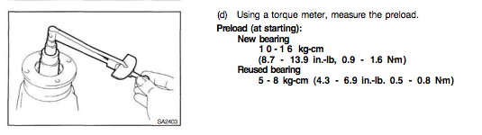

Ok, this is in a 80 series manual (check the attatchment), but i have the same text in my 40s manual.
It says (at starting). Do they mean that its the torque needed to get it to rotate? I think Toyota should have explained it a bit more.
And one other question. Should there ve a big difference in initial torque and torque while rotating?
