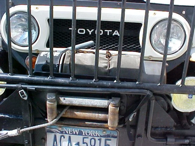

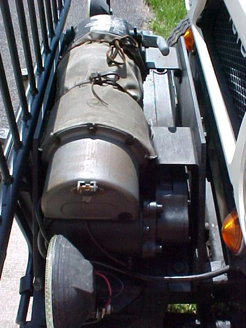

anybody else running Pierce Winches?
I have a 12,500 lb Pierce worm gear winch
Electric, Hydraulic, Chain, Truck & Industrial Winches, Electric Chain Hoists - Pierce Sales
Pierce PS654-8MK Winch
I had installed their Ball Bearing winch motors:
Replacement Winch Motors
and the silver contact solenoids:
Pierce Sales Winch/Towing Accessories 1
Dear god, that is one beast of a winch. How much does that thing weigh?
Winch? How much does that section of fence welded to the bumper weigh? :lol:
-Spike
SWEET Winch.:):):):):):):):)
Old school/industrial look. I am in love. Is that 3/8" or 7/16" cable? "I love me somes big winch.:clap:" Only thing that would be cooler would be steel tracks for the fj40 and a turret for the back.
