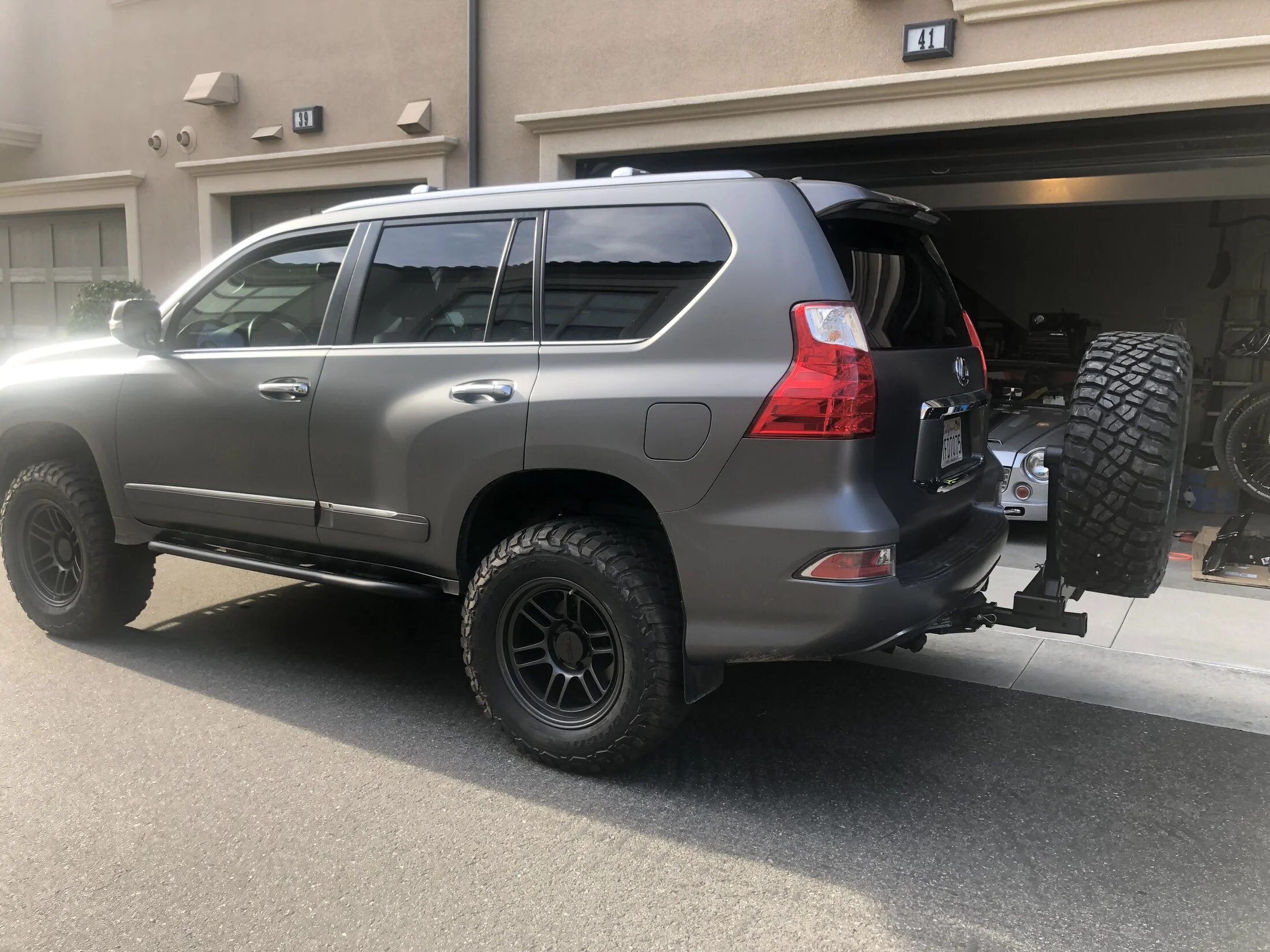

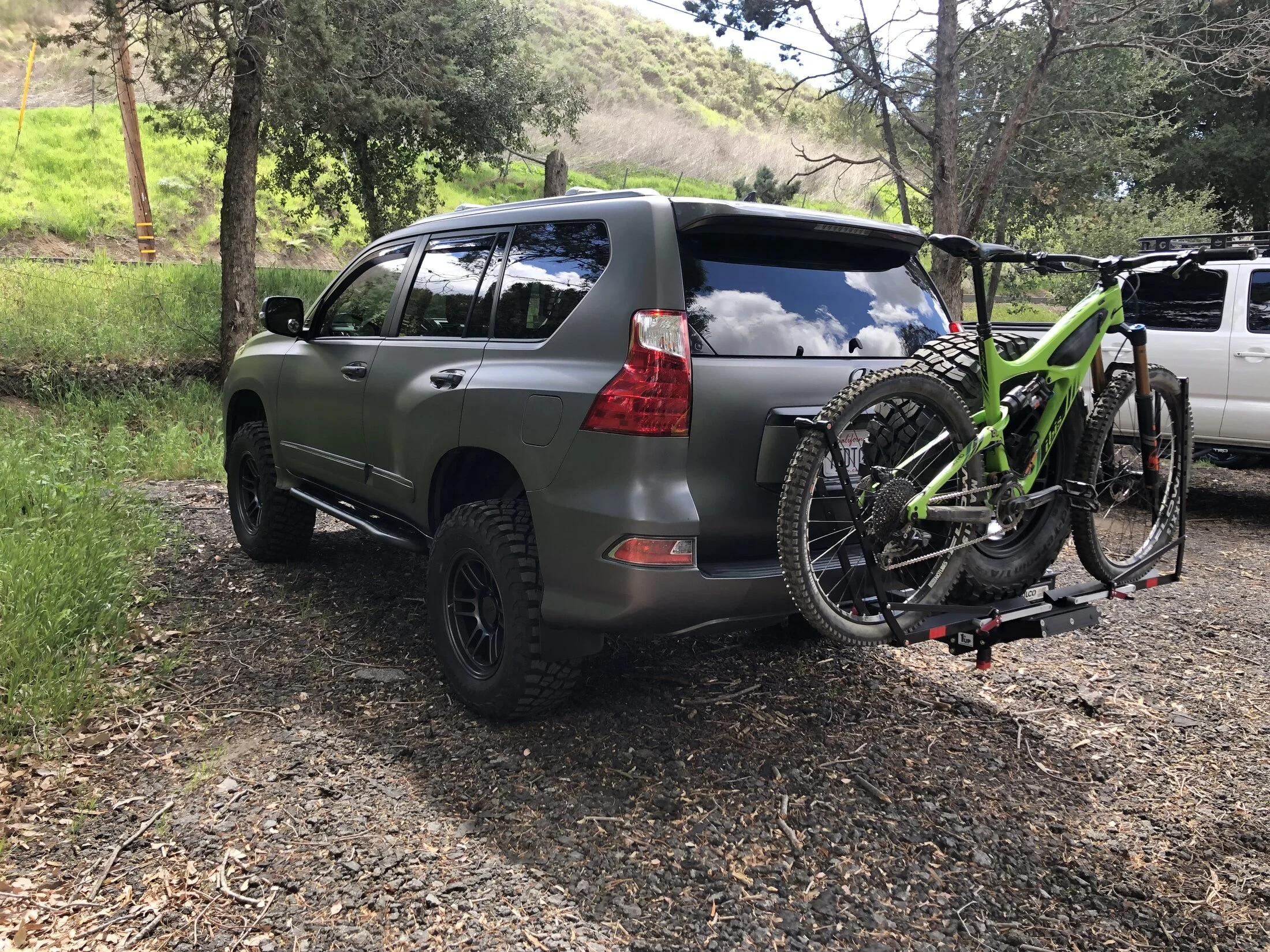

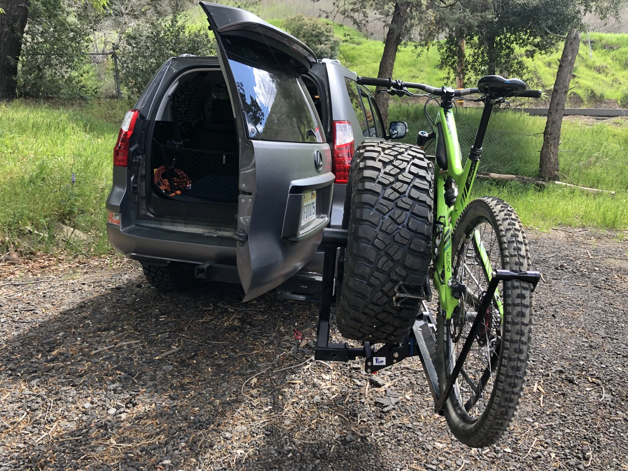

I ran the Wilco tire carrier for maybe six months in 2019/2020. I was scraping it all the time on, totally kills any departure angles. First I changed the GX hitch to a 4Runner hitch. This brought the swingout a little closer and higher. It still stuck out too much for my liking, and when the JW door mount came out I installed that. If I were to do it again, I would buy the Rigd because it fits a closer than the Wilco.
These are the only pics I have. The pic in front of the garage is the Wilco with the factory hitch.
The pics with the 1up rack are with the 4Runner hitch.
Thanks! Which Wilco hitch is that do you recall? Looks like it might be the Solo Standard. And yeah, that departure angle still sucks.
View attachment 3807151View attachment 3807154View attachment 3807152
That DOES stick obtrusively out from the rear door.
It really would have helped if they moved it a little closer AND tilted the spare to be at the same angle as the barn door for aesthetics.
