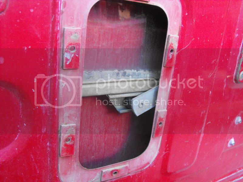

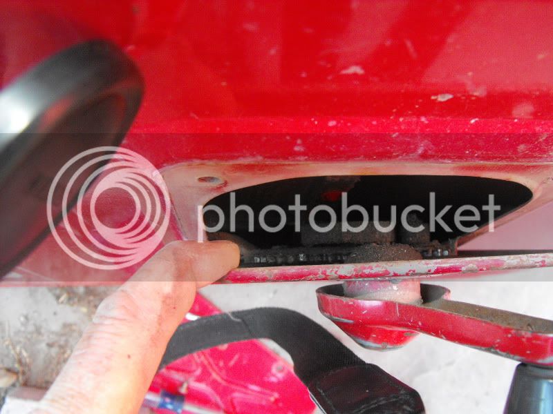

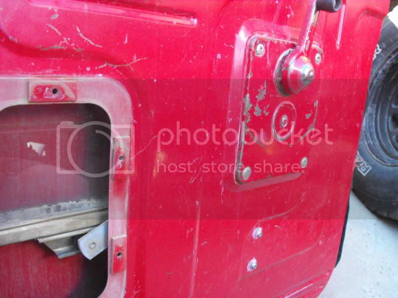

Sorry for the delay rat. I've been busy with other stuff, and just got around to snapping shots today.
As far as I can tell you really only need two things:
The window crank plate has an arm that is attatched just below the crank, and the crank itself has a gear that turns the arm. It just swings an almost 130 degree or so arc, and a wheel on a track allows it to move along the bottom of the glass.
The glass looks like it just sits in the top of the wheel track. Pretty simple. The other hatch is just to get at the components (hold the glass up while you screw the plat ass. in).
Hope it helps. :cheers:- Josh
There's a spring as well (you can see it below the crank). It does the holding.
Simple enough to work well for me (almost 50 years after they made it). :eek:
Wish my other cars worked this well in fact. :doh:
