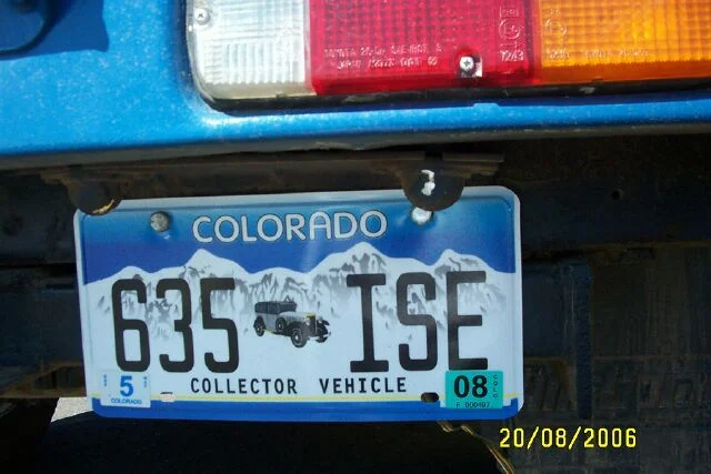

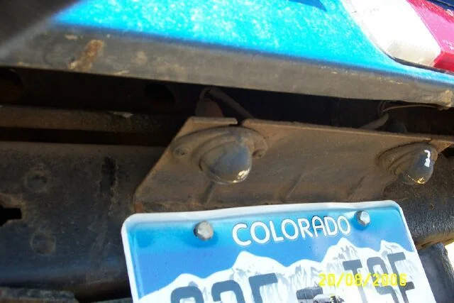

Do you have the orginal bed? The long beds came with a special plate holder that mounted underneath somehow.
I don't have one, but took pictures of one at the Denver TLCA Rally. I'll see if I can't find them.

not sure if correct or orignal........but the early 45's had no light that I know of, sure the latter ones did

My truck was originally sold in Oz as a cab/chassis unit, so it never had the factory bed. It does have accomodation in the wiring harness for the license plate light, so I imagine it went on there somehow. i'd like to see what was original, if anything, before drilling holes in the rear chassis crosspiece.

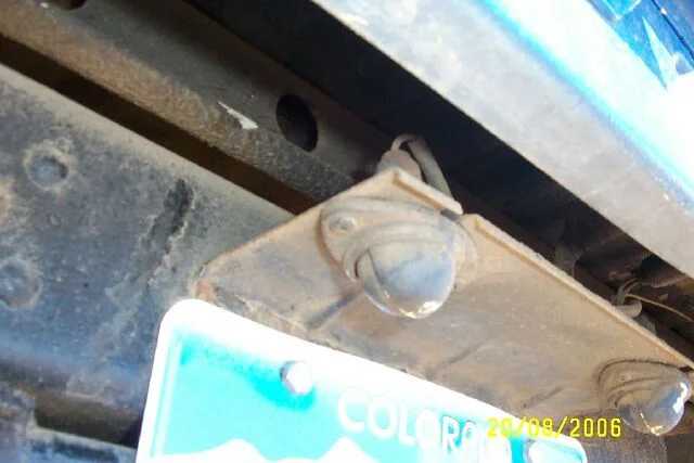

If this isn't a factory piece, then the owner did a great job finding this off of something else.
Yeah, I agree it looks good - - and the question remains, is that the factory mounting? If it was, I imagine locating such an item would be next to impossible. Thanks for the excellent pics!

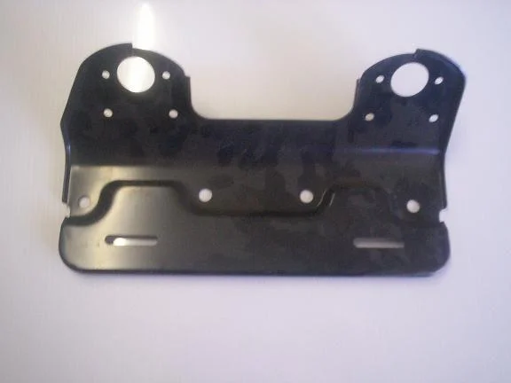

I have one in my hand. 99% of the 45's 75's etc sold down here are a cab chassis. The brakets toyota supplied for lights and number plates were mainly discarded, and the units were built into the Tray, which were made by hundreds of local body builders.
These have been laying around for a long time. Im sure this a 45 series one which is the same as the early 75 series.
It's yours if you want it..

Well, I'm definitely taking you up on that offer! I just sent you an e-mail asking about making arrangements for postage.
Wahoo!! :bounce: :bounce2: :bounce: :bounce2:
Ive got one ready to send to Chris.
Ill see how many other are floating around. We just had a HJ47 here, it is the same part. (i didnt get a pic unfortuneatly)...
