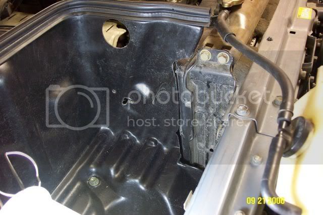

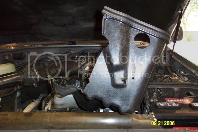

Pic's of trimmed aux. battery tray for 93-97
Apr 25, 2005
42
230
Austin, TX
I had this sucker in/out no less than a dozen times, so I thought it would be worth snapping a couple of pic's for those about to go down the 2xbattery road. I used a coping saw to trim, and files to smooth the edges. I also used a round file to ever-so-slightly elongate a couple of the mounting holes. I had to flex that thing pretty good to get all 5 bolts started... enough that I should probably have my alignment checked :doh:. Also gotta mention that these boxes are made out of asbestos, saccharin, tar, and nicotene... so I recommend a dust mask and leaving the dremel in it's case. Still kinda itches.

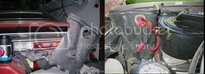

Here are stolen pic's of Dan (installed yet?) and Beowulf's trim jobs I found while searching for inspiration...
I removed the foam that was adhered to the side that got trimmed off and (half-assedly) adhered it to the radiator...
Very nice :cheers:
Unfortunately I need these pictures about 2 weeks ago :doh:
I used a dremel and found that it created no dust at all, it just melted the material away which also created a nice splinter resistant edge.
Thanks for the great pictures - they will make my job easier.
x2. I'm ready to do the same thing on my newly acquired 2nd battery tray. Nice pics.:beer:
