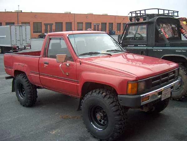

Pics of tire sizes..no lift
Jukelemon said:
Were you running 8" wheels on those 32's? What was the back spacing?
Yep, 15x8 with *I think* 3.75" backspacing. They fit great. I wheeled the s*** outta those tires/rims though, and since I usually ran them at 9-10 psi offroad the lips of the rims got mangled. I would go with 15x7 rims next time.

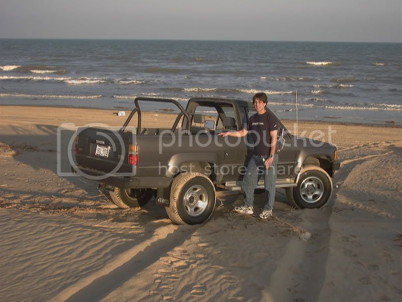

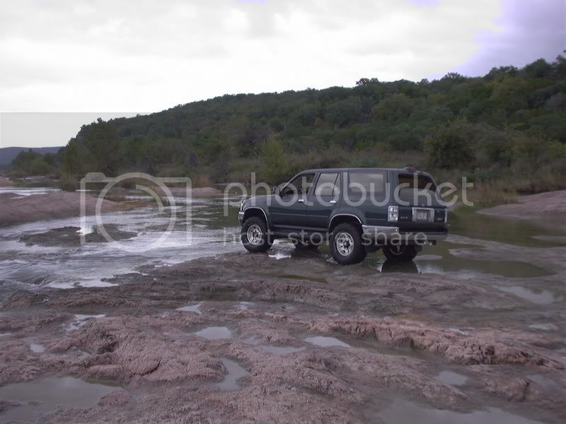

Try bias ply 32x12.50s on stock wheels! The bias ply sidewall bulge looks plain wicked on 7" wheels. I ran them on my '86 pickup with pretty much a 1-2" t-bar lift/lower stops but also would slap them on my stock 4runner. Now on my pickup since the 32x12.50 are discontinued I run a x-terrain 31x12.50's....see if I ever break a bead! I also have 4.30 gears out of an automatic in the pickup and it helps alot with the wide 31's. My dad also runs 275/70-16's on his near stock 4runner (new t-bars, add-a-leaf for the saggy butt). With the 4.10 gear it isn't so bad since they are street treads.

On the bone stock 4runner:
Pickup with the 31x12.50's:
Dad's sweet 4runner:
