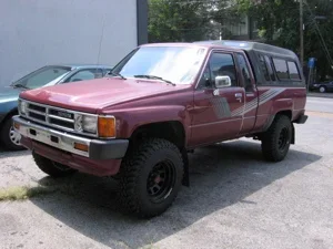

Ah, that looks nice. Were your rear springs tired? Looks like they are drooping a bit. The reason I ask is for rubbing purposes
Yeah, the rear end needs liposuction! 19 year old springs + some stuff in the back... no rubbing though, either in the front or the rear.
There's no noticeable difference in milage over stock, but the wheels / tires are heavier and it lags just a little more taking off from a full stop. The auto trans has a lot to do with that. For me, the tire size had everything to do with what I use the truck for: daily driver, light trail use for fishing and fun, and I didn’t want to regear or lift it. But it is time for new springs!:D

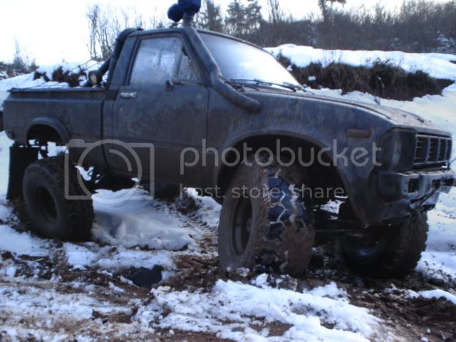

I know this isn't really what you're looking for, but here is my junk on 36x12.50 Swampers with only 1.5" of lift. It would have been driveable like this if I did a little bit of firewall/fender trimming. (I was getting ready to SAS it, and I just stuck these on for a week or so to see how it drove). Anyway, the point is you can fit a pretty tall skinny tire in there if you want to:
