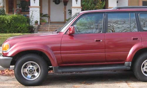

Pics of my new 93' fjz-80 :)

looks clean -- hows the interior??
The interior is in pretty good shape...The front seats and dash have been covered so they are in great shape. They is a little cracking in the rear seats, but nothing to bad...The carpet and headliner need a shampoo, but don't have any rips or permanent stains...I'm pretty happy considering the age of the beast :D

Lose the after-market fan belts and you need a new throttle cable.....;)

I'm with you on the belts but the t-cable is the parts manager in you talking.:flipoff2: Mine has looked worse than that since I bought it.

Glad to know you are happy to run shabby stuff on such a nice rig.........:D
I guess you keep the hood closed unless it's an emergency...........:rolleyes:
