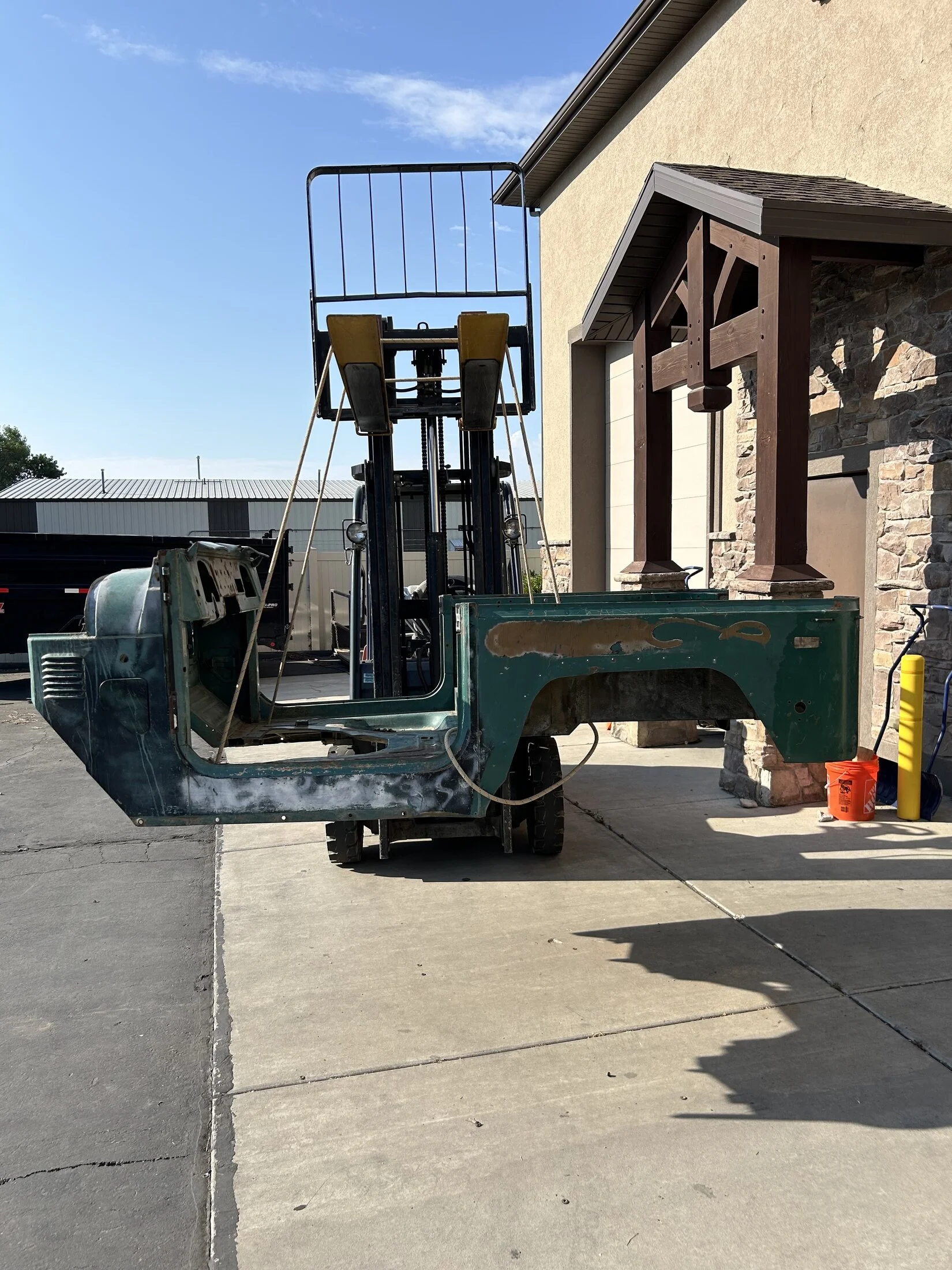

I have a 74 tub that I'm working on to put on my 78 frame. The PO had cut the wheel opening and put on fender flares. I had flares on my old 40 in high school and have no issues with them, just thought it would be fun to try and patch them up. I bought the replacement panels from CCOT. I watched a few videos of how others had done it. I hung the body from a rope using a forklift:

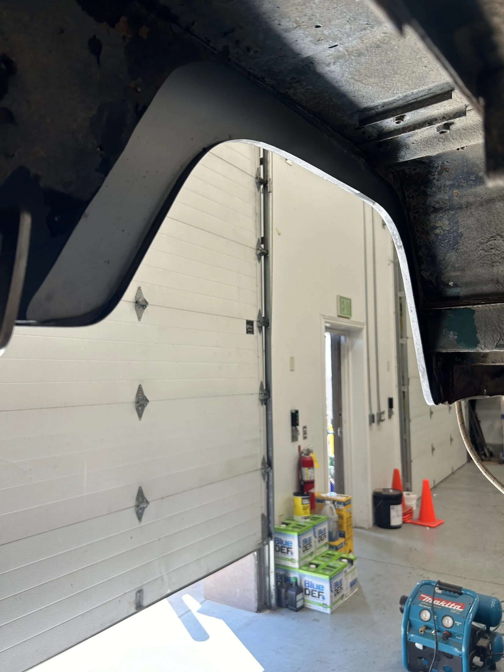

Then I placed the panels over the cutout and traced out where I would cut the patches. This was taken before I married them up better. I had to do some work to the rocker panel side cutout. Just showing the pic so you could see from the inside.

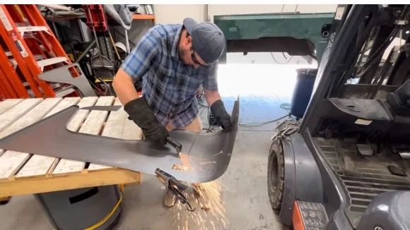

Cut the patches out using a plasma cutter:
