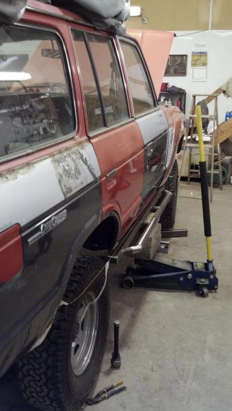

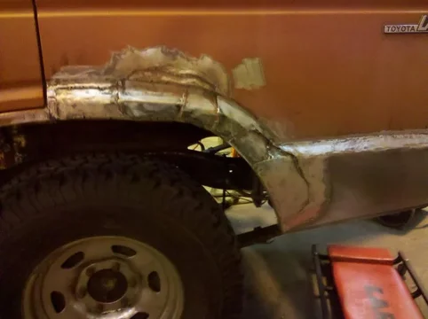

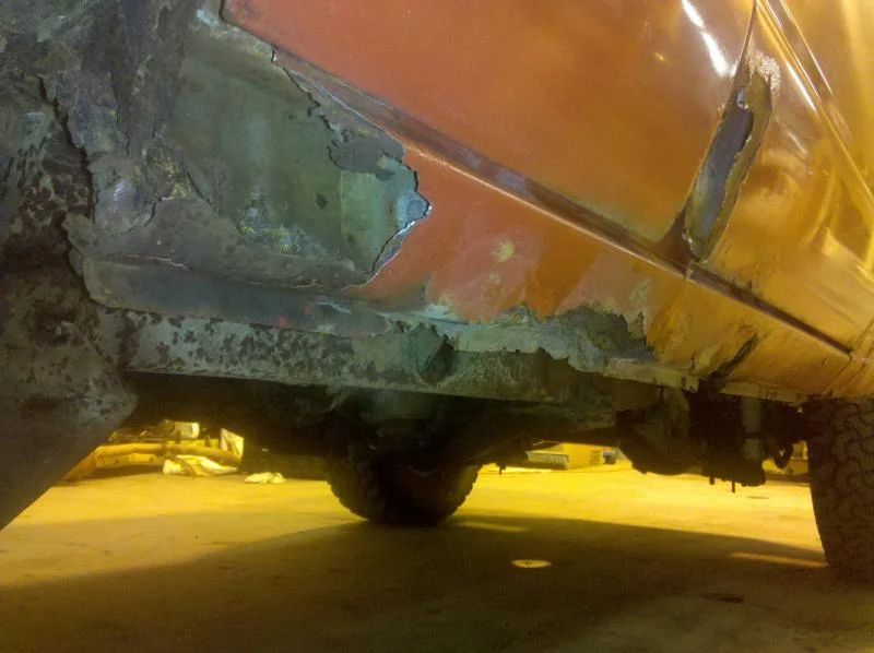

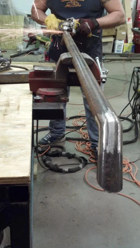

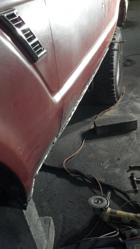

Finally trimming rockers and adding sliders
Thanks to everyone who posted a reply, I dare say I was inspired to imitate. Sure...it took me a year to get to it, but I got married in the meantime and had to be sure my bride didn't have any reason to hate the cruiser. She's loving it now, though with all the heavy metal I'm adding I dare say it'll be a liability to have her driving it. At least she'll be safe, I s'pose...
Here is what I started with...
I used a string to find line up my cut and future weld line. I took the advice to weld the slider supports onto the frame in a "diamond" orientation...which is ingenious, and makes it much easier to get a complete weld.
Welded the new metal in...somewhat sloppily. If I did it again, I would go with thinner new metal as it was hard to find a happy medium between not penetrating the new and burning off the old.
